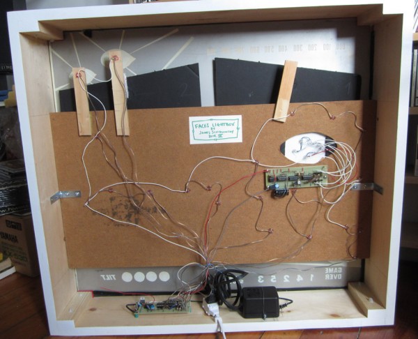

A friend of mine had this old pinball backglass lying around, and I had the idea of building a lightbox for it, with a circuit that would add a bit of animation to it.
Pinball machines from the 70s of course used incandescent lamps, but I managed to get away with 28 superbright white, 115-degree view angle flat top LEDs.
Apart from 18 LEDs just providing general illumination, there are 4 randomly blinking "little eyes", as well as a 6-LED speed-changing "big eye" chaser.
The speed of the big eye chaser was a cool little idea I worked out... the clock that drives a 4017 is a 4046 VCO, and then I have a 555 timer that switches it between 2 phases (via a 4053)... 1. charging a large capacitor (the VCO runs at the base speed), and 2. the VCO runs solely on the discharging cap's voltage, which starts out fast, and of course slows down as the voltage decreases. Each phase is around 35-40 seconds.
The little eyes blink driven by a 4-bit pseudo-random generator using a 4006 shift reg & 4070 XOR (a schematic I posted here: http://electro-music.com/forum/topic-52066.html). Unfortunately, sometimes when one plugs this box in, this circuit gets stuck in a zero state. I could never figure out how to get it to avoid doing that (without probably adding several chips). It's annoying because sometimes one can plug it, unplug it, re-plug it several times before it gets out of that state. When I make things for other people, I kinda want it to work without such hassles.
To add just a bit of extra randomness in the blinking speed, the clock that drives the pseudo-random generator is a 4046 with an antenna on the CV pin 9. So there's a base speed, but it can go slightly faster depending on what electromagnetic waves float by.
I acquired most of the knowledge for building this thing from hanging out on these e-m forums and building Lunetta stuff... thanks all!
DEMO VIDEO: https://vimeo.com/91720349

PHOBoS: Yes, TILT and any area that is not silver would light up if one puts a light behind it. In the "board" photo those black shapes are where I had to block light from coming through (like where there is plain glass through which one sees the score reels).

But... the circuit I'm talking about is a 4-bit generator, not a random clock... or would it work as that by taking some extra outs from pins off the shift register or the XOR?
James.

the 3 outputs I connected to the resistor ladder, + the digital output (pin 11) are 4 semi-random bits. Of course they are logically coupled so if you want
4 completely independent bits you'd have to make 4 of those semi random generators (or Linear Feedback Shift Registers as they are called).
I think the capacitor and resistor attached to the input of U2b should prevent stalling on startup, but that could only work if there is a clock present at
startup (right ?), however I always leave them in.

Switching the 4006 on with a delay wouldn't really help here because the problem is that when you apply power it will be in a random state.
If you look at this LFSR example on wikipedia you'll see that it's a shiftregister with several tap points that are connected to a couple of
XOR's with the final output connected back to the input.
If all the outputs would happen to be 0 on startup then it can't cycle any bits. If you compare it to the schematic I posted then U2b is an extra gate
since it's not connected to the shiftregister and once the capacitor is charged it will just function as an inverter. An inverter would take care of
the problem when all outputs are 0 on startup but I think it will probably create an other combination that could cause a problem (?). So by
changing the function of the gate over time it should always 'break out'. Rolling Eyes
So if you start it up but attach a CLk signal some time later (like in a modular setup) after the capacitor is already charged then it seems to
be useless. I suppose you could add an 'unlock' switch across the cap. although for this ligthbox it should work fine, and so far it has always
worked for me too (maybe random luck). Laughing

The thing breaks up into two groups .. one being the all zeros state, the other being all the other states .. it can not go from one group to the other by itself .. so once you have all zeros in the system it will stay there and once you have any non-zeros in it it will not get into the all zeros state.

Hmmm, well, the math and group theory is a little beyond me. But what worries me is what PHOBoS said about the shift register being in a random state upon powerup.
How do things that use shift regs ever work then? At powerup, the shift reg starts pumping out random stuff as soon as the clock is applied -- how can that be good? Or do they design circuits such that they cycle 0's in until it's "full", then connect it to the rest of the circuit?
But to return to the problem at hand, if we could ensure that a 1 is at the input of the shift reg at powerup somehow, the all-zero state would be avoided. But what's a simple way to do that?
I also toyed with the (crazy) idea of using a 4-input AND gate or something that would detect the all-zero condition, then somehow kick in a 1 at the input to get it out of that state.
Having a human-operated switch to unlock the state can work (which could be one that simply kicks in a 1 at the input), but it's not very elegant for my lightbox up on the wall, possibly not very accessible.
By the time one does stuff like that, it makes one wonder if it's not just easier using a microcontroller. A little PICAXE could probably do the trick, with a lot less wiring.

Yeah there are designs that detect the all zeros state and fix it.
And indeed I'd use a PIC 12 or something for this as well nowadays .. some PICs even have a hardware CRC generator that could be used for this.
Only drawback could be that it needs some time to start up .. but its both cheaper and easier to make, once you have the programmer/debugger.
That would be possible but most of the time you can just use the reset pin which the CD4006 sadly doesn't have Wink
An OR gate on the data input of the shiftregister with the second input connected to a capacitor/resistor to force a 1 on startup ?
hmm that would still give the same problem if you apply the CLK later of course. how about adding a circuit that forces a 1 on the
datainput on the first CLK transition. A 4017 could do it and it can probably be done with a flipflop aswell.
diodes on all outputs with a pullup resistor should do that, good idea. Very Happy
