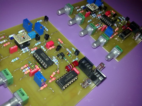

Just a picture of my project
It don't run yet , because i have many vérification , before, on the sequencer.

Sebo
Joined: Apr 27, 2007
Posts: 564
Location: Argentina
PostPosted: Sun Jun 08, 2014 4:32 pm    Post subject: Reply with quote  Mark this post and the followings unread
WOW, the sequencer looks awesome!!!

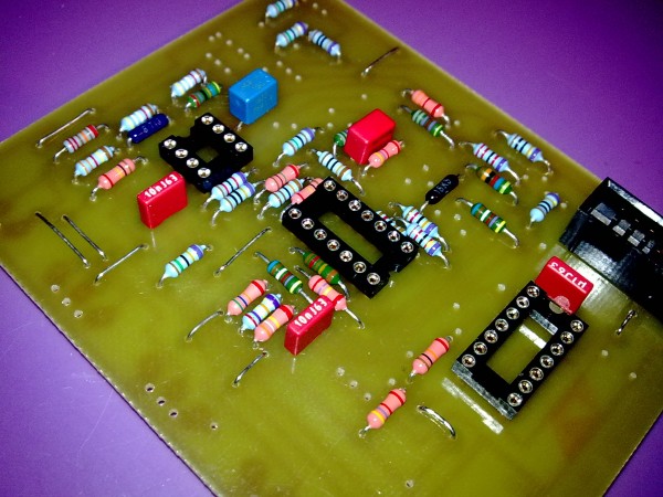

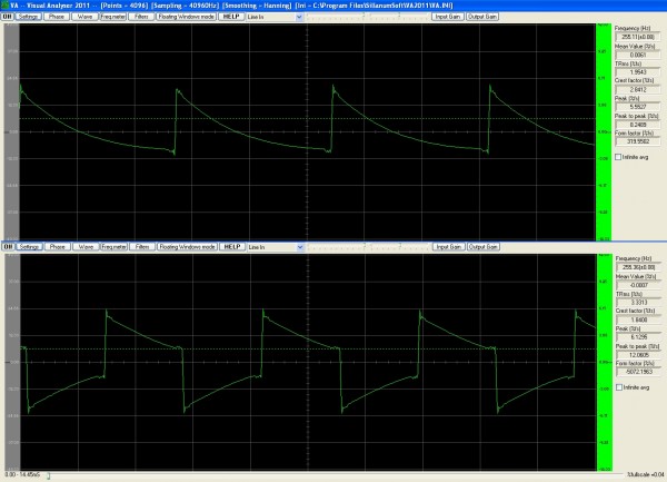

PostPosted: Sun Aug 17, 2014 4:33 am    Post subject: Reply with quote  Mark this post and the followings unread
Hello all. I've build several DIY synths and decided to build Odyssey using Dual Oscillator PCB.
First of all I want to thank Andy for his amazing work and dedication in this thread. Even with issues my oscs have, they sound really powerful and your work has helped a LOT to get where my project is now Smile
I've build VCOs, Yusynths Arp filter and Yusynths VCA. ADSR/AR circuits I build from original ARP schematics, same with Mixer section, LFO and S/H.
I was happy with the raw nature the instrument has, but always thought that square waves arent as clean as they seem in odyssey videos in youtube.
I don't have scope, but I checked both oscillators using visualanalyzer and it seems that squarewaves aren't right. Saw sounds nice and looks "ok" in analyzers screen. Squares seem to droop right after their edge has risen to peak voltage. Peak voltage doesn't stay up, instead droops before cycle starts its second half.
I'm running this on 12V and powersupply is checked and tested three times. Same goes with the PCB itself. I also tested changing 274k resistor that affects PWM but that didn't do the trick. My board sets squares dutycycle to 50/50 with original components, but squares shape is the issue.
I've used CA3146 instead of CA3086 and 2N5459's I replaced with 2N3823. All other components are like in original BOM.
If some one has any idea where to start looking solution, help would be awesome.

PostPosted: Mon Aug 18, 2014 10:31 am    Post subject: Reply with quote  Mark this post and the followings unread
The squares look like that because you are using a sound card to get the audio into the computer for analizing it. The sound card have a high pass filter to block DC, and that HP filter is deforming the waves.
If you use a real oscilloscope or get hold of a sound card without the high pass filters (there are a few of them, MOTU for example) you would see an almost perfect square.

PostPosted: Mon Aug 18, 2014 3:31 pm    Post subject: Reply with quote  Mark this post and the followings unread
The converters have nothing to do. The problem are the High Pass Filter that blocks the DC at the input of the sound card.
Just look at the waves with a proper oscilloscope and you will see the diference.
It's funny, this subject is popping out again and again. Software oscilloscopes aren't good for some tasks because the DC blocking filters of the sound cards. You can't measure DC offset (to calibrate a VCA for example), you can't properly see an LFO, and waveforms of VCO will be deformated, specially in lower frequencies...

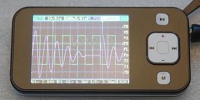

I agree with Sebo - I had a similar result using software. It wasn't until I bought a cheap Hitachi Scope, that I was able to monitor waveforms directly from the PCB... they were correct Wink
I'm now using a DSO201 updated with BenF's firmware (recommended). It may not be the most accurate scope out there, but it does the job well and I can take it anywhere.

PostPosted: Wed Aug 20, 2014 12:51 pm    Post subject: Reply with quote  Mark this post and the followings unread
Thanks guys for the help and info. What drow me to take a look more closely to the waveforms was an interference/sidenoise that could be heard on both oscillators. I thought that its a side product of wrong shaped wave. Like square mixed with little bit of saw wave. This side noise reacted to pitch so I thought it must have something to do with the shape of square wave.
Later I noticed that I forgot to solder in 10uf decoupling caps and when those didn't eliminate the issue, I added 100n caps to powerrails aswell.
Funny though, while I googled info about oddys square waves and known issues, I stumbled on this Very Happy
http://www.gearslutz.com/board/electronic-music-instruments-electronic-music-production/778218-arp-odyssey-wonky-square-waves.html
EDIT : Got it working.. problem was most embarrassing.. Oscillators sounded great when I tested those out from the synth, but when I installed PCB back in, side noise came back. I started to hook modules one by one to powersupply until sidenoise appeared. Problem was that my powersupplys caps were bit too small for the load all these modules take. I boosted in total more than 10000uf more to my PSU and now everything works great.
