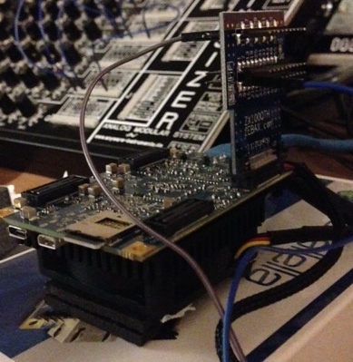

Well I have had one a couple of weeks, like most of these things it is a pain in the arse.
The epiphany processor is pretty quick as long as you keep everything in on core ram which is 32K per core. There is no hardware divide though so you need to keep away from divides.
The Arm dual core is also pretty quick.
Getting data from the arm ram to the epiphany core ram is extremely slow though.
The Zynq chip runs very hot, even with a large heatsink it was operating over it temp limits so I had to attach a 6" fan to it!
I managed to get some filter code running on the epiphany cores and set it up using network jack to send audio from my Mac to the arm over TCP/IP then piped into the epiphany for processing and then back again. The main speed issue is the R/W speed between the arm and epiphany though, with a 32 float buffer it takes around 1.5ms.
I ended up having to buy a expansion board to get at the GPIO pins from the fpga, those samtec connectors are mad. I did get some samples but there is no way I could solder them up, they are absolutely tiny.
The GPIO is very slow though running through Linux, about 70k. Also there is no SPI interface available, the Zynq SPI is disabled as all main pins are used so I am currently trying to get one built into the FPGA bitstream to replace some of the GPIOs.
Once I have an SPI module setup and have shoehorned it into the Linux kernel I might be able to get some of my DACs going......

The one I have is the 7020. You can also get a Parallella with the 7010.
I have included a pic showing the large heatsink, using this alone mine 'idles' at 80C, recommended max is 70C although the 7020 is rated at 75C.
With the fan running at 5V it brings it down to 56C.
This is running without the HDMI core on the FPGA, most of the FPGA is empty on the 7020 without HDMI.

That's a bit warm then. The Zybo uses the 7010, there's no heat sink on it. I wonder if all Parallellas run that hot...

Reports form the forum say the 7010s do as well, you basically need a heatsink and fan to use one.
Are you sure it is a 7010 in the Zybo as it seems strange that the parallellas runs this hot and the zybo doesn't!

ZYNQ XC7Z2010-1CLG400C is the full part number for the Zynq on the Zybo
http://www.digilentinc.com/Products/Detail.cfm?NavPath=2,400,1198&Prod=ZYBO
From the website: "The ZYBO (Zynq Board) is a feature-rich, ready-to-use, entry-level embedded software and digital circuit development platform built around the smallest member of the Xilinx Zynq-7000 family, the Z-7010."
The ARM cores run at 650 MHz. I've never run the PL with a clock faster than 125 MHz. The Zybo Zynq runs at a temperature that is barely above room temp.
If all of the boards do that, it's hard to believe that the mfr would release the product that way (running 10C over max temp). And you had to add a heatsink and fan! I'd would be good to hear from other users.

It comes with the heatsink. Everyone adds a fan though.
I will post on their site about it....

I can confirm my ZyBo (7010) pretty much runs at room temp, also.
In fact, I've done a lot of even large FPGAs (virtex-7) that are highly utilized, and they don't require a heatsink either.
I would bet the base config for the FPGA on the Parallela board is wrong, and the I/Os are burning through a ton a wasted power. The cores run at 1 volts or so, and it would take a lot of simultaneous switching, high clock rates, and a fast process corner to generate that much heat.

Well here is the reply I got when I asked why it runs so hot compared to the Zybo:
Because it's a small and densely populated board. My guess is that their board is bigger and possibly has a smaller BOM. If you take the ZedBoard, for example, it's much larger and has a fair bit of space around the Zynq.
