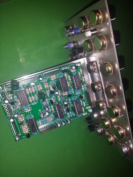

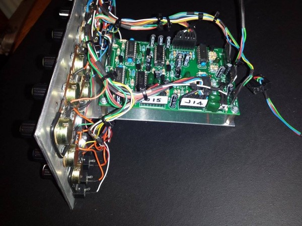

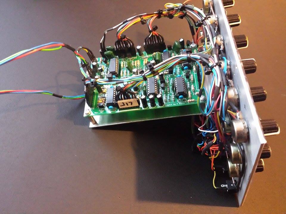

Decided to build another MPS after some one giving me a board so its going into my euro rack so far here a few pictures
| Description: |

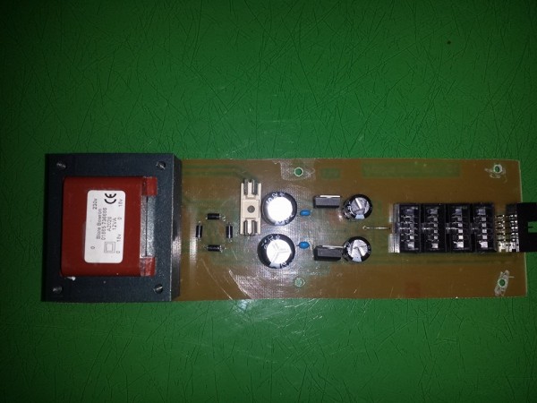

| P.S Installing a second power supply 15- ov 15+ for mps, Oakley little LFO,ETC |

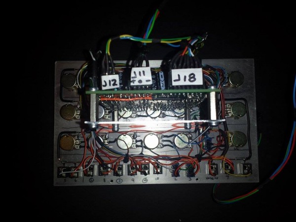

Additional power inputs question Subject description: MPS J12 and 19 unsure how to wire |
Hi there,
I'm about to embark on building a couple of these and I have a question about something I've not come across before that is a bit basic I think, but as it's concerned with something on the MPS boards I thought I would post it here.
Back on page 24 of this thread kkissinger has kindly made a list of the wiring on the board. It shows J11 as where the main power comes in from the power supply. J12 and J19 also are listed as bringing + and - V in. I'm unsure how this works. From looking briefly over the schematics I'm assuming these additional voltages would be 15v. Am I right in thinking that? Would there need to be separate connections from the PSU for these? Or are they something else and if so can anyone guide me towards some info on how to get everything set up power-wise? I have a +/-15V PSU with a distribution board assembled ready for this project. This issue is the only thing stopping me getting on with the soldering at present so any help would be much appreciated,
Thanks,
Jon |
Joined: Mar 20, 2012 Posts: 2179 Location: Chicago
Posted: Thu Apr 17, 2014 4:59 pm Post subject:
J11 is power in
J12 is power out to the various pots that need it.
Not sure what 19 was for, mine is in the basement and not convenient at the moment; I could check it out later if you need. |

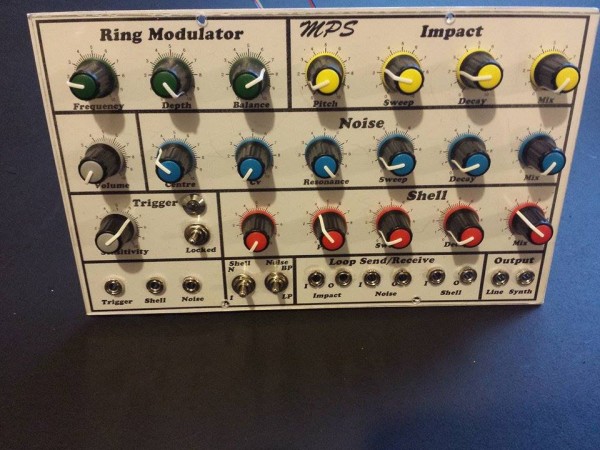

I would like to take full credit for this project but I cannot my friend wired the thing up and got it working I did make the front panel and drill the holes and solder the parts on the board with I guess some errors

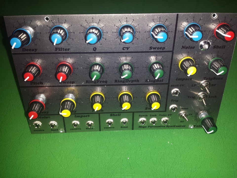

I just finished building a 2U MPS module. I was greatly influenced by sduck's design and tweaked it to fit my modular style. I bought the XR-2206 at Jameco and everything else at Mouser. I have photos and documentation on my MPS Module page http://modularsynthesis.com/electro-music/mps/th-mps.htm
Posted: Thu Nov 20, 2014 10:13 pm Post subject:
| I'm curious about the reasons for the modifications you listed.... |

I'm not sure who you are asking. If it is my modifications it is simply I bought a lot of 100K potentiometers so want to use them whenever possible. There were four 10Ks that were easy to change to 100K. The second mod is I didn't install the volume control but it is one half of the load on the output capacitor to bleed a charge off of it. I increased the load from 20K to 100K just because I wanted a higher DC resistance. The third mod is simply I wanted a manual trigger.
Dave |
Posted: Sun Nov 23, 2014 10:56 pm Post subject:
Yes, I was asking you . Some of us have had issues with low output levels, even on the "Synth" level output, and I was curious if anything you modified was perhaps to address that. Obviously not
Thanks Dave! |

| davebr wrote: | I just finished building a 2U MPS module. I was greatly influenced by sduck's design and tweaked it to fit my modular style. I bought the XR-2206 at Jameco and everything else at Mouser. I have photos and documentation on my MPS Module page http://modularsynthesis.com/electro-music/mps/th-mps.htm
looks bigger then 2u looks like full rack which is it 5u ?? you done a great job . I could be wrong on the XR-2206 I got a military spec part as some the other version have a problem which I been told its down to 15v they run better on 12v but then I could be wrong my friend wired the mps and the other one up I just made the boards which is the easy part. |
01012k7
Joined: Aug 31, 2013 Posts: 25 Location: England
davebr
Joined: Jun 09, 2007 Posts: 198 Location: portland, or
Posted: Mon Nov 24, 2014 2:16 am Post subject:
Re: Mega Percussive Synthesizer |
| 01012k7 wrote: | | looks bigger then 2u looks like full rack which is it 5u ?? you done a great job . I could be wrong on the XR-2206 I got a military spec part as some the other version have a problem which I been told its down to 15v they run better on 12v but then I could be wrong my friend wired the mps and the other one up I just made the boards which is the easy part. |
It is a 5U (height) module, but a 2U wide.

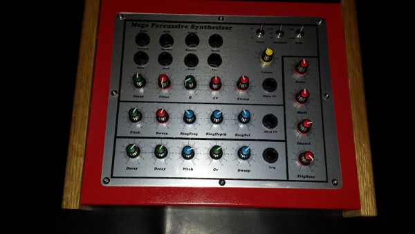

MPS with the new Barcode/Papernoise control panel |
I recently finished a couple of the latest generation MPSs. Thought I would post a link to my photos here for people who don't follow over on MW. The MPS modules work really well and are fairly easy and quick to build once you have all the components at hand.
http://pix.minirig.org.au/main.php?g2_itemId=7387
Wondering if any of the old hands here have any tips for playing? |
