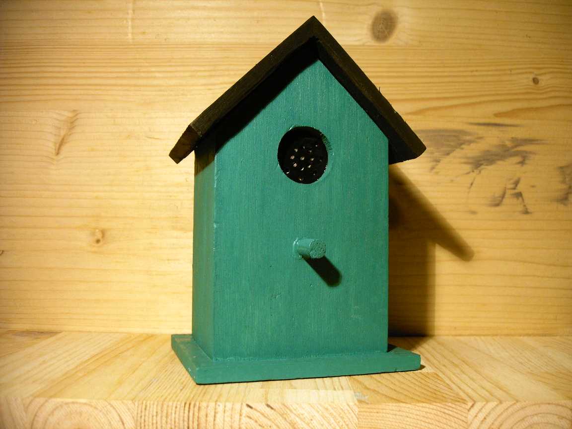

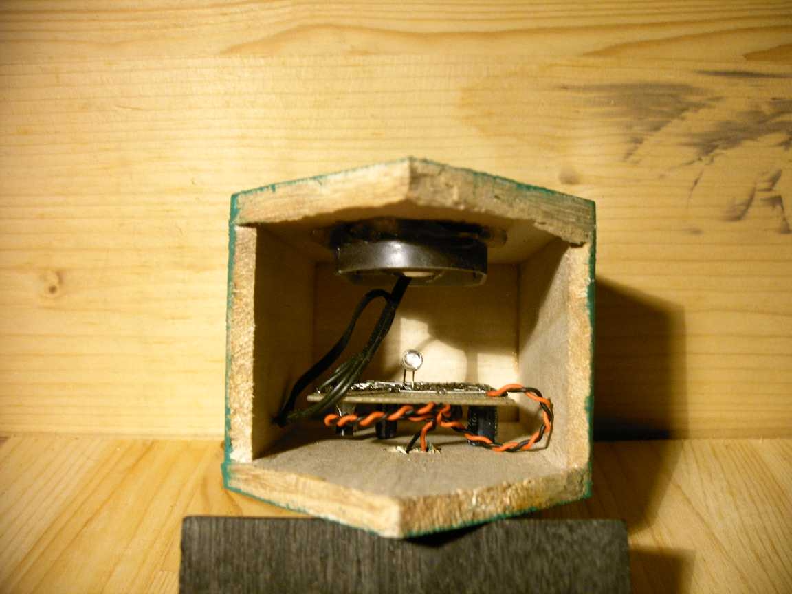

The circuit for this is based on Wilf's bird sound generator but I modified it a bit. The zenerdiode actually
got in there by accident, it got mixed up with the rest of my diodes and I only noticed it after I soldered
the circuit on perf and it didn't sound like the one on my breadboard (which had the zenerdiode).
I made it about 10 years years ago and than just had it laying around collecting dust. I did have the idea of putting
it in a bird house and a couple months ago I found a small cheap one. It was all glued together so I

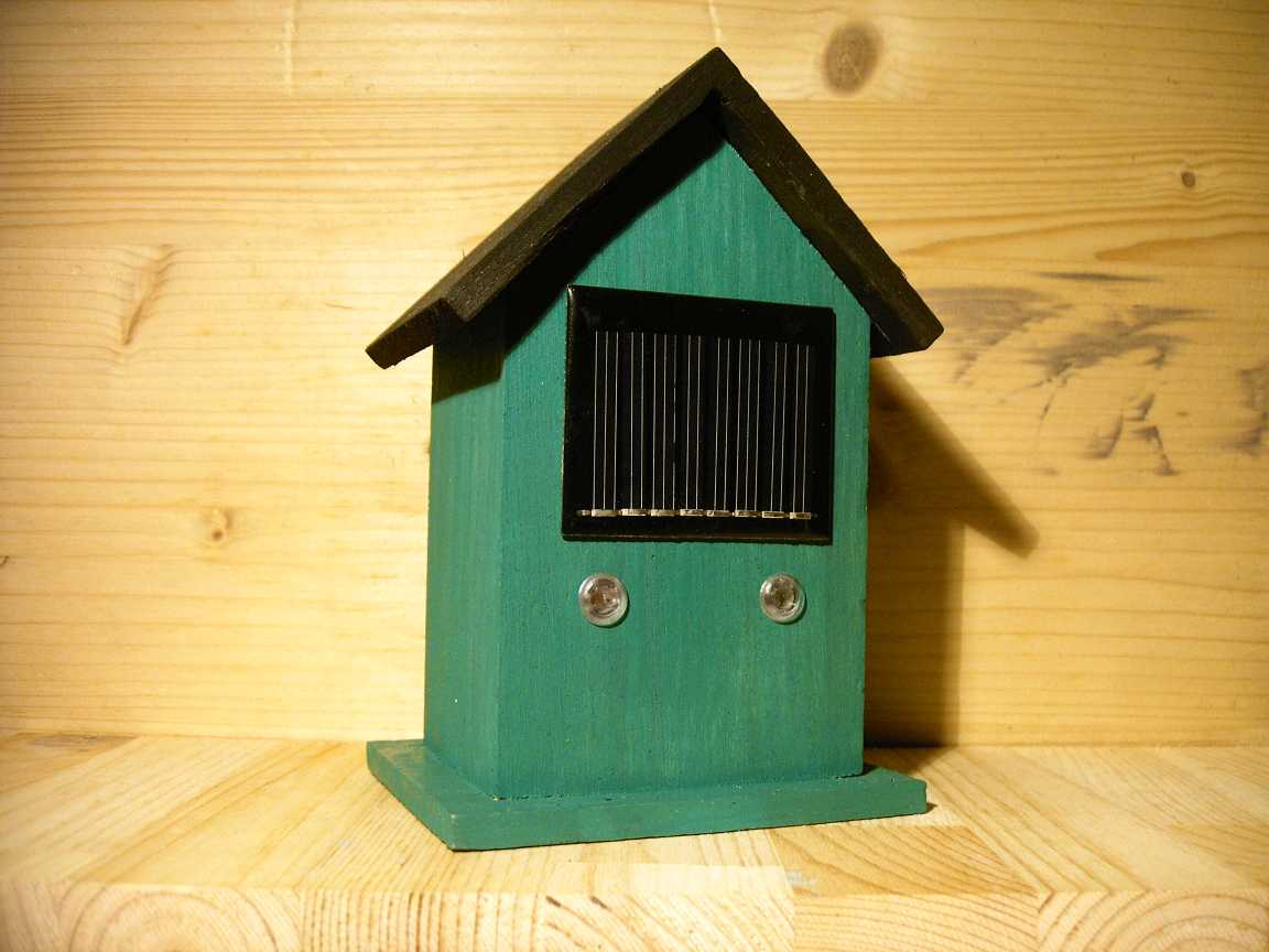

carefully had to cut the roof off so I could install the circuit. My initial idea was to put the solar panel on
the roof but since I will be using it inside in front of a window I decided to place it on the back together
with the LDR's. And then I finished it with some green and black paint.
