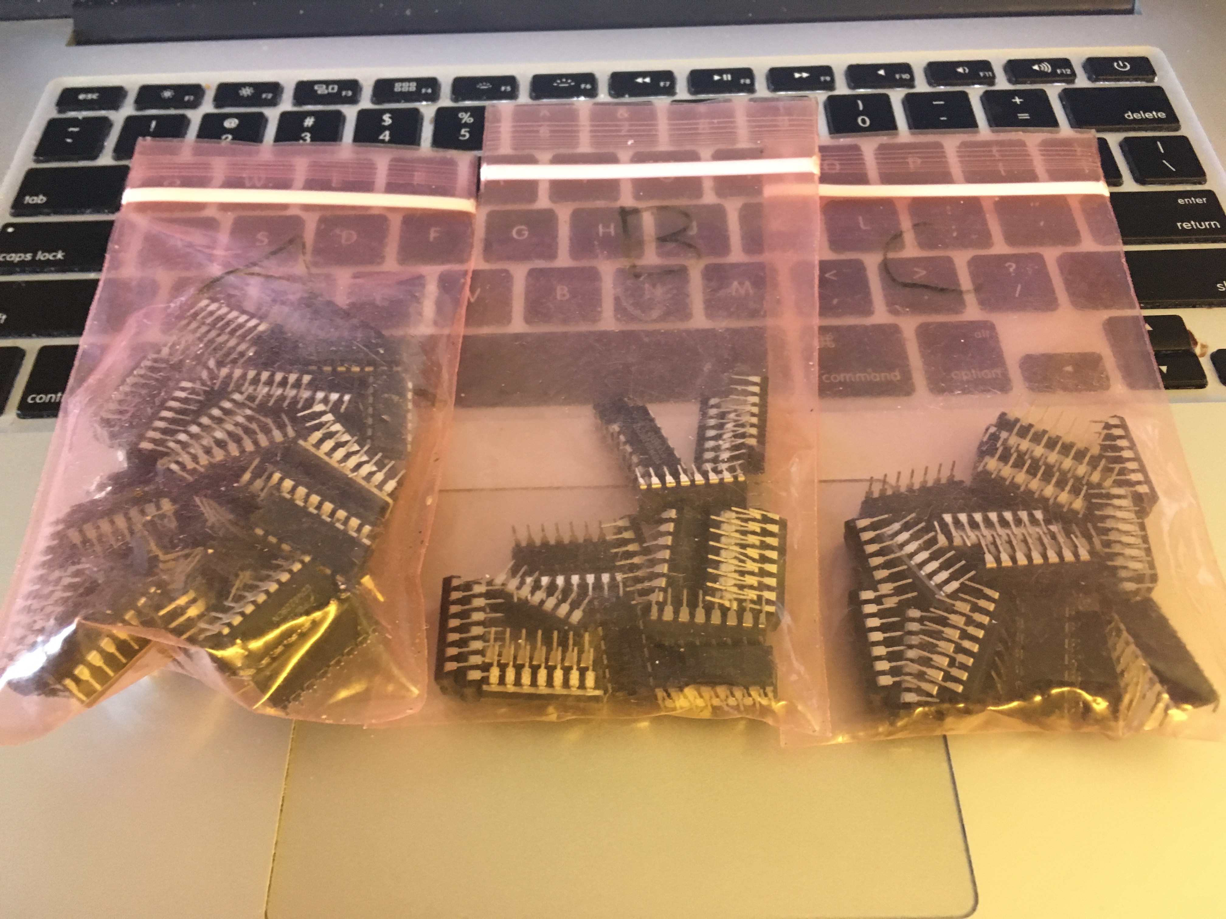

Have a look below at three bags of chips from an old Lunette "challenge", let's call it. Actually I don't remember if it was a competition or not. My plan is to use these chips and perhaps some others that I have in tubes on my desk to create some interesting (and small) Lunette circuit.
The first step is to make a model of a chip in OpenSCAD, my 3D printing CAD tool of choice. So out come the chips, out come the calipers, and away I go into my creative zone!

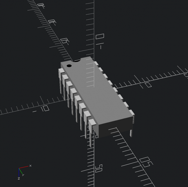

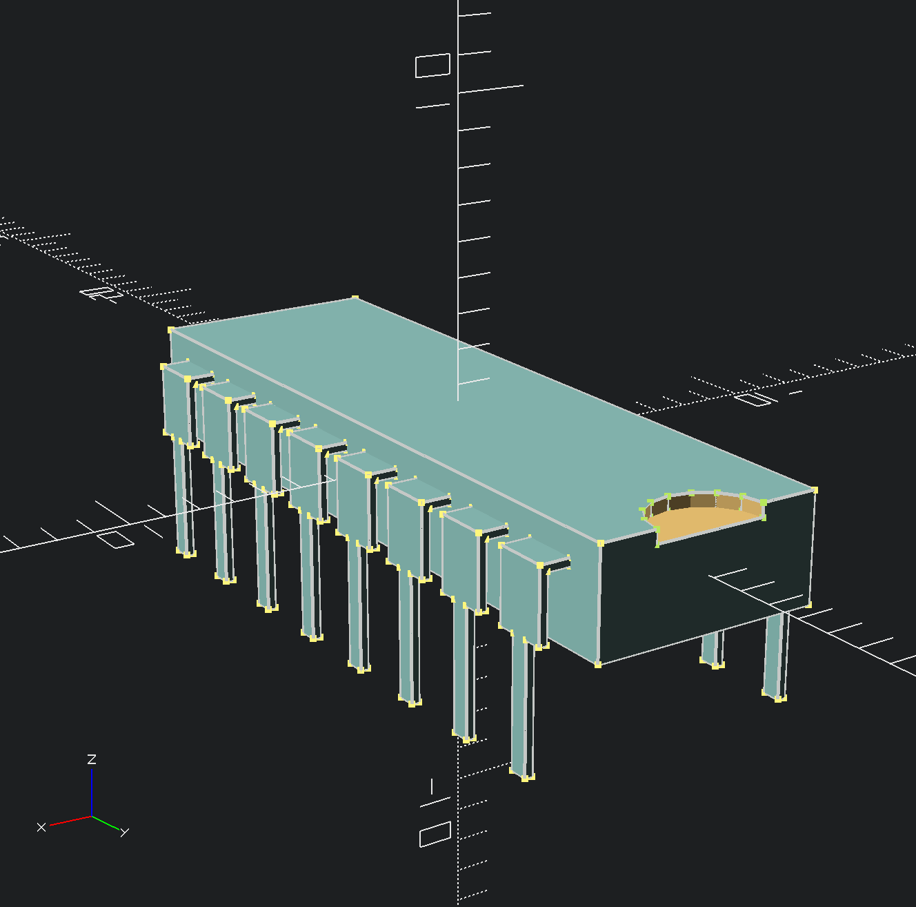

In the image below we have the Dual In-line Package (DIP) drawn out in OpenSCAD. I will use this model for test fitting into the conductive filament socket that will be an integral part of the circuit.
Les

deltamodulator
Joined: May 18, 2016
Posts: 91
Location: Texas, USA
PostPosted: Sun Oct 16, 2016 5:42 pm    Post subject: Reply with quote  Mark this post and the followings unread
There is something very therapeutic about modeling a chip!
Les
Chip Model in OpenSCAD
 Filesize:  28.18 KB
 Viewed:  514 Time(s)

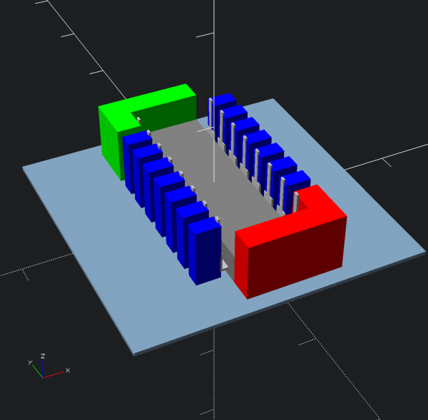

this is my concept for a socket. The iC is inserted upside down (legs up, or dead bug position as it is called). The tabs all grip the legs, supposedly.
The conductive base plate is obviously less than 10 times thinner than the conducting traces.

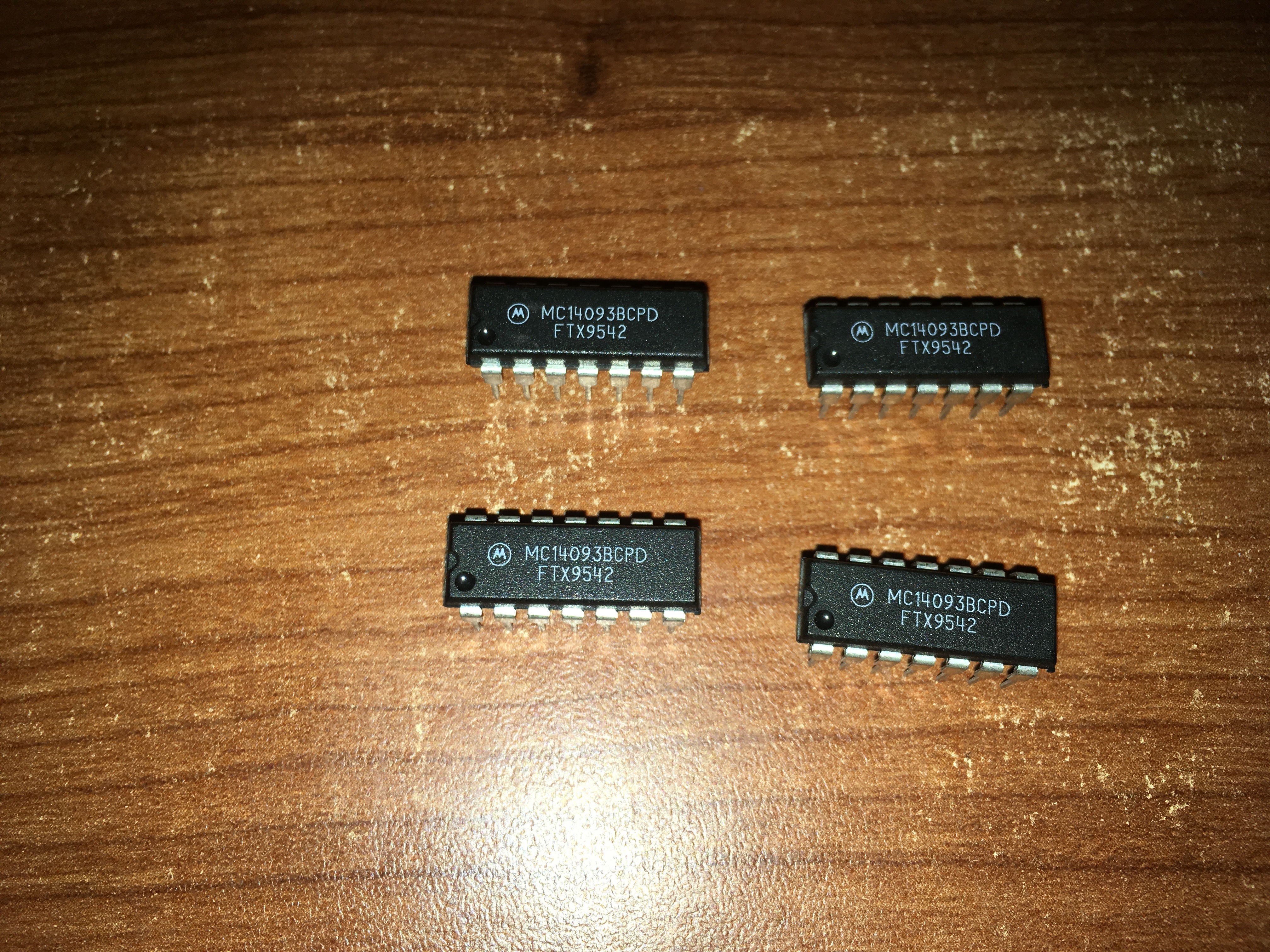

I decided to attempt a single-chip design for simplicity's sake. KISS of course. So I managed to find four 4093 CMOS chips, which have four quad Schmitt trigger NAND gates each in the first bag where I looked. Nice!

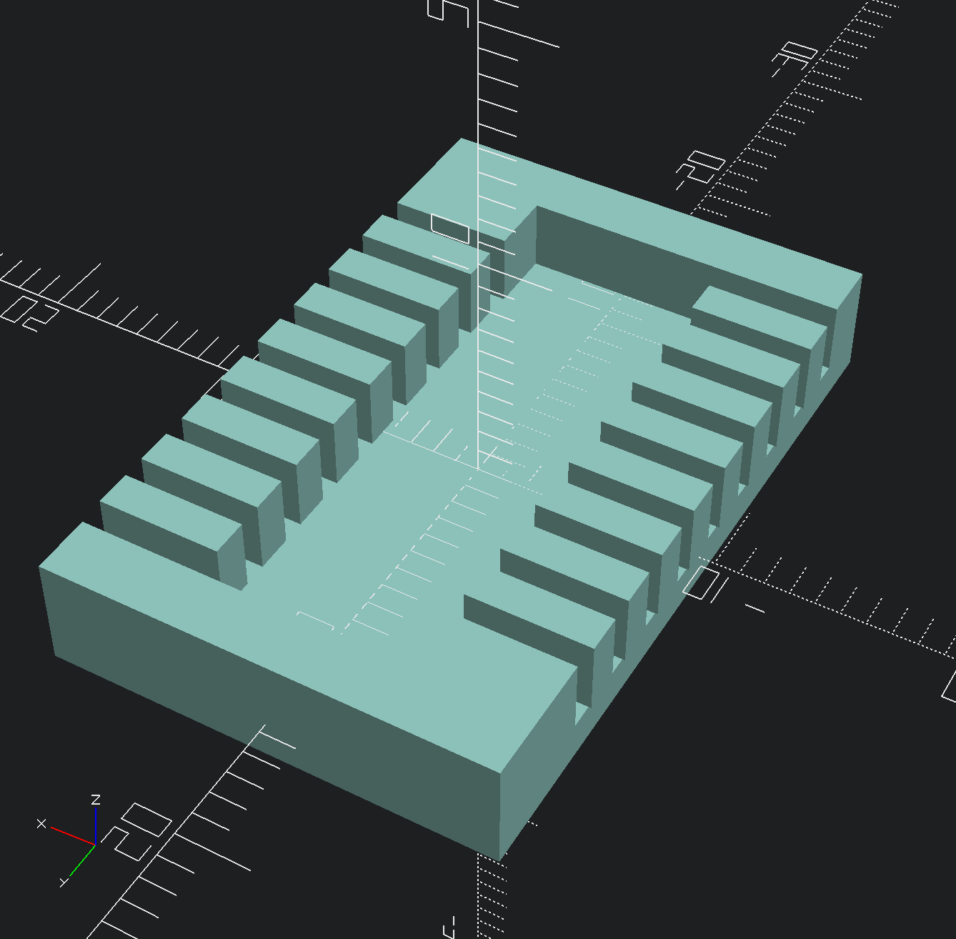

So I was trying to think of ways to connect the Schmitt trigger NAND gates together, and ways to combine the geometric with the schematic. Then it occurred to me - I wonder if I just thickened the back, then all the pins would be shorted by resistance, however the adjacent pins would have much lower resistance than those far away... what would it do?
Then I addressed the problem of how to hook up power and capacitor leads and I realized i could use the pins themselves in a breadboard.
So the resulting thing forms a "backpack" of volumetric resistance. The next thing to do is to draw some form of schematic and possibly decide where if anywhere to change thicknesses, widths, and/or make cuts in the volumetric resistance so that oscillation works better. i can also fire up the printer and print one to see what the resistances actually are.
So that's my progress report for this morning!

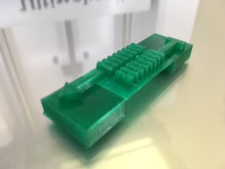

Here is the latest test. Notice the long bridge in the middle - the Ultimaker printers do welll with this among other capabilities.
