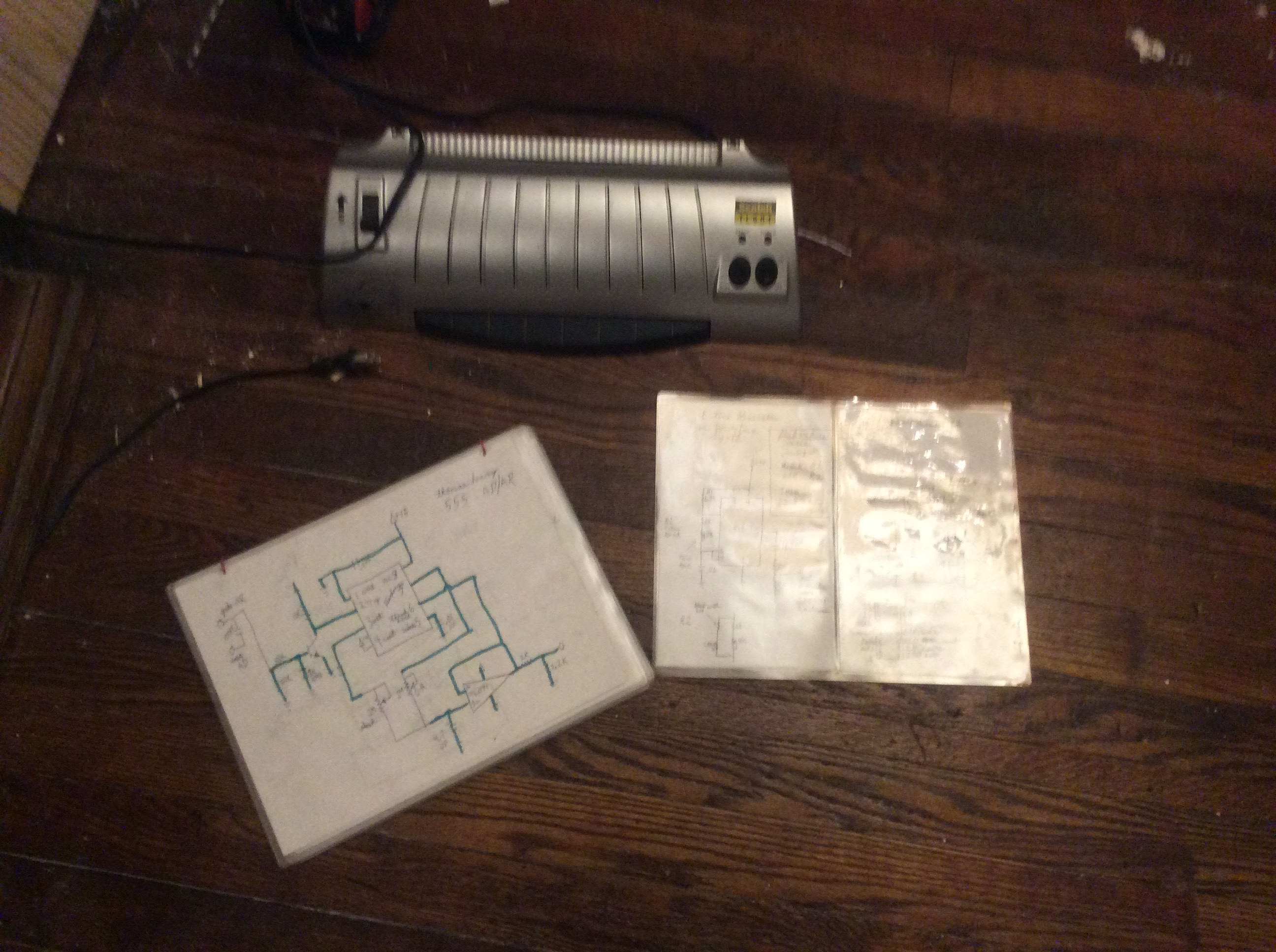

I would like to start a thread that gives useful tips about how to do anything that has to do with DIY builds. Topics can be anything you have come up with to make your builds easier, more understandable, pretty much what ever you may think could help others in the DIY world.
(Example). I like to laminate my schematics so I can use a dry erase marker to mark as I build, then wipe it off, use a hole punch and make my schematic book to my own synth.
I'm sure you all have better tricks and ideas. Let's hear them.

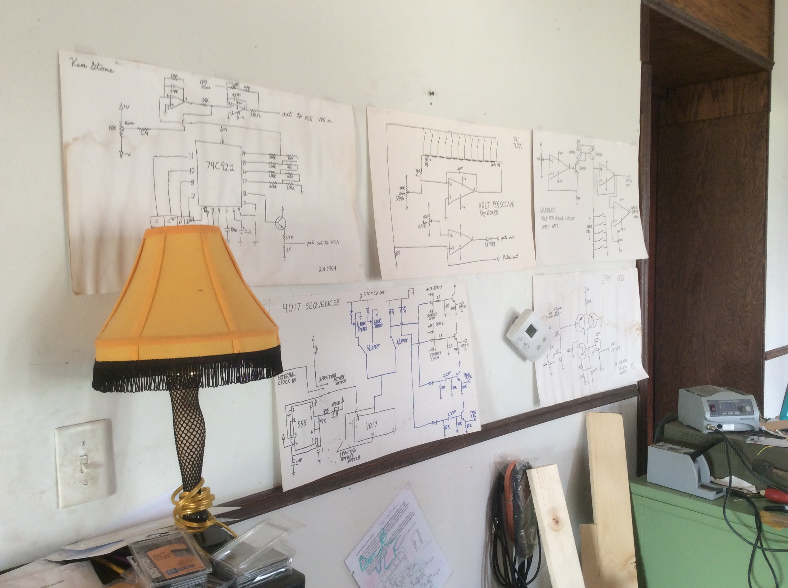

If you work 80 hours a week long enough to drive your wife in to the arms of anouther woman, you can then tape large drawn schematics to the walls that allow you to work without reeding glasses.

nice lamp Laughing
all my walls are covered with components, boxes with stuff or synths so I don't have any room for schematics Rolling Eyes

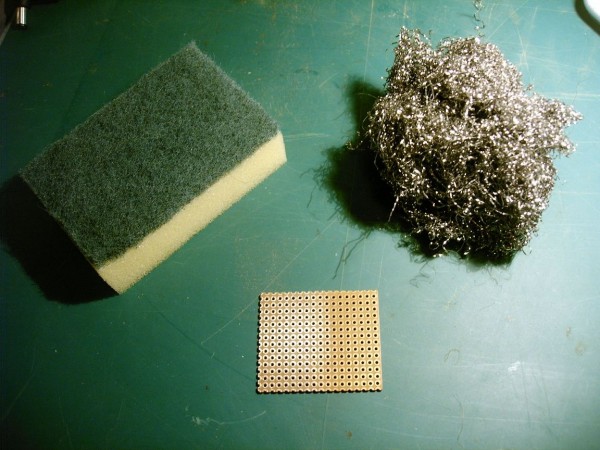

cleaning perf before soldering works great with a scouring pad (see photo), it also works if you etch your own PCBs but I wouldn't
use it on a PCB with a soldermask. It is also very useful to remove any burrs from cutting a track (stripboard) or drilling holes.
scouring pads. The metal one has been used a lot but still works fine.
left side of the perfboard has been cleaned to remove any oxidation.

With respect to steelwool shown above, I use very fine steelwool (0000?) To clean pcbs and the tip of my soldering iron. It is very soft, so it doesn't damage anything.
One major point of concern is TO NOT LET IT TOUCH A BATTERY!
I have spare batteries and other stuff around, and it happened to me twice that I absentmindedly put my steelwool somewhere, and immediately thought "wait there was also a battery in that bin".
It glows very hot upon contact with a battery, and will start a fire easily (survival tip).

I used to play around with steelwool in a jar and a car battery, gives a great effect Twisted Evil
what you see in the photo is actually one of these:
it just has been used a lot so it lost its shape.
I guess regular steelwool will work but might not be the best idea for stripboard
because strands can easily break off and cause shorts between tracks.

I know, "RVS pannenspons" Smile ,but that's too coarse for my use. Also use the finer stuff to prepare PCB's for toner transfer.

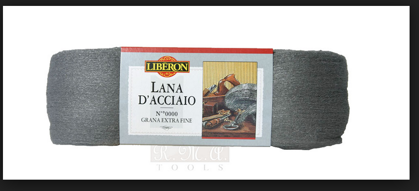

as for steel wool,
to remove the oxide off the perboard ive been told to use this.it does a fine job

Yeah, that's the stuff I use.

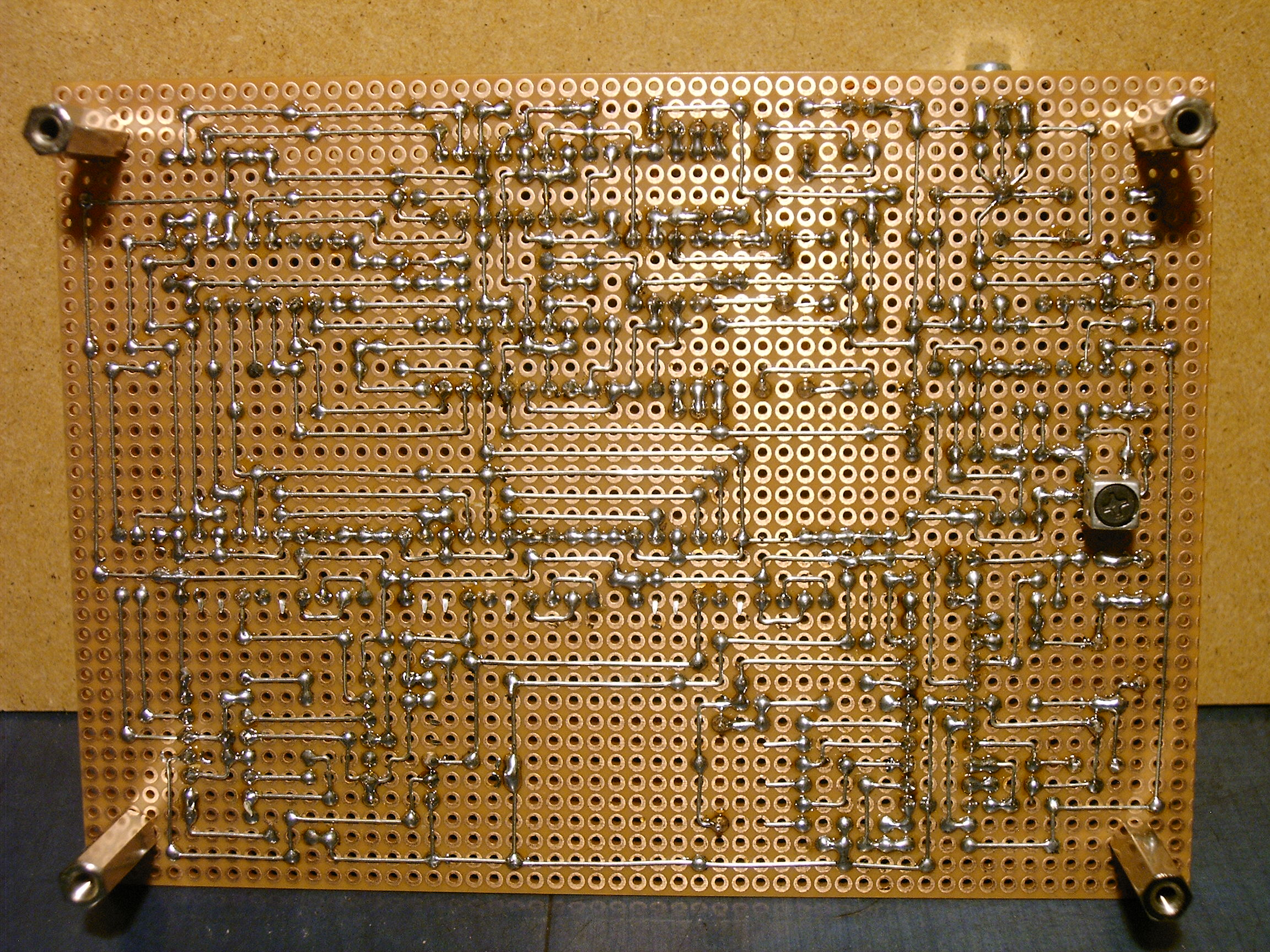

There are several methods for soldering to perf. They way I do it is a first design a layout on a 0.1" grid using an older (free) version of Sprint-Layout.
I then use the component leads to create this layout by bending them. And if I need some extra wire I use stripped CAT-5 cable or some cut off leads.

thanks Phobos,
i know there are so many ways to get it right, although the majority of engineers seems to prefer the way you described. Smile
Your job depicted in that picture is spot on.Absolutely came together! clean and tidy, i will draw some inspiration from that wow!

just one question, how do you call in english those four things towards the corners of the perfboard that serve to screw and tighten the perfboard itself onto?I am planning to get a bunch of them to fix my modules onto pine wood panels! cheers! Wink

"Standoff" usually M3 threaded, at least, this side of the pond.
You can get them with female thread on both sides an one male one female end.
I recently bought a great bunch of them at either dx.com or banggood.com for little money, in various lengths.

pcb "spacers" is another term used.
I ordered black nylon ones from ebay a couple times here
