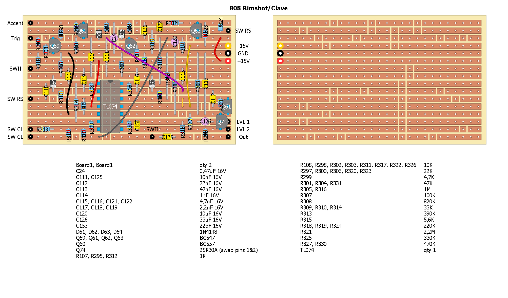

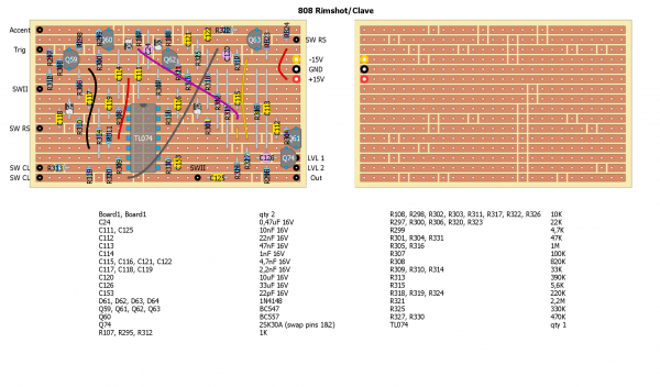

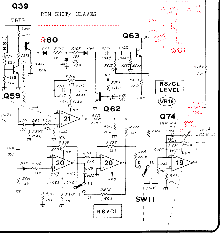

I've done a stripboard version of the Rimshot/Clave, it worked like a charm at first attempt.
At first attempt i didn't incorporate the red section, it's a muting circuit that allows signal to pass through the opamp only when triggered, it looked optionnal at first, no signal leaking hearable, but when i put the rimshot through an overdrive we could easily hear the noise source. Now i guess that's the utility of the muting circuit, that is not necessary in other voices.
So if you don't have 2SK30A or equivalent you can omit this part (with Q61, C112, C113, R305 and R327), it won't be problematic until you pass your rim through an overdrive.
Here's a short video clip with the rimshot/clave breadboarded. Now the clap and i'm complete !
https://youtu.be/TLfwnosA9js

PostPosted: Sun Oct 30, 2016 11:08 am    Post subject: Reply with quote  Mark this post and the followings unread
So black is ground and yellow is -V?
lysergist
Joined: Jan 14, 2016
Posts: 36
PostPosted: Sun Oct 30, 2016 11:09 am    Post subject: Reply with quote  Mark this post and the followings unread
Yes, edited. The components are labelled the same as the original Roland schematics to make it more readable. It's very fresh, i hope there's no huge mistake. I'll test it tomorrow.

PostPosted: Wed Nov 02, 2016 9:51 am    Post subject: Reply with quote  Mark this post and the followings unread
"Normally conducting Q74 remains off only while trigger pulse is transferred from Q61 to allow IC 19 to pass signals. The switching is is provided to eliminate noise leaking from IC20 especially for CL - relatively large amount, being wired for high Q."
Ok so this part is not significant and could be easily deleted. I try the stripboard as soon as possible. I've edited the first post, there's a little video clip with the breadboarded rimshot

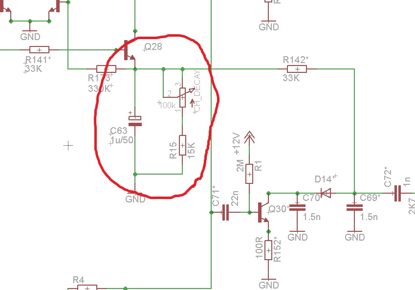

Hi folks! I wonder if anyone tried to implement the closed hat decay mod?

PostPosted: Sun Nov 06, 2016 9:53 am    Post subject: Reply with quote  Mark this post and the followings unread
Closed hat decay ? Never seen this mod. By definition the closed hat becomes an open hat if you increases the decay. Do you want your closed hat being an open hat ?
There are some mods here you can check
http://www.e-licktronic.com/forum/viewtopic.php?f=18&t=143

Thank you! It seems I heard something about this mod before, but now I can not find any mention. Maybe it was about tr-606.
I'm not seeking similarity with original tr-808, I just want to animate CH within the range from very short click to the shortest OH decay without the lose of specific 'choking'. I increased capacity of C63, the discharge cap of envelope-forming Q28, added 100k pot connected to the gnd via 15k resistor in parallel with C63 (see pic). R15 sets the minimum length of decay, capacitance of C63 determines the maximum duration. Value of the pot sets the range of control.

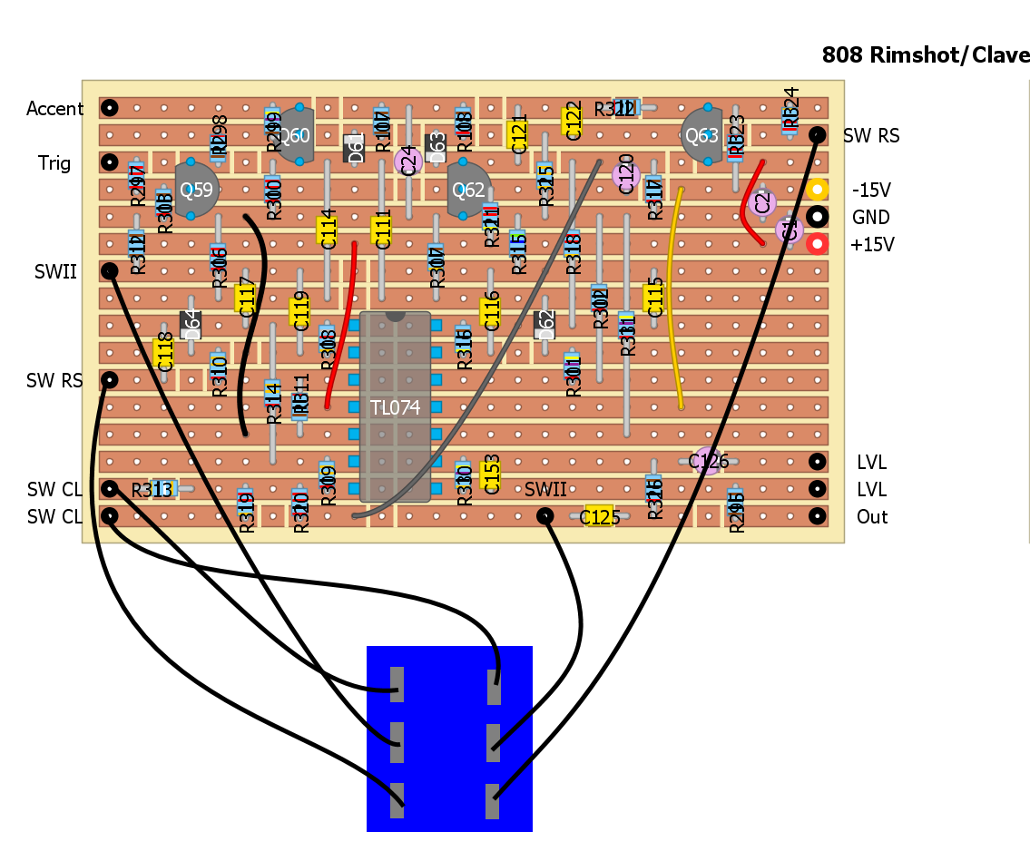

Do you happen to have a wiring diagram for the switch?

PostPosted: Wed Dec 14, 2016 5:52 am    Post subject: Reply with quote  Mark this post and the followings unread
Hope it's clear, i don't really know all types of switches names, but i can say it's a ON-ON switch. I always test it before soldering.
There's just a little gap of around 1sec when switching from clave to rimshot, i don't know why. I guess this 1 sec latency comes from a charging capacitor. I never tested a true 808 so i can't tell if it's a normal behaviour or not. No latency while switching from rimshot to clave.
Thank you so much for this! Switch type is DPDT

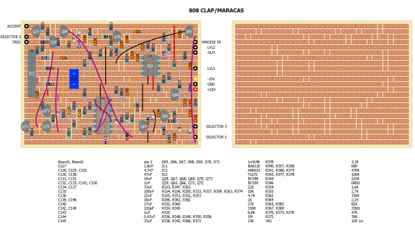

PostPosted: Fri Mar 24, 2017 1:19 pm    Post subject: Reply with quote  Mark this post and the followings unread
Ok i finished the clap ! Sounds really nice to me. All transistors are BC547/557, i used 2CS945 and 2SA733, but there's no difference in the sound. I used cheap BA6110 i've found on ebay, and they work properly !
Maybe i'll make another version with the CA3080, but a NPN/PNP buffer needs to be added. I have also added two mods, replace R376 (47K) by a 100k pot to control the noise reverb amount, and replace the trimmer by a 10k potentiometer.
EDIT: thanks Peppy for noticing C144 was mounted the wrong way, the layout has been edited

PostPosted: Tue Apr 11, 2017 8:30 pm    Post subject: Reply with quote  Mark this post and the followings unread
So.... I think R368 in your diagram is connected to the wrong side of Q73?
And there are two D68's.... the lower one near Q73 ought to be D70 I believe.
