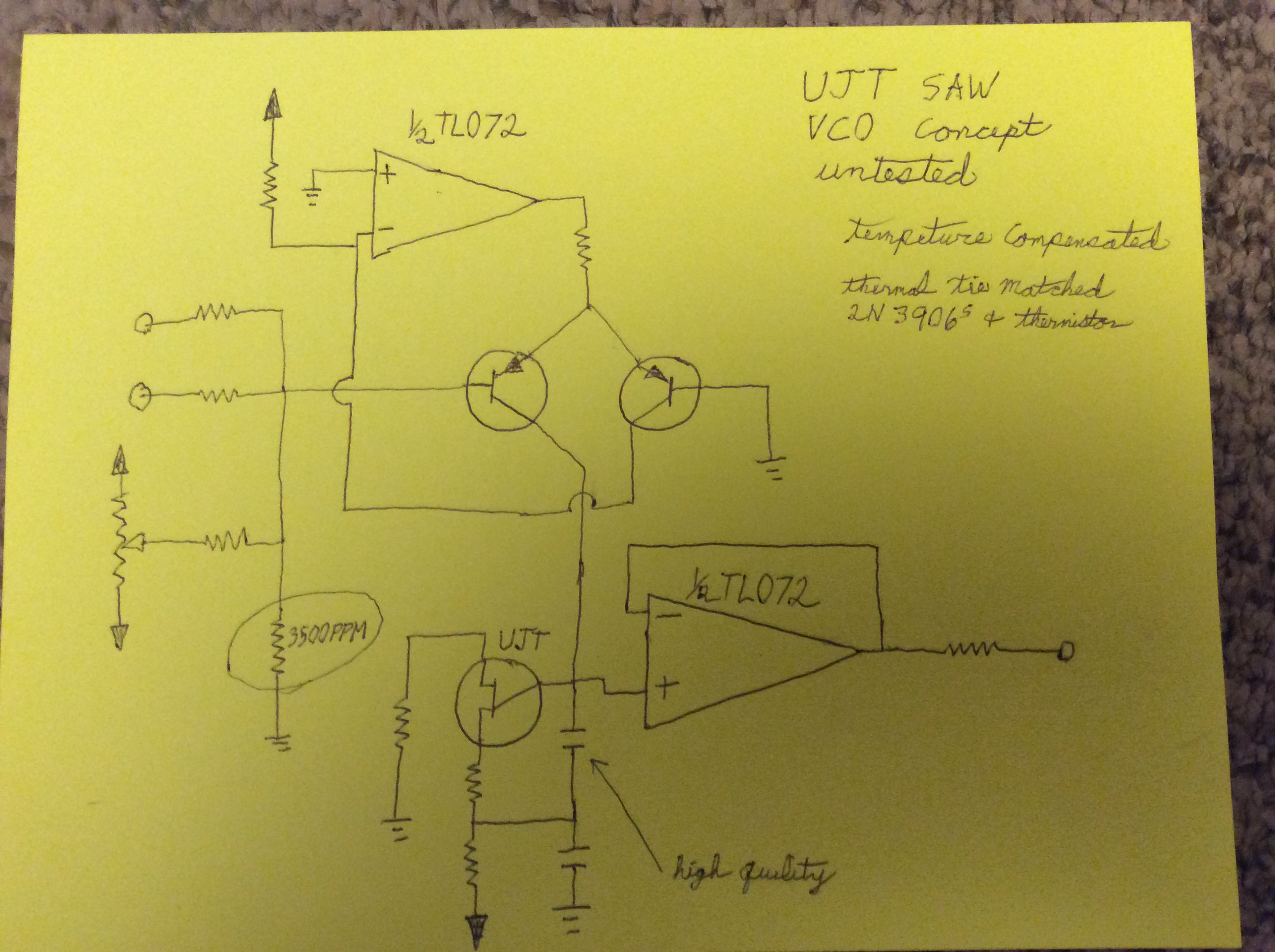

I have always wanted to see if I could make the best VCO possible from a UJT saw core.
This is just concept and needs work. But temperature compensation, and the use of the opamp in place of the single FET to minimize interference,
were things I always wanted to try.
Still needs volt per octave adjustment, and some thought put to some resistor values
If you ask why???
I have always had a soft spot in my heart for the UJT.
My first early sound projects were built around it.
If anyone sees obvious problems, please let me know.

Could switch to a TL074
Ad a comparator and get PWM with the extra 2 opamps.
Never tried PWM from a saw wave.
I can't think of a reason that it wouldn't work ok. Shifting the comparator reference voltage would change the puls width.
???????? Any thoughts anyone??????
I like the simple EFM version, but it has a lot of limitations
I have never seen anyone use a UJT core on a VCO of any quality.
May be a good reason for that. May not.

So I commented earlier about not seeing a vco schematic with good temperature compensation using a UJT core.
Turns out there is a guy over on muffs working on one too.
LOL what's the odds of 2 guys trying to perfect a vco using outdated UJT transistors at the same time?
I don't feel so alone in the world.

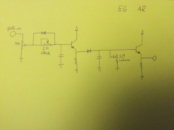

So we got a functional envelope generator up and running that fits the current project profile.
Is about as simple as it gets.
I'm sure someone has done it this way before, but I have never seen it.
Will fill in final values once I'm done fine tuning.
