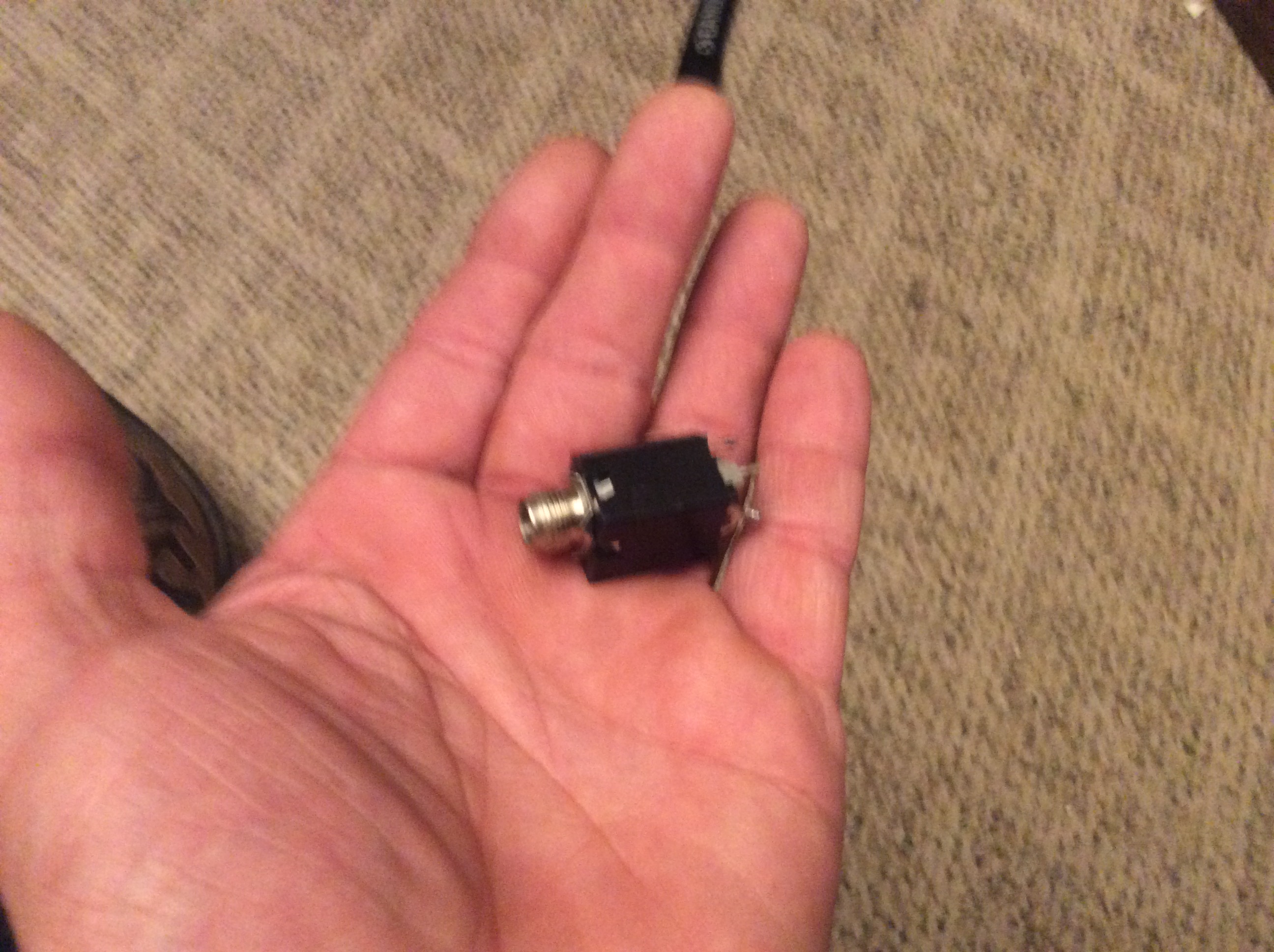

PostPosted: Sat Feb 04, 2017 8:11 pm    Post subject: Reply with quote  Mark this post and the followings unread
If it's only 4 wires, 2 contacts. They make 1/4 inch jacks that close a switch when the male jack is pulled out.
I think they are called normalized jacks
You would need 1 jack for each switch. But if it's only 2 you need. That's not too bad.
I'm sure they make them in 1/8 inch too.
Ones I bought recently look like this
 Filesize:  895.17 KB
 Viewed:  558 Time(s)

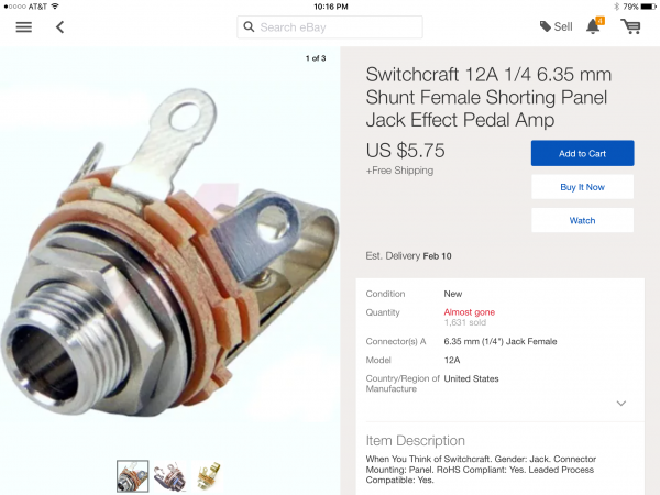

PostPosted: Sat Feb 04, 2017 8:19 pm    Post subject: Reply with quote  Mark this post and the followings unread
Found one on eBay and took a screenshot

Posts: 5868
PostPosted: Sun Feb 05, 2017 4:51 am    Post subject: Reply with quote  Mark this post and the followings unread
It desn't matter if the post is from october, even if it would be a couple years old it is still interesting.
Usually for something where you want a closed connection when nothing is plugged in I would indeed use jacks with a switch contact,
but with so many wires that's a lot of cables to connect it to the box. I would not use the type you posted from ebay btw. Even though
those are Switchcraft and probably good quality (pretty expensive too) I don't have a good experience with switch contacts on those
open kind of sockets. The closed ones which you posted a picture of usually work a lot better and I personally use the Neutrik NYS216
or similar which have never failed me.
