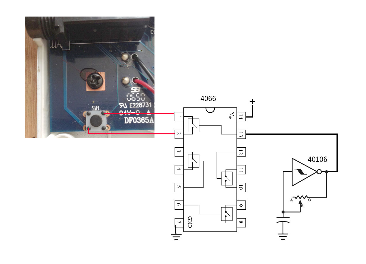

PostPosted: Sat Mar 25, 2017 9:51 pm    Post subject: Reply with quote  Mark this post and the followings unread
Hi Again,
So I've wired this up, (see attachment) using a Schmitt trigger>4066>pedal button.
The pedal is being triggered, but at a really high frequency which I can't control with the oscillator.
Am I approaching the 4066 wrong? Maybe I need to desolder the pedal button.
Thanks

PostPosted: Sun Mar 26, 2017 5:20 am    Post subject: Reply with quote  Mark this post and the followings unread
That looks correct.
"high frequency" triggering would have me believe that the 40106 oscillator is running at a high frequency. Do you have a scope so that you can check that? You don't show any values for C and R for the oscillator - that's important since those two components determine the frequency of the oscillator.
Is there any chance you have a schematic for the pedal?

PostPosted: Mon Mar 27, 2017 7:14 am    Post subject: Reply with quote  Mark this post and the followings unread
Got it switching! Woo!
I think because of the type of pedal button, it needed two oscillators from the 40106. Got the idea from Hackaday http://hackaday.com/2015/08/07/logic-noise-4046-voltage-controlled-oscillator-part-one/#more-163851
Thanks for the help and suggestions.
