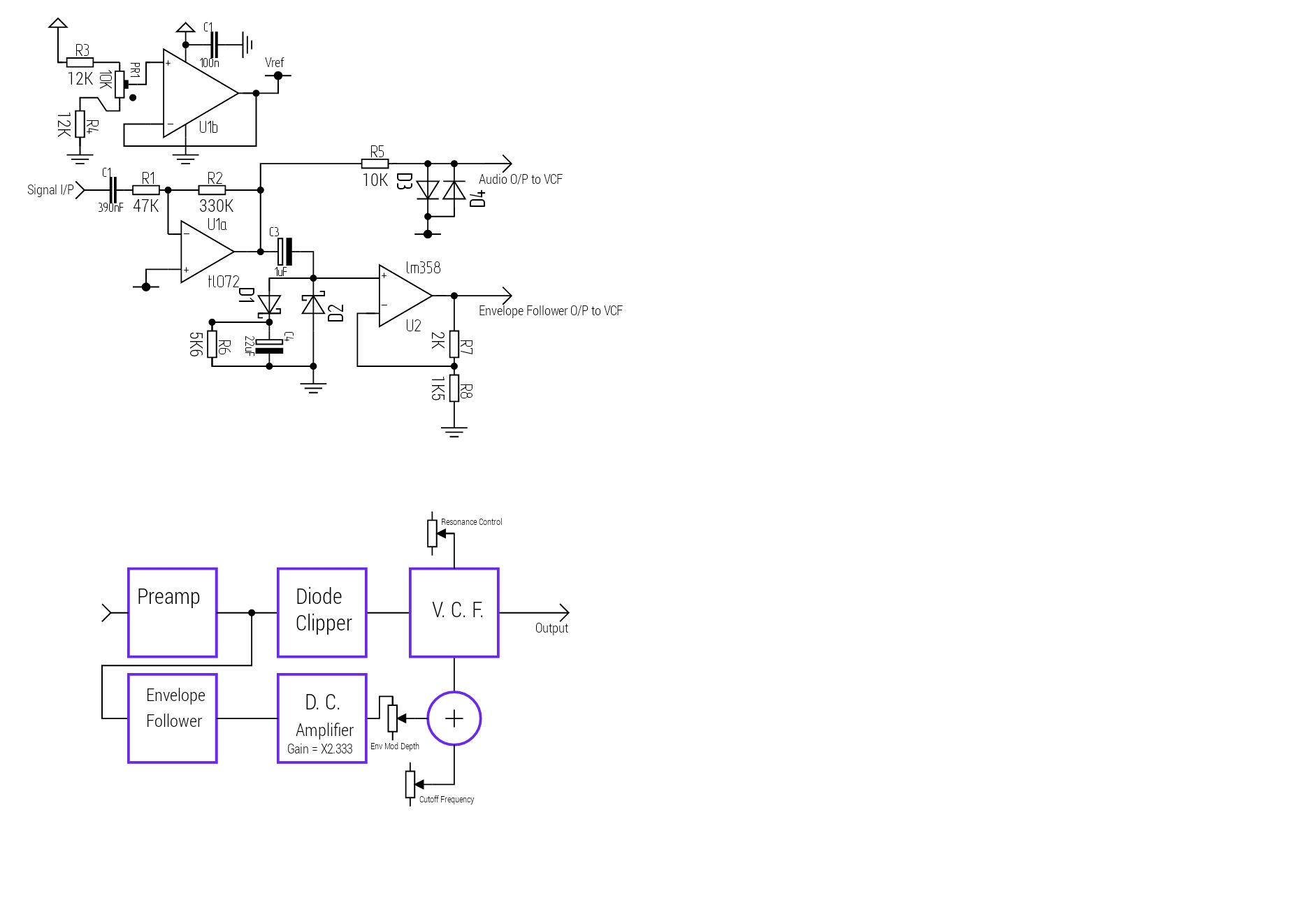

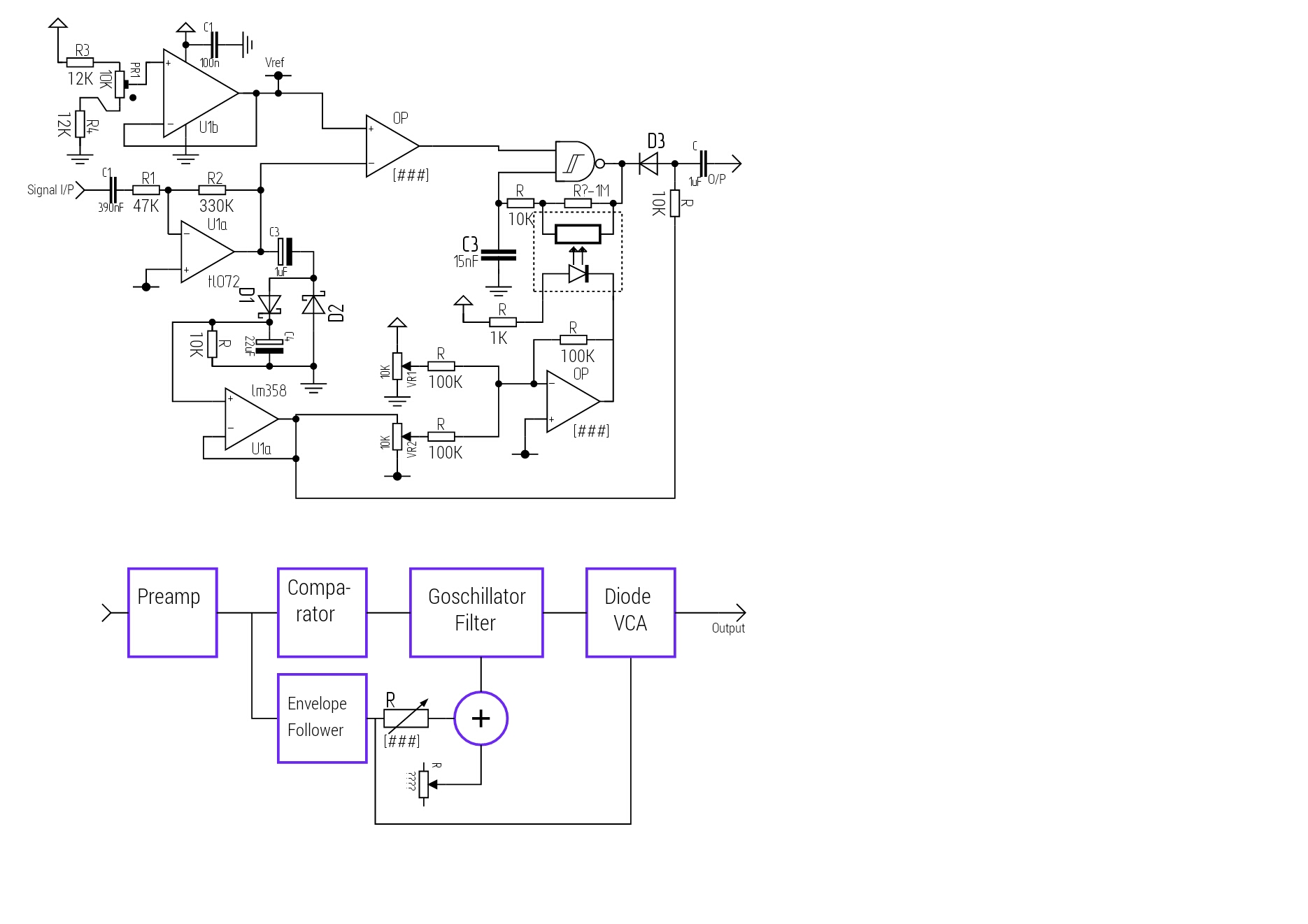

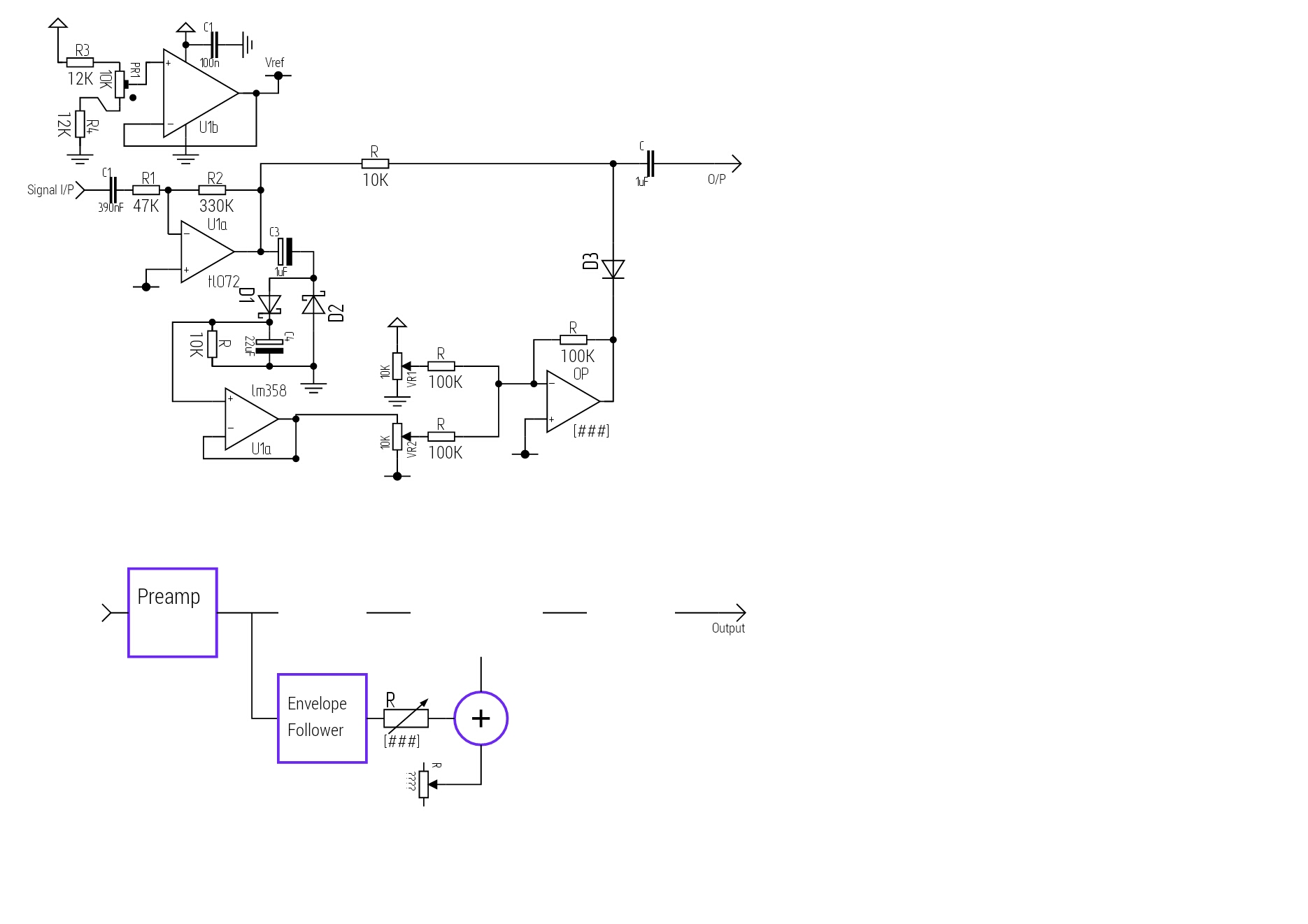

It's actually not bad for a toy. However I did think that it could be improved upon. So far the following circuits have only been breadboarded, but they do work.
First up, Goschillator filter circuit. .
Modulated clipper circuit.
PWM circuit

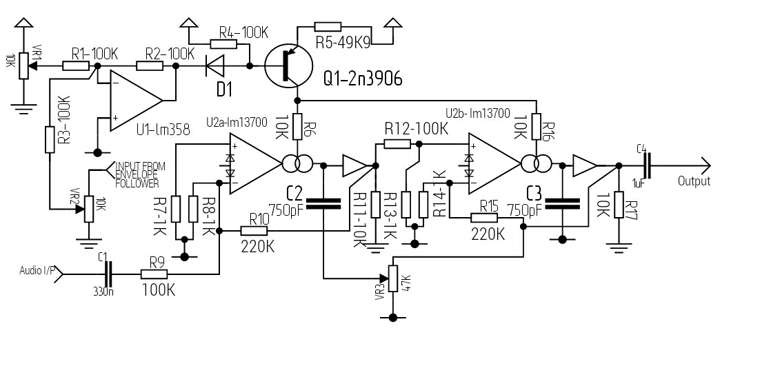

I tried the following VCF in conjunction with the envelope follower circuit in the other circuits

This is the support circuitry for the above VCF, thought I should post it as there were some variations from the original posted circuits in my first post.

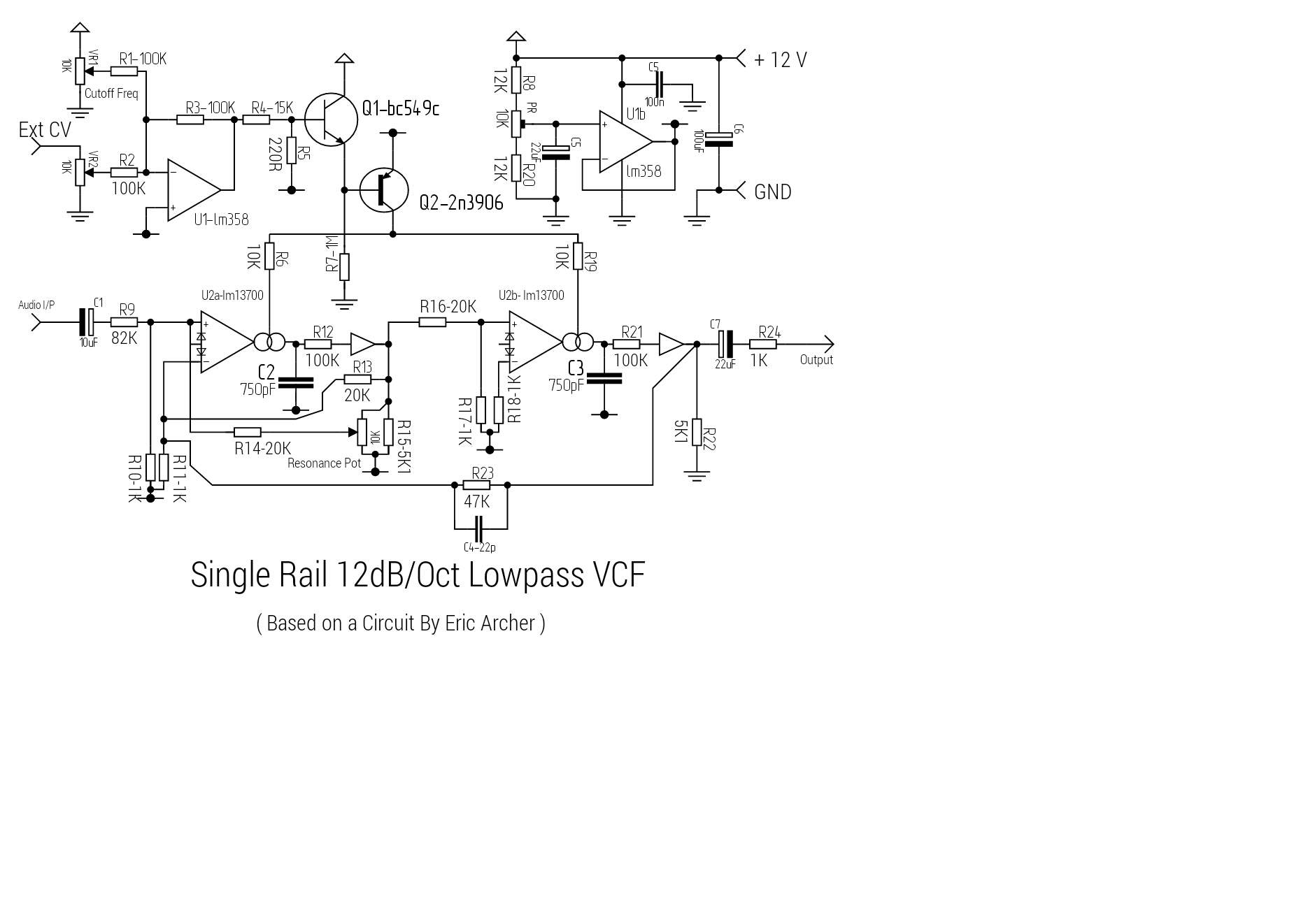

Yesterday I built another VCF to try with my Casio MT65 keyboard. It was based on a circuit by Eric Archer, that can be found, here:
9V Lowpass VCF
I had trouble getting his expo converter to work even with a rail to rail CMOS opamp ( lmc6482 ) Anyway I devised an alternative converter that can work with a cheap and simple lm358 with a single +12 V supply. I suspect it could work on lower but then I think a rail to rail opamp would become necessary, I try to avoid them as they are so much more expensive than regular opamp.
The circuit worked very well and actually produced some respectable sounds.
Here is the schematic of the VCF

ah, the good old Eric Archer LPF. I still have one laying around here which I am thinking of putting in a box with some other circuits
I have. So this thread is inspirational Very Happy I build mine with a TL072 TLC2262CP and didn't encounter any problems, or at least it sounds great. I
also used an opamp for the fake GND.
Since you already have a squared up version of the signal you could put the CD4026 with an R2R in there as a suboscillator.
It would only take 1 chip and a couple of resistors (and a mixer I guess).
(in case you missed it I posted a track in which I used it here and the patch here)
I have. So this thread is inspirational Very Happy I build mine with a TL072 and didn't encounter any problems, or at least it sounds great. I
I also used an opamp for the fake ground. I think the problem was messy construction on a breadboard, anyway I knew that the other circuit worked well with the lm13700, provided you're not too fussy about volt per octave tracking or temperature drift!

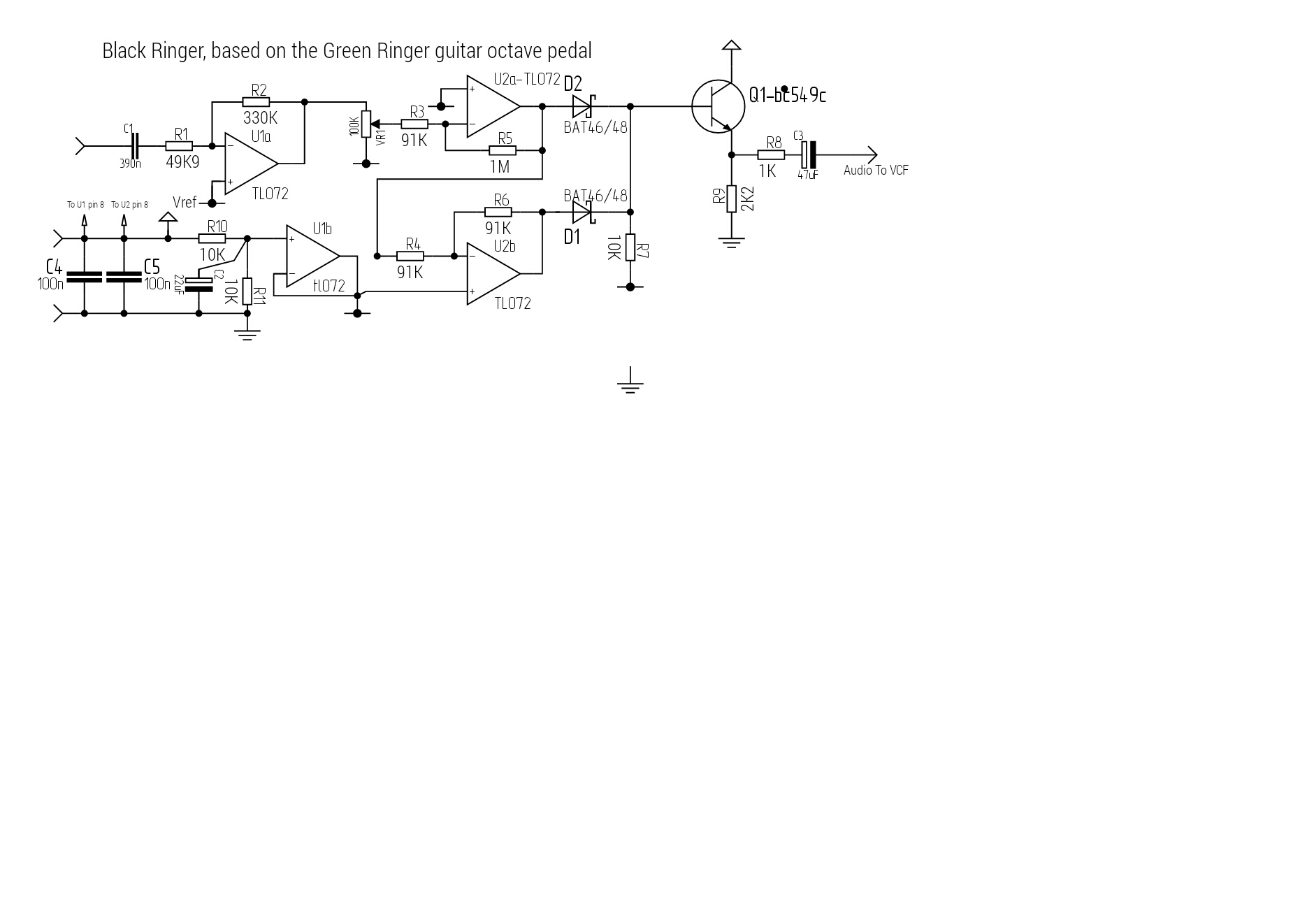

What I would really like is some kind of circuit to track the pitch of the signal from the keyboard. I was planning on trying some counters on the squared up signal. I also tried a guitar octaver circuit and this worked quite well.
PHOBoS I'll be sure to listen to your track later, I don't have my headphones at the moment.
I have attached the Octaver circuit that I tried.
Original Green Ringer Schematic

oops Embarassed I took a closer look at the opamp and I actually used a TLC2262CP. It had collected some dust over
the time it has been laying around here and I only took a quick glance. Had no idea I actually used a rail-to-rail opamp.
what exactly do you mean by tracking pitch, something that isn't a squarewave ? I assume that by squaring up the signal you
pretty much have something that tracks pitch. A divider might clean it up a bit though. The 4046 can also be used as a pitch
tracker but it is mostly fun when it fails doing that correctly Laughing
