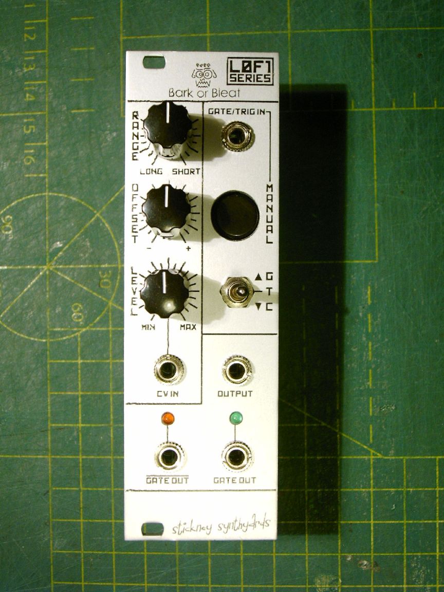

I am working on some L0F1 synth modules and finished the first two. Well, ok I finished one completely and for the other one I still need
a frontpanel but I am out of blank panels. However, it is all soldered up, tested and working Cool
The first module is Bark or Bleat.
Bark or Bleat is a synthesizer module of the Stickney Synthyards L0F1 series which uses a soundchip that produces a dog or sheep
sound (depending on the installed chip). This is a very lo-fi sound and it might need some imagination to recognize the sounds as such.
To trigger this sound it has a manual control by means of a pushbutton and an input for an external gate or trigger signal. The duration of
the sound can be controlled with two manual controls and/or an external control voltage.
It has 3 different modes which can be selected with a switch (SW2):
1) TRIGGER (switch in center position): after receiving a trigger/gate signal the sound plays for the duration set with the RANGE, OFFSET
and/or LEVEL controls.
2) GATE (switch in up position): Similar to the TRIGGER mode but if the gate signal is longer than the set duration it will keep playing for
the length of the gate signal. (Note: the sound repeats for a maximum of 3x and then stops even if the gate time is longer)
3: CYCLE (switch in down position): The sound plays for the set duration and repeats this indefinitely.
In TRIGGER/GATE mode the GATE and /GATE outputs can be used in conjunction with the CV input to use the module as a gate to trigger
converter with voltage controlled gate length. In CYCLE mode the GATE and /GATE outputs can be used in conjunction with the CV input
to use the module as a voltage controlled LFO.
This module has 2 inputs: The CV input, for which any voltage can be used as long as it doesn't exceed the supply voltage and a
gate/trigger input which works from about +2.5V up to the supply voltage.
This module has 3 outputs: The main audio output, which has a level of 0..+5V. the GATE output, which is +5V for the duration that the
sound plays and the /GATE output which is +5V when the sound is not playing.
Sadly I was not able to control the pitch but with the adjustable gate length it is still a fun and useful module.
I also used this module for Psycho Sheep Chess with Buddha.
Some more info can be found at http://stickneysynthyards.000space.com/bark_or_bleat/
Here's a photo of the finished module and some sound samples.

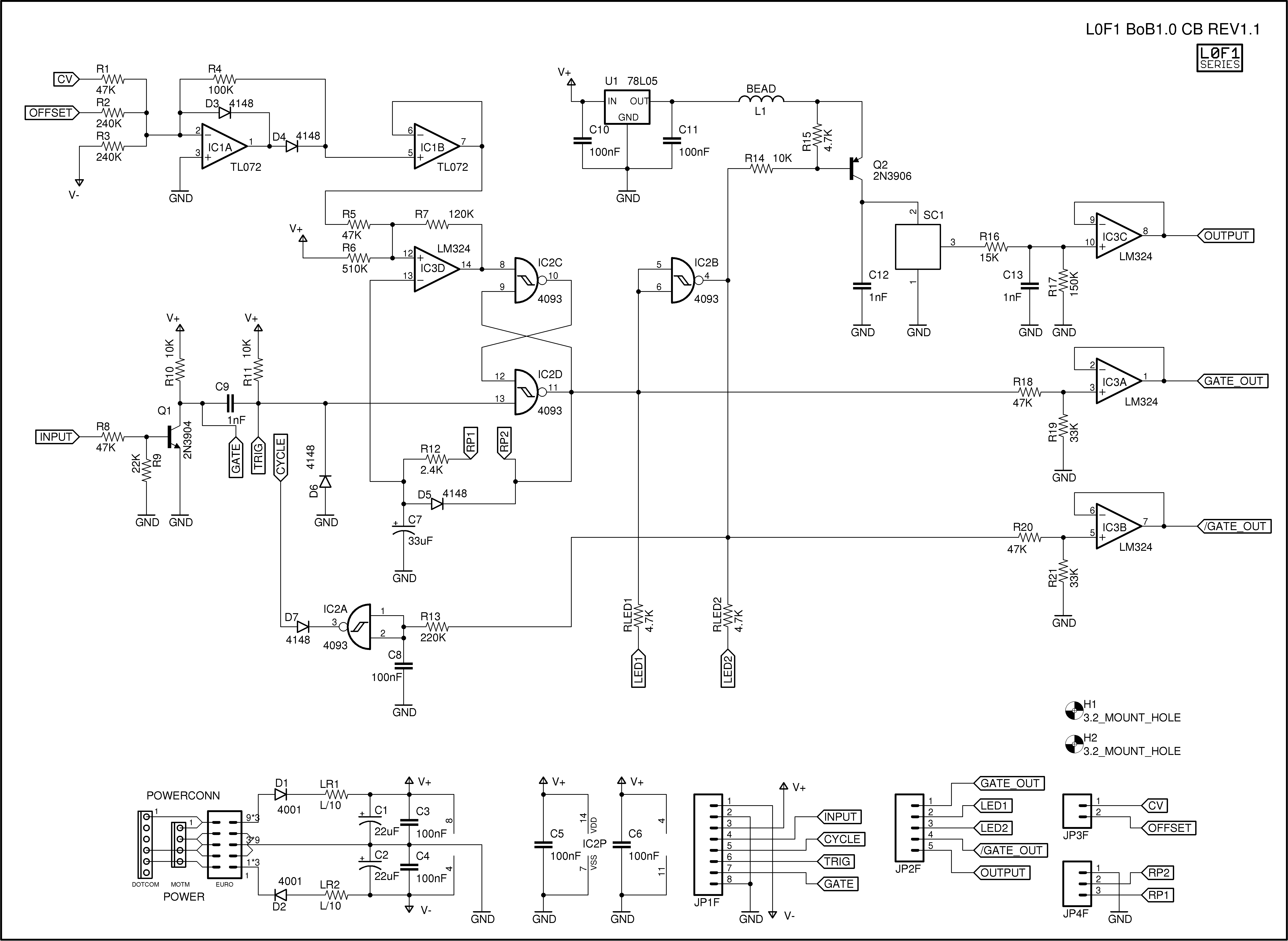

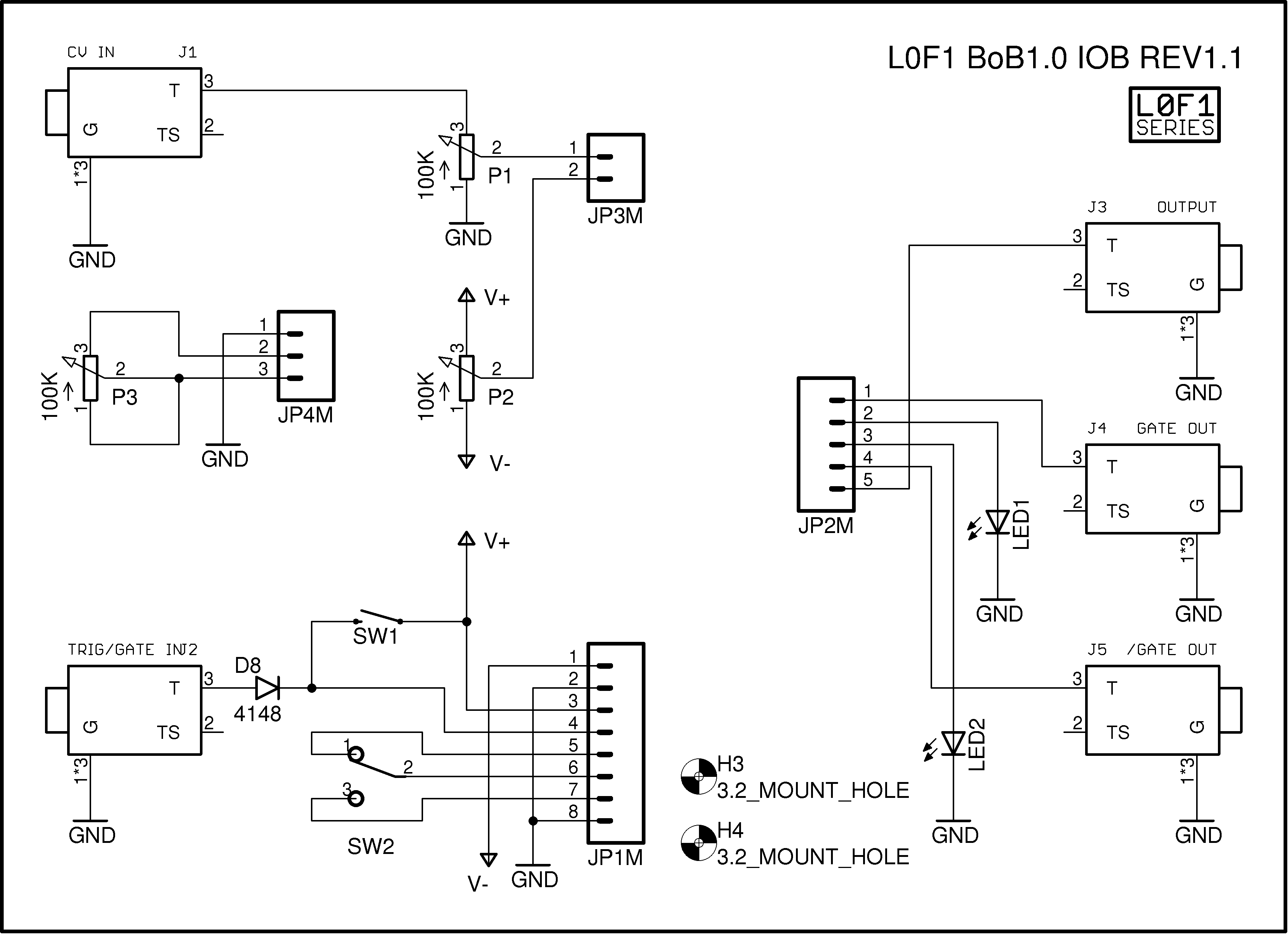

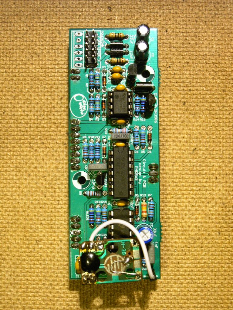

and here are the circuit diagrams and some photos of the soldered PCBs.
Bark or Bleat circuit board schematic
 Filesize:  132.12 KB
 Viewed:  773 Time(s)
Bark or Bleat in/out board schematic
 Filesize:  35.2 KB
 Viewed:  727 Time(s)
Bark or Bleat - Circuit Board
 Filesize:  214.23 KB
 Viewed:  761 Time(s)
Bark or Bleat - In/Out Board
 Filesize:  161.21 KB
 Viewed:  738 Time(s)

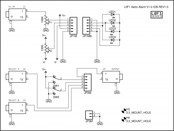

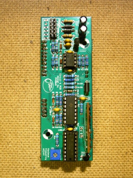

The second module is Astro Alarm.
Astro Alarm is a synthesizer module of the Stickney Synthyards L0F1 series which uses a soundchip that produces 4 different alarm/siren
sounds. The sound is continuous and the pitch can be controlled both manually and with a control voltage, similar to a VCO.
The different alarm sounds can be selected manually with 2 switches (SW1, SW2) or with external gate signals in a binary fashion. Which
sound is selected is indicated by 4 LEDs.
[00] (SW1: up, SW2: up) ALARM A: increases and decreases slowly in pitch.
[10] (SW1: down, SW2: up) ALARM B: increases and decreases fast in pitch.
[01] (SW1: up, SW2: down) ALARM C: two tone sound.
[11] (SW1: down, SW2: down) ALARM D: fast intermittent sound.
This module has 3 inputs: The CV input, for which any voltage can be used as long as it doesn't exceed the supply voltage and the 2 select
inputs which work from about +1.5V up to the supply voltage.
This module has 1 output: The main audio output, which is a (modulated) square wave with a level of 0/5V.
Some more info (incl. more demos) can be found at http://stickneysynthyards.000space.com/astro_alarm/
So for this one I don't have a frontpanel yet but here are some photos of the soldered PCBs, the circuit diagrams and a demo.
Astro Alarm - Circuit Board
 Filesize:  202.93 KB
 Viewed:  731 Time(s)
Astro Alarm - In/Out Board
 Filesize:  185.17 KB
 Viewed:  752 Time(s)
Astro Alarm circuit board schematic
 Filesize:  118.43 KB
 Viewed:  764 Time(s)
Astro Alarm in/out board schematic
 Filesize:  35.09 KB
 Viewed:  738 Time(s)
