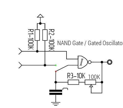

This one can be made from 1/4 of a 4093 or 74hc132. It is an oscillator or a nand gate depending on the switch position.

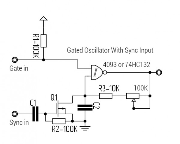

Another Schmitt gate based oscillator, this one with a sync input as well as the gate input. The value of C1 depends on that of C2, will need to experiment more to see what is best as I don't know how to calculate it on paper. Q1 can be a bs170 or a 2n7000.

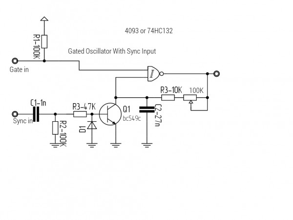

I have found the following oscillator with sync to work better than the one with the mosfet.
Note that with these simple circuits if the syncing oscillator runs at a higher frequency than the main oscillator that the oscillator will stall as the capacitor can't recharge quickly enough to sustain oscillation.

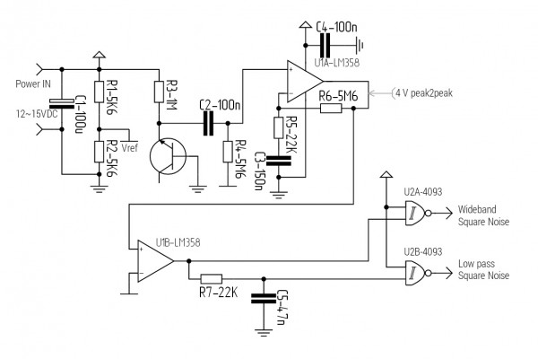

This one is a square noise generator, basically it outputs random 1s & 0s. This can be fed into shift registers to produce random gates or random voltages ( using a DAC such as an R2R network )
The low pass output is just more slowly changing, effectively it gives an alternative random output.

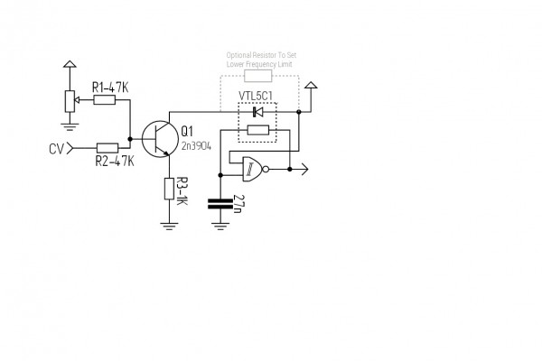

A very simple VCO using a Schmitt trigger oscillator controlled by a Vactrol. Note this VCO isn't linear OR 1V per octave! Is very simple though, good for Lunettas!

nice little circuits Very Happy
I like how you used the same resistors in the DAC to get different values. You can leave out the 2.2M though,
the tolerance of the 4k7 is much higher than what it changes in total value. Also instead of using the 3.33V reference
for the non-inverting input of the opamp I think you can just attach it to GND and add an offset voltage to the inverting
input.
And yes, vactrols work great for those oscillators, the slight slew is actually great for percussive sounds.
