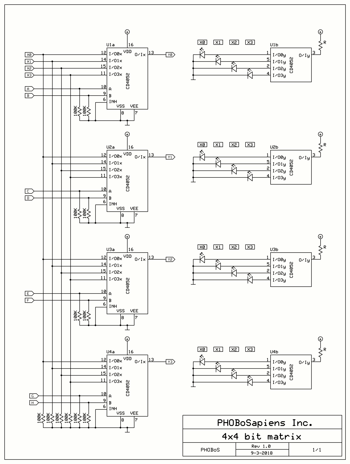

I already briefly mentioned this in the CMUSE thread, but what I would like is a circuit that has a
4 bit input and with some control signals can create permutations of these 4 bits (one at a time).
If you are unfamiliar with the term permutations it basically just means all the possible ways you
can rearrange the bits. I mainly want to test it with my chromatic melody generator but there are
other uses for it.
4bits has 4!=24 permutations. If the bits are labeled ABCD these are:
ABCD BACD CBAD DBCA
ABDC BADC CBDA DBAC
ACBD BCAD CABD DCBA
ACDB BCDA CADB DCAB
ADCB BDCA CDAB DACB
ADBC BDAC CDBA DABC
I have some ideas on how to achieve this but before I go into that I am curious if someone else can
come up with a nice solution. Using something like a PIC would be very easy btw but I'd like to do it
with logic chips. Although with something like a PIC it would be very simple to implement a CV input
and do all kinds of other things as well.
Instead of permutations it might also be useful to route an input to multiple outputs (like AABC or BDCD).
This would result in 4^4=256 different 'combinations'. A circuit for this would actually be very simple to
make. Just 4 muxes that route 1 of the inputs to 1 of the outputs controlled by 2 bits, so it would need 8
control bits in total.

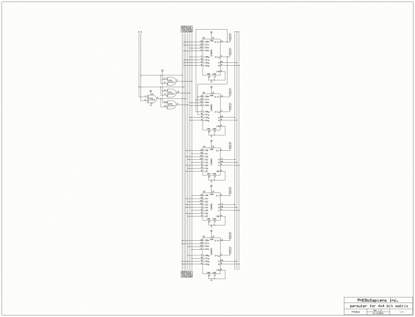

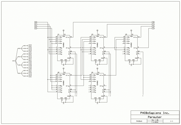

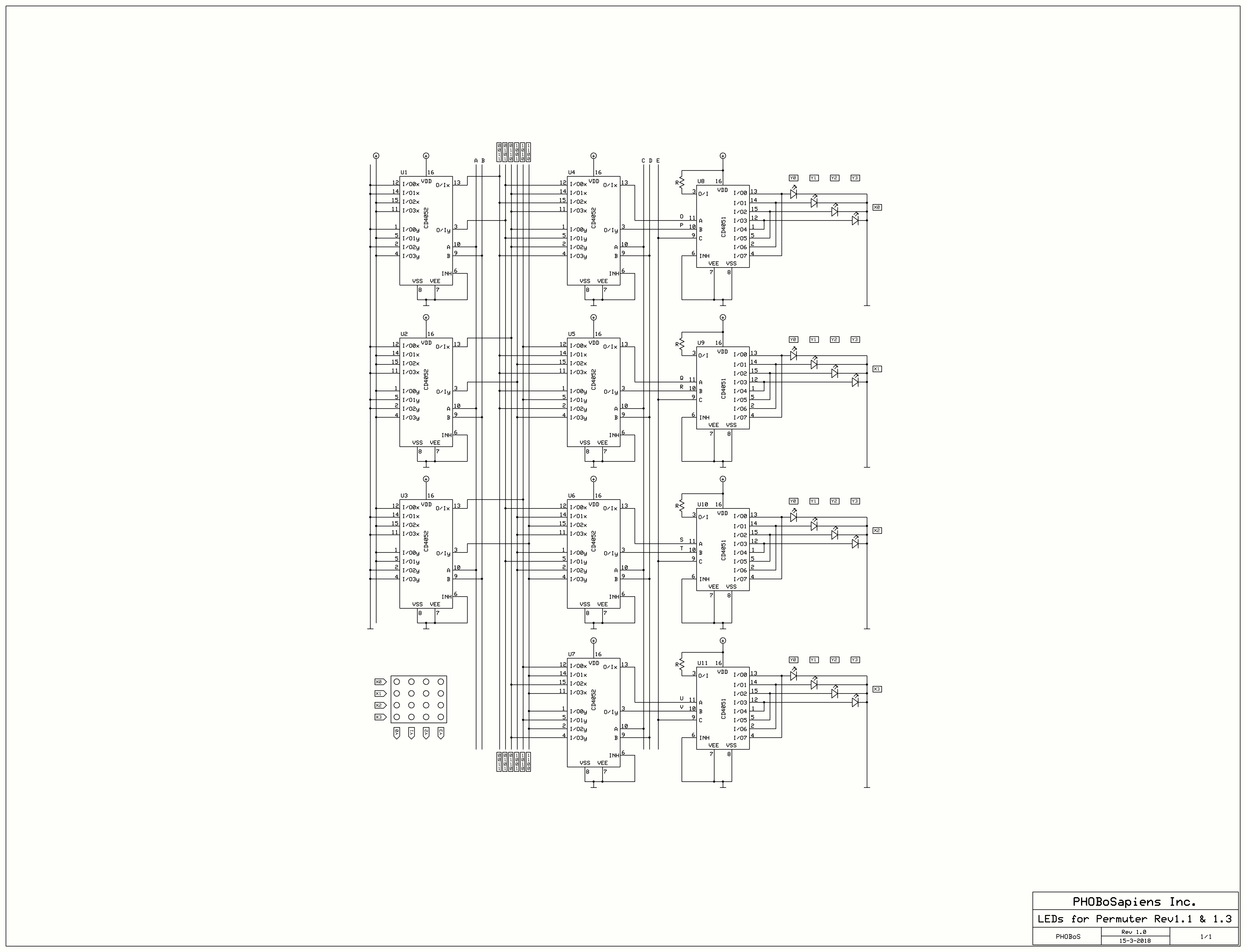

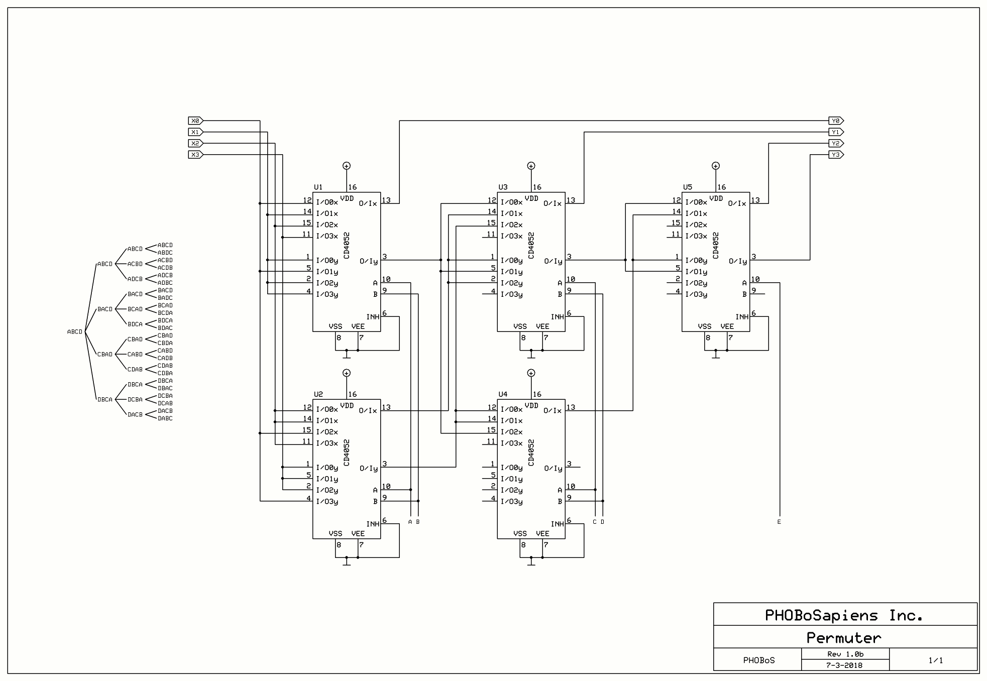

Steveg wrote:
Okay I've done the permutations, you need 3 pairs of 4052s with 6 control lines.
One wired as a barrel shifter.
One that swaps A<->B and C<->D
One that swaps A<->D and B<->C
Instead of the barrel shifter you could use one that swaps A<->C and B<->D you just get a different set of duplicates.

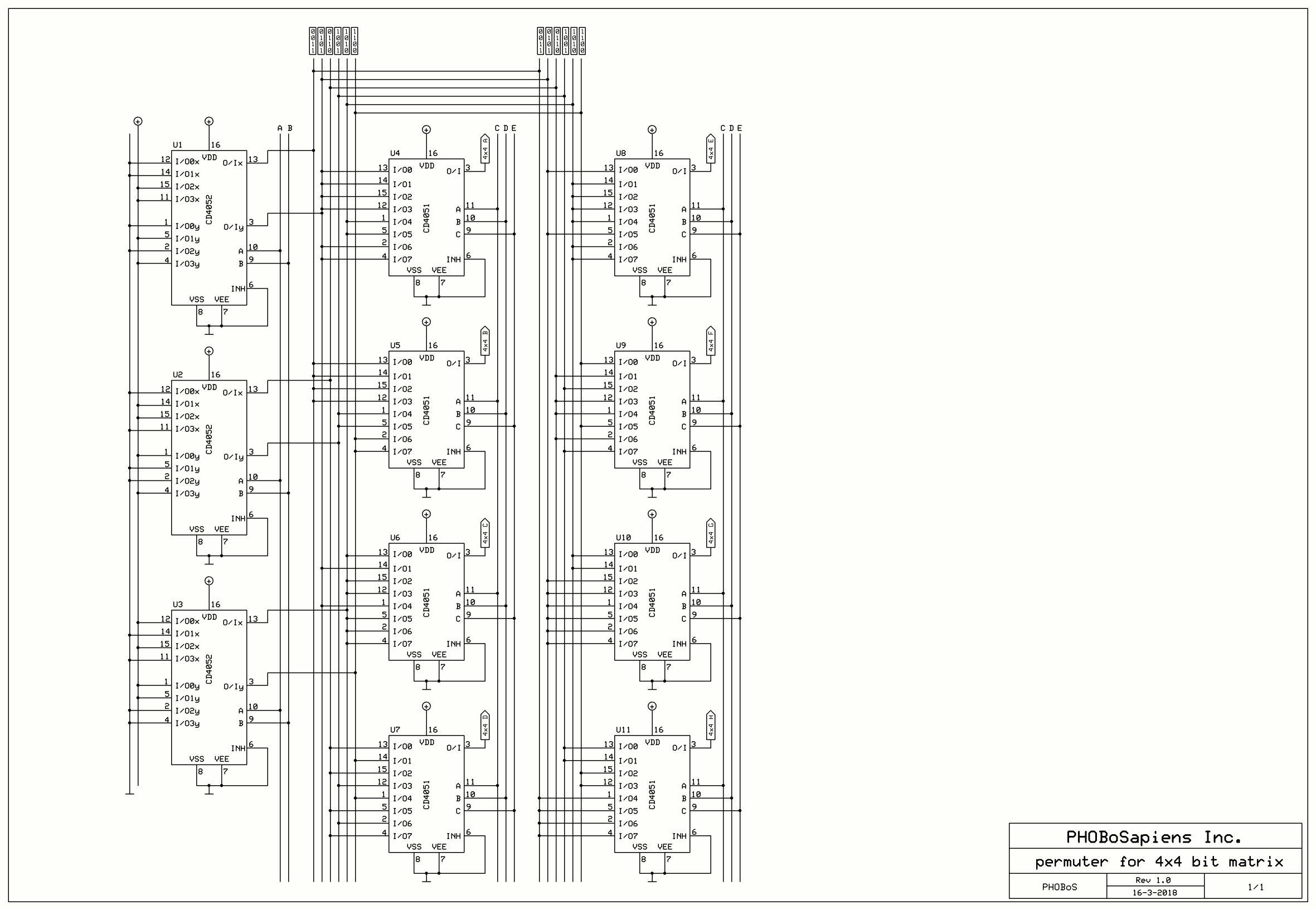

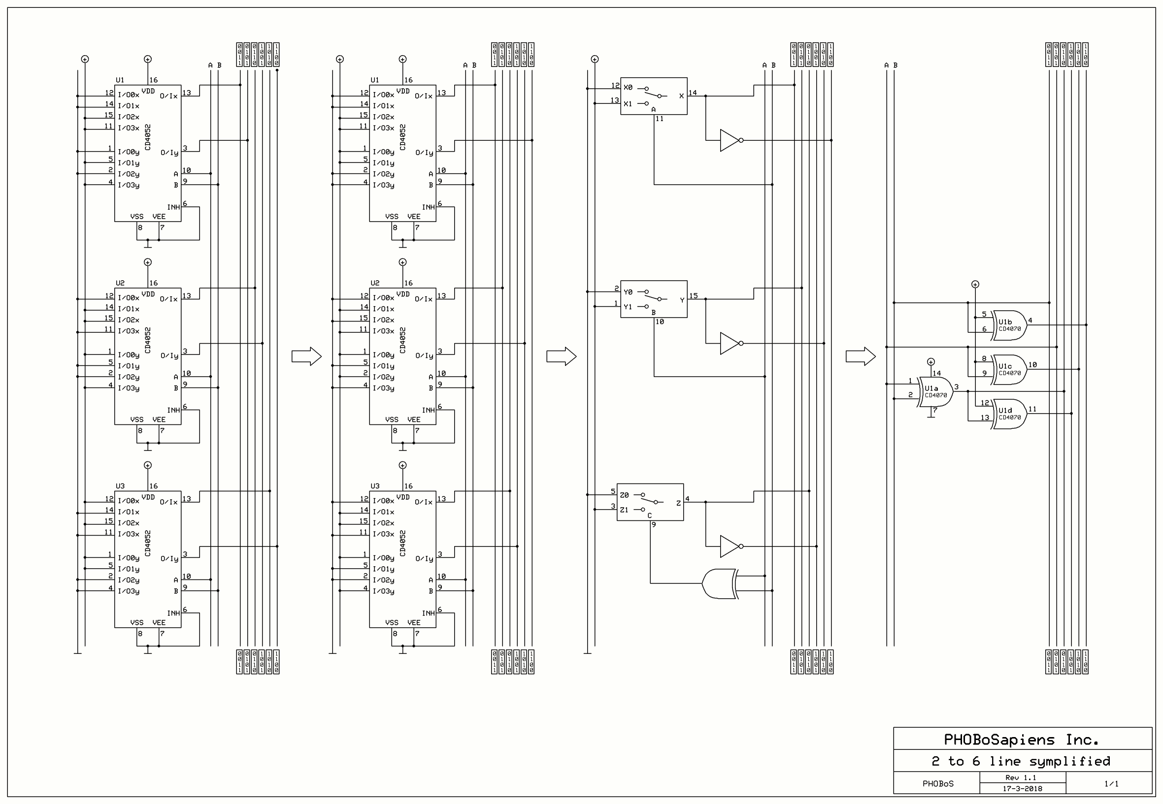

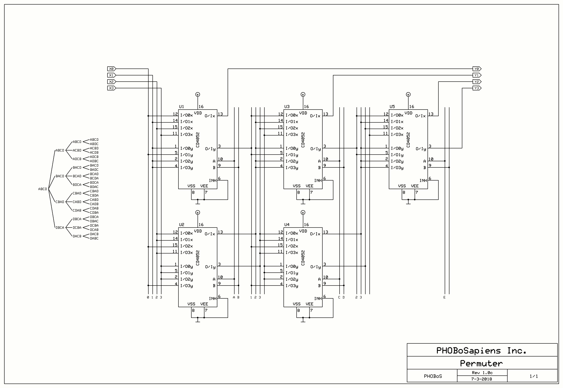

I drew up a version with 2 pairs + 1 (which can be a 4052 or 4053) and 5 control lines. I translated it from the
tree structure on the left which I got after reading up a bit about how to create permutations. A nice thing
about is that it is rather recursive. To show this more clearly I also drew up a version with some unnecessary
connections. If you would do something like that in code you would put it in a loop and/or function. So just for
fun I also started on a schematic which does just that. It isn't practical, needs more chips and a Clock, but it's
a nice challenge.
Here are the schematics, the permuter ones aren't complete as they have some floating inputs and some pull
down resistors on the other inputs would be needed for a standalone version.
note: X0..X3 are the inputs, Y0..Y3 are the outputs, A..E are the control lines.
Thanks for thinking along Very Happy

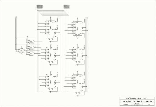

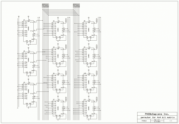

Posts: 5881
PostPosted: Thu Mar 08, 2018 1:24 pm    Post subject: Reply with quote  Mark this post and the followings unread
oh something I forgot to mention. A permuter can of course be used as a barrel shifter. I want to look into it
if it is possible to rearrange it in such a way that it can rotate by connecting a counter to 2 of the control
lines.
I think starting with a barrel shifter is probably the easiest way to make it possible to do this with 2 control lines,
I also like the idea of using the fact that half of the permutations are mirrored versions so I want to make
that possible with 1 control line. Mirroring is of course swapping A<->D and B<->C.
You've already done both things, shifting and mirroring in this version :
However, I don't like the A<->B and C<->D step as I'd like to keep the same bit at the first place after the barrelshift and
only change it at the mirror stage. After a bit of puzling I think I figured it out. It does produce some duplicates of course
but it makes it very easy to use to shift bits or mirror them.
Rev1.1 uses 6x 4052 and is probably the easiest to understand. Because the last (mirroring) stage only uses half of U5 and U6
it makes it possible to add some extra options.
Rev1.2 makes use of this.
- When CTRL X = 0 and CTRL E = 0, all the outputs are 0
- When CTRL X = 0 and CTRL E = 1, the permuter is disabled and the outputs (Y0..Y3) are the same as the inputs (X0..X3)
- When CTRL X = 1, the permuter is enabled and CTRL E works as the mirror control input.
Rev1.3 works the same as Rev1.1 but with 2x CD4053 and only has 5 chips in total instead of 6.
I drew up a schematic for that too and went a bit insane typing out a logic table for it as well
It's too bad that although the 4052 has 2x 4<>1 muxes that they share the control inputs, otherwise
it could be done with only 2 chips. But it's also useful to add some status LEDs. If you construct the
whole thing like a matrix with the LEDs in a 4x4 grid you can instantly see how things are routed.
This is actually something I would like to do with the permuter as well but I haven't figured out yet
if there is an easy solution for this.
oh and if you're nuts you could of course use the 4051 (8x) and make an 8x8 matrix, which gives you
16777216 routing options. Or if you are completely bonkers you can use the 4067 (16x) which gives
you, well, I am not even going to type how many options that gives Laughing (it would also have 64 control lines)
edit: I noticed some (rather obvious) errors in the logic table, so uploaded a revised version.

I used 6 4<>1 muxes (U1..U3) to create the 6 possible combinations. A CD4052 already has 2 4<>1 muxes but they share the
A&B inputs. Since all the A&B inputs need to be wired together anyway this isn't a problem so it only needs 3 chips for this.
What's left is to route one of the outputs of these muxes to the (O..V) inputs of U8..U11 which can be done with, you probably
guessed it, more muxes. 8 4<>1 muxes to be precise. As with U1..U3 the C&D inputs are all connected together so it can be
done with 4 chips (U4..U7).
Let's take a look at the column beneath P again. For the first cycle (DC=00) the order of bits is 0110 which corresponds with
the x 'output' of U2 so that's what it is connected to. For the second cycle (DC=01) the order is 0101 which corresponds with
the y 'output' of U1. The order for the third cycle (DC=10) is 0110 again so that's also connected to the x 'output' of U2. The
order for the fourth cycle (DC=11) is 0011 which corresponds with the x 'output' of U1.
It's still a silly amount of chips especially in combination with the permuter itself. Something like an (E)EPROM would be ideal for
this but I've never used them and I have no idea if they are readily available with the amount of outputs that would be needed
for both circuits, which is a minimum of 12 if you'd still use U8..U11. Of course you could simply use more than 1 if needed. Also
the 4x4 bit matrix I posted above can do all the permutations and much more + control the LEDs with only 4 chips in total.
hmm, I wonder if it would be easier to make some sort of converter, which could be very similar to this circuit for the LEDs, that
can be used in combination with the 4x4 bit matrix.

hmm, I think adding 4 muxes in parallel to route the actual signals would work. I wonder if I can also do
something similar for driving LEDs with the permuter Rev1.3 circuit. I have a gut feeling it can be simplified.

U1, U2, U3 of the Leds for permuter schematic can be replaced with just a single XOR chip. Cool
There are only 6 combinations of 1's and 0's that can be made this way: 0011, 0101, 0110, 1001, 1010, 1100
Half of those are actually just the inverse of the other ones: 0011 <> 1100, 0101 <> 1010, 0110 <> 1001. I changed how
U1, U2, U3 are connected so this is easier to see. By doing this only 3 1<>4 muxes would be needed + 3 inverters. Even
better, they can be replaced with 1<>2 muxes. 0011 <> 1100 can be directly derived from Control input B, 0101 <> 1010
can be directly derived from Control input A and 0110 <> 1001 can be done by using an XOR gate. But it gets even better.
The 1<>2 muxes just switch between 1 and 0 so they can be left out completely.
I guess that with all those muxes I almost forgot you can also do things with logic gates. Laughing
Using the same method I came up with a circuit. It is indeed very similar and it just needs to convert the 5 Control lines to
8 bits but unlike the muxes that drive the LEDs the 4x4 bit matrix doesn't have the mirror function built in. It's not as simple
as reversing the bits so instead of 1<>4 muxes, 1<>8 muxes are needed. U1, U2, U3 can of course be replaced with a single
XOR chip and U4..U11 can be reduced to 6 chips. I am currently trying to figure out if I can reduce the chip count further by
using more logic gates.
here' s the logic table I used

I quite like this version. The 4x4 bit matrix could be use standalone and the permuter converter might be fun by itself too.
Another nice thing is that the signals now only pass through a single mux each. Although I plan on using it for digital signals
they are analog muxes. With the signals passing through a single mux it would not be very difficult to make them useful for
negative voltages so it could be used for a modular synth as well.

here's the version with reduced chip count.

And then there where 6 chips left.
I don't think I can reduce it any further.
Just to be clear, this is meant to be used in combination with the 4x4 bit matrix
to give it the same functionality as permuter V1.1 & V1.3 but with LEDs.
