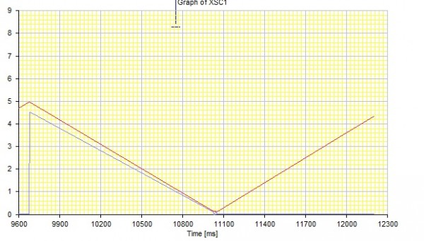

Again my apologies.. I meant that I increased the cap value to reduce the timing. with the smaller cap the pots Linearity was dicey heading towards ground, it would shift a few octaves with very little turn left.. Also like I mentioned, I think increasing the cap reduced the skewing of the tri some, but obviously my 47k resistor isn't ideal.
All this was tested quickly just to get a working circuit to solder onto perfboard, I have a test lead coming from the input of the buffer/output of triangle and square to my breadboard for further easy testing.
I will try and make up a 50k resistor just to get me in the ballpark, I don't have 1% so must order a few..
But this has potential, I ran a saw waveshaper using one more opamp and a tranny on the lm324 after you corrected the dc offset and that seems to spit out a saw that mirrors the triangles slopes no to shabby..
Triangle biased to ground and sawtooth shaper for comparrison

When you look at the DATASHEET you can read that the minimum output voltage when powered from 5 volt is (depending on the type of 325) typ. 5 mV up to 100mV, while the maximum output voltage in this case will be typ. 3.5 volt.
So, maybe you could better look for a opamp with a smaller headroom and lower minimum output voltage.
