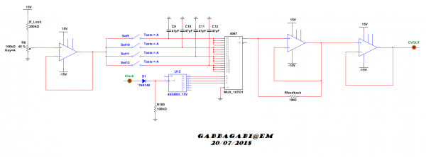

i have many of those little pushbottons left,
so i was thinking about how to use them in a sequenzer,
attached an idea for a gate sequenzer,
one had to push two buttons at a time to programm it, set or reset button and the desired step button
on the gateout one could attach a 4017 with pots to have CV, whitch has the atvantage that the CV would stay until the next gate impulse comes
the caps will decharge over the time but it will take a long time until they go under 0,6V (one could use smaller caps to add somekind of randomness when the seq starts to forget Smile

get rid of the TL071 and use a noninverting buffer (spare gate, or 2 inverting in series) instead. With a feed forward resistor of 100k between in and out of the buffer the caps (100nF then) will "autorefresh" forever.
hmm so that would be from the gate output back to the common (Y) of the mux ? at least that's how I think it could work Very Happy.

PostPosted: Tue Jul 03, 2018 1:35 pm    Post subject: Reply with quote  Mark this post and the followings unread
g.gabba wrote:
what a great idea with the feed-bag, would than this also work somehow?
no, won't work. you need positive feedback (noninverting Schmitt-Trigger)

didn't know this sequencer yet. google found " the LEPLOOP has a 16-step analog recorder, much like an analog delay.Over time, as the analog sequencer cycles through its pattern, the signal will degrade and the sound will hange. This is because the capacitor can only store the signal for a limited amount of time"
for a step sequencer storing only 0V and VDD, refreshing the memory is easy with a noninverting Schmitt-Trigger as described above. For real (quantized) analog storage you would need an ADC that reads
the actual (already slightly drifted) analog voltage and refreshes the original voltage with a DAC. I've sketched a 3bit solution with 8 comparators and a 8/3 decoder as ADC and a 4051 with linear R string as DAC.
But in microcontroller days it's too much effort to do it Lunetta style.

I took the idea for the one-pot-cv-seq on a breadboard-ride.
first i tried 100nF caps and a 100k feedback resistor, with this the CV went slowly but noticable up.
So i tried something bigger 47µF and 1M- which sounded stable. Ive did a recording of 18 minutes, and it came out that with this combi the pitch is going down, but veeeery slowly. So adapting the C/R combi will stabilize the drift more, or one could use a pot as feedback-resistor to make the drift variable Smile
attached a soundfile which shows the pitch-drift over the time: 0min, 6min, 12min and18min.
