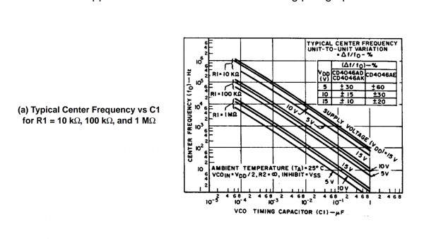

Ideally I'd like to take an external bpm (from say a Korg Volca) around 120bpm / 2hz and double this using a 4046 to 4hz.
CHRISKELLY
Joined: Apr 08, 2018
Posts: 103
PostPosted: Fri Aug 17, 2018 9:03 am    Post subject: Reply with quote  Mark this post and the followings unread
I think I've found a useful graph from the datasheet. If I'm reading this right then the timing cap should be around 0.1u.
Is the timing cap the one between pins 6 and 7?

PostPosted: Fri Aug 17, 2018 9:18 am    Post subject: Reply with quote  Mark this post and the followings unread
You can do this with a 4046 and a flip-flop in the loop, however, when the tempo clock changes, there may be variations in the 4046 output until it stabilizes and locks. If the tempo clock remains the same throughout it's use, it should work.
The timing cap is on pins 6 and 7.
With a PLL, you want the cap you select to allow frequencies both above and below the target, otherwise you cripple the ability of the 4046 to lock.

NVM i think i figured it out:
Based on the graph, for R1 = 1M and C1 = > 0.2u i should be able to get to 4hz
Sorry for the forum spamming! Laughing

Just seen your post Jovian!
Thanks for the info - I'll find a good range of resistors for pin 11 and pin 12 then to maximise the range I can lock onto.
I assume this is all done via comparator 2? I was going to use the LPF using 10k's too as per your Fatman Synth harmonic guide

PostPosted: Fri Aug 17, 2018 9:56 am    Post subject: Reply with quote  Mark this post and the followings unread
Phase Comparator II has the widest lock range and also maintains a zero degree phase shift with the input signal, so it is your best bet. It also resists locking to anything but the fundamental (phase comp I can lock to octaves or 5ths of the fundamental under certain conditions).
