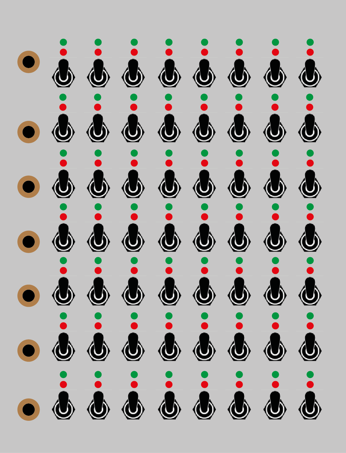

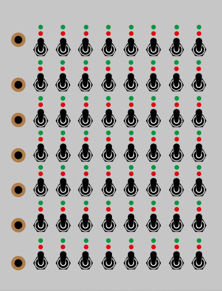

PostPosted: Wed Jul 25, 2018 11:42 am    Post subject: Reply with quote  Mark this post and the followings unread
I did a quick sketch of a hypothetical 3U front panel.
If i loose the reset function, there could be a push-button with led as you suggest, which will free some space - but then again the reset function is nice.
edit: nevermind the 7 rows - there should be 8 but no room for it as of now.
any sugestions?

Posts: 5881
PostPosted: Wed Jul 25, 2018 1:33 pm    Post subject: Reply with quote  Mark this post and the followings unread
The "reset" position; does it make the sequence start over at the beginning?
yep. If you don't connect it (or actually connect it to GND as you shouldn't leave it unconnected) the 4017 will step through 0~9 and start with 0 again.
If you would connect it to one of the outputs, for example Q7 it well only step through 0~6 and then start at 0 again.
It would be nice with leds for each row which indicates where the sequence is at and - one row of leds which indicate which step is turned on. Is this easy to implement?
Pretty easy to do if you use double pole switches, then you can just use 1 half of the switches to turn the LEDs on/off.

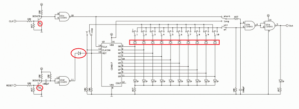

Are these 1N4148?
 Filesize:  207.14 KB
 Viewed:  582 Time(s)
Posts: 5881
PostPosted: Wed Jul 25, 2018 3:50 pm    Post subject: Reply with quote  Mark this post and the followings unread
yep I used 1N4148 for those, but pretty much any diode should do (no zeners of course) so that's why I didn't label them.
Actually the ones on the clk and reset inputs are NPN transistors, not really critical what you use. I used BC547, but 2N3904 or similar is fine too.

synaesthesia
Joined: May 27, 2014
Posts: 291
Audio files: 85
PostPosted: Sat Jul 28, 2018 2:45 pm    Post subject: Reply with quote  Mark this post and the followings unread
You drew little red circles around the emitter diodes of the transistor symbols on the left side as well.
Mind that you should not insert diodes at these places in your circuit. The triangle is a part of the transistor symbol.
Inserting diodes at these places would increase your LOW logic level output and the circuit might not work.

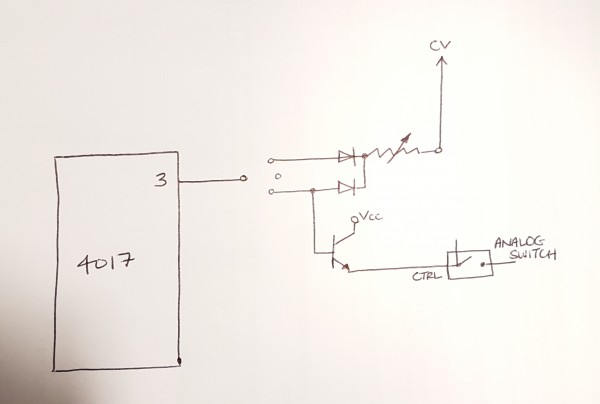

PostPosted: Wed Sep 05, 2018 3:50 pm    Post subject: Reply with quote  Mark this post and the followings unread
I really like the use of on-off-on switches on each step!
Would it be possible to have one of the ON sides connected to the base.of a transistor which acts as a switch to send high/low to a logic gate, as well as gating the CV?
What I'm thinking is you could then have one ON triggering a long note (full clock cycle) and the other ON triggering a short note (half clock cycle). The OFF would mean no note.
If the transistor was used correctly could it be used to drive logic without affecting the CV, as in - acting as a buffer? You could tie each of the 4017 outputs to a common transistor using diodes.
CHRISKELLY
Joined: Apr 08, 2018
Posts: 103
PostPosted: Thu Sep 06, 2018 2:04 am    Post subject: Reply with quote  Mark this post and the followings unread
Kind of like this
 Filesize:  2.2 MB
 Viewed:  301 Time(s)
Posts: 5881
PostPosted: Thu Sep 06, 2018 7:14 am    Post subject: Reply with quote  Mark this post and the followings unread
I think that could work and depending on what you want to drive with it you probably don't need the transistor. Actually it might
be better to use an extra logic gate as a buffer for the CV instead. This way it doesn't matter if the output voltage of the 4017 is
affected by another load.
