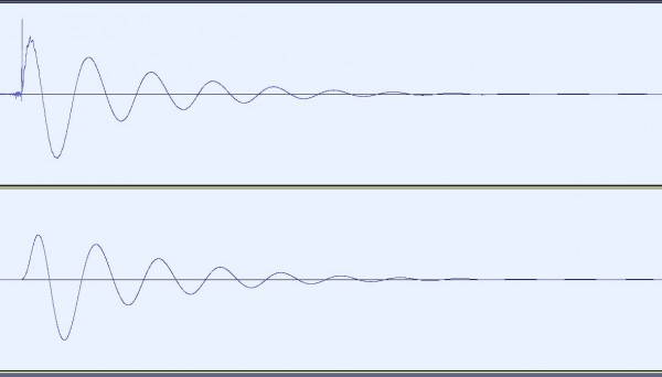

Posts: 1319
PostPosted: Fri Dec 14, 2018 1:01 am    Post subject: Reply with quote  Mark this post and the followings unread
zappitron wrote:
It's the strangest thing, it's not there until after the drum has been recorded..
So, that points into the direction of your recording setup.
Possible cause might be that there is a very short, high amplitude pulse at the beginning of your drum-hit, that causes the input amplifier to mess things up.
Or maybe there is an amplitude controlled amplifier somewhere (might be software)
edit:
I have looked at it with Audacity and there is a very sharp pulse at the start of (almost all) kicks.
You could try to add a 10nF capacitor from pin 3 of the 4069 to ground, which add a 100Hz low pass 6dB filter, so together with R2 and C6 you have a 12 dB 100Hz low pass filter.
See: http://sim.okawa-denshi.jp/en/CRtool.php
Top = Before filter
Bottom = After 100Hz 12 dB Low pass filtering
 Filesize:  51.05 KB
 Viewed:  460 Time(s)
my synth

Hmm.. that didn't do it. The kick does sound a lot nicer now Smile But it's still there.. I made a new clip and looked in audacity and the beats that have it do look a bit mangled. You can hear it really clear on headphones. It comes in after a few beats.
Sorry if I'm boring everyone to tears with this but I just want to understand what is happening and hopefully learn something
