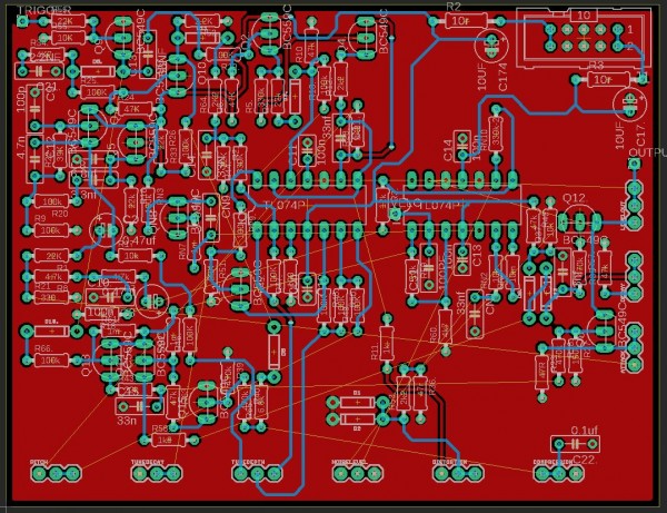

Hi to all, I created in Eagle the circuit for the Bass Drum Module of the legendary kick drum of the TR909. I am a disaster to create PCBS in Eagle but I want to share the schematics, perhaps somebody more experimented on creation on Pcbs can create a single side pcb. I tried but without success.
The circuit is a clone of the TR9090 http://www.9090project.co.uk/ and with the mods of Jörg Schmitz, http://www.analog-synth.de/synths/tr909/tr909.htm
both works are based on the Roland original schematics.
Thanks in advance.

PostPosted: Fri Oct 26, 2018 3:18 pm    Post subject: Reply with quote  Mark this post and the followings unread
23 signals to go..... did all the easy ones though, now come all the tough ones that need to snake in between everything else.

PostPosted: Sun Oct 28, 2018 1:21 pm    Post subject: Reply with quote  Mark this post and the followings unread
11 signals to route, but the easy ones are long gone....
Might need to move components around.

PostPosted: Tue Oct 30, 2018 4:28 pm    Post subject: Reply with quote  Mark this post and the followings unread
All routed Very Happy
Will need to do some moving of traces to increase clearance, maybe do some nudging of components.
Haven't incorporated mods, but if someone says which component to replace with what I can add that no problem.
Nb. picture does not show ground plane (top), for clarity.

PostPosted: Wed Oct 31, 2018 3:36 pm    Post subject: Reply with quote  Mark this post and the followings unread
About done, no mods, haven't run ERC/DRC but as far as I can see, there are no collisions or spacings that are too tight.
Things to do:
Need a ground pad to connect the jacks
ERC/DRC
A few mounting holes for those that fully wire it up (I think I'll use PC mount 9mm potmeters).
 Filesize:  280.75 KB
 Viewed:  606 Time(s)

PostPosted: Thu Nov 01, 2018 3:49 am    Post subject: Reply with quote  Mark this post and the followings unread
Also, I have a separate board that has transistor noise and shift register noise. I think I'll try to add that mounting hole pattern to this board so you can piggyback the two and use the original noise source (and add a PSU connector).
Anything else people want to add, did anyone spot errors in the schematic?

PostPosted: Mon Jan 14, 2019 6:03 am    Post subject: Reply with quote  Mark this post and the followings unread
Sorry for not replying, lots of things to do Very Happy
I made the following list of things I like to have a look at:
velocity input is different from hexinverter nein oh nein schematic
Nein oh nein has additional opamp for triggerinput
Noise check circuit
Output filter and resistor
mounting holes noise board
extra psu on 3 pole 0.1" pitch connector footprint
ground connection for jacks
check position potmeters
check packages of 0.33uF caps (film of elco?)
Schematic reorganise for clarity
Noise components cluster on right end of board (are spread out now)
ERC/DRC
Mounting holes
Check pot spacing wrt edge of board (0.2" nu)
Wrt, remarks about the noise board, I made my own board, which has the circuits for both transistor noise and shift register noise, I'd like to be able to mount that board as an option.
If you can check the velocity and trigger input circuitry, as well as the transistor noise circuitry, that would be helpful. I think the nein oh nein schematic from hexinverter is a good starting place, there are alternative sites which had working clones of 909 and 808, but I think these have vanished.

PostPosted: Sat Feb 09, 2019 6:55 am    Post subject: Reply with quote  Mark this post and the followings unread
So, been tweaking it a little bit. Added the trigger conditioning from the hexinverter schem.
Still will need to do some more checking though.
I'll leave the Eagle files here, should anyone want to pick this up faster than I do (I usually have quite a few hobby projects at the same time).
