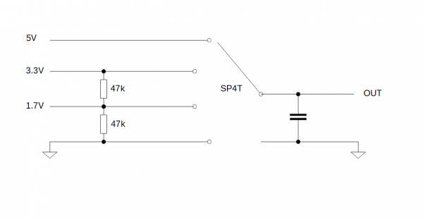

You may be able to find a different kind of rotary switch which "makes (the new contact) before break (the old one)" or "shorting" .. like (first google hit here for it) https://nl.farnell.com/lorlin/ck1037/switch-4-pole-3-pos-0-15a-250v/dp/1123693

Here's a (bad) image of the situation I have:
I've got 4 different voltages to choose between. The 5V and 3.3V are provided by the Arduino. A voltage divider provides the 1.7V. I've added capacitor behind the switch to hold the voltage between switch-overs (when the pole is floating temporarily). As can be seen, when switching from, say, 3.3V to 1.7V the line is forced to the 3.3V still stored in the cap, until it can discharge through the resistor to ground -- disrupting all other pots on the same 1.7V bus -- some of which randomly trigger changes on the Arduino, flooding the MIDI channel with parameter changes that never happened.
For a moment I thought that, perhaps, adding a diode after the switch would block the path back to the voltage busses, but then I'd need a resistor parallel to the cap to discharge it. Too much hassle.
I can see the benefit of the make-before-break option. I should have thought of that sooner.
Thanks again for your answers. I think I'm going to remove the caps. I can certainly smooth the reading of a single switch in software, but I don't really care to check every random change of a discrete pot to see if it's legit.

hmm, maybe connect a large resistor (at least a factor 10 larger than the ones used for the voltage divider) between 3.3V and the output.
You will mostly be switching from or to 3.3V anyway and it will keep the voltage at 3.3V when the switch 'breaks'. It would also be a good idea
to buffer the 1.7V; add a small capacitor to GND and use an opamp configured as a voltage follower to buffer the voltage.
