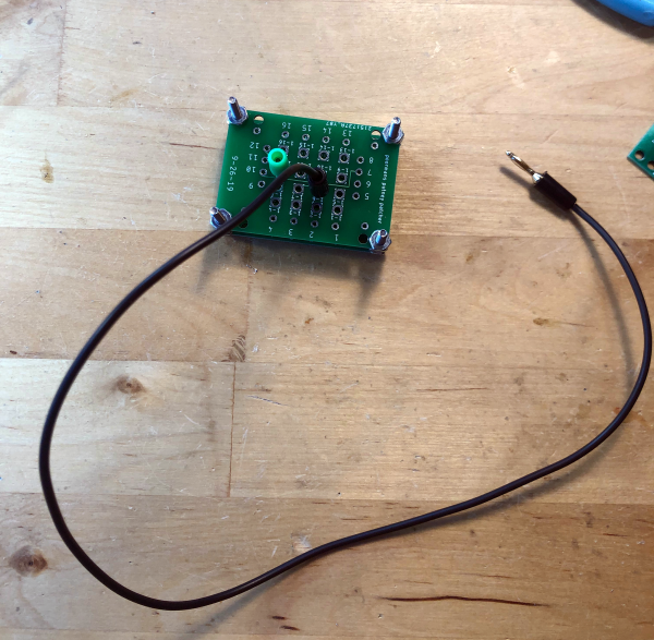

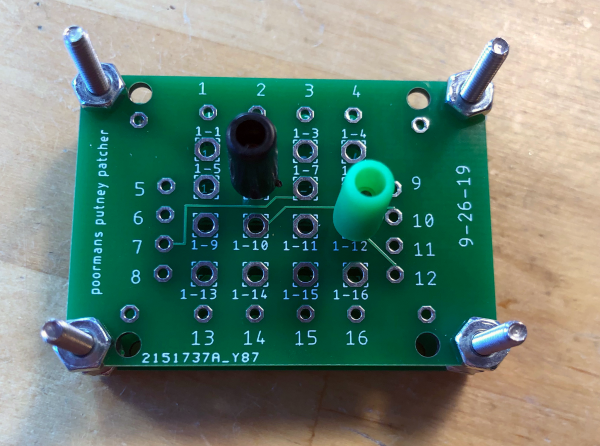

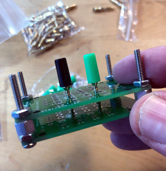

[quote="cslammy"]
good luck with that Very Happy (I mean that in the most positive way)
Hey Phobos! Got your suggestion of a 2.5mm banana w/ springs working--thanks! Very Happy Found the plugs on amazon, not expensive.
This seems way more durable.
I was also thinking of using some sort of .1mil 4x connectorization for hookup, if the top board does wear out, replacing it would be easy, just bolt in a new one and reconnect. Might redesign the top board for that.
Updated the post (very bottom)
https://audiodiwhy.blogspot.com/2019/08/putney-poor-mans-patcher.html

Posts: 5888
PostPosted: Sun Oct 06, 2019 12:12 pm    Post subject: Reply with quote  Mark this post and the followings unread
awesome! Very Happy
How easy is it to insert the connectors straight ? It might benefit from some spacer boards in between for which you could use another PCB.
Since PCBs are rather cheap to produce you could design some seperate ones for this with slightly larger holes and without any pads/through
hole plating. Those should last forever. Just one board in between (so 3 PCBs in total) might already be enough. Or you could keep it a bit more
DIY and use wood or plastic and drill some holes in it.
Using connectors to make it easy to replace the boards sounds like a good idea.

PostPosted: Sun Oct 06, 2019 2:50 pm    Post subject: Reply with quote  Mark this post and the followings unread
You can see from one of the photos that they don't always go straight in Shocked You can bump 'em around and get em to make contact but I think putting a 3rd board sandwiched in there with say 85mil drills and no vias would be a great improvement. When I redo for 4x1mil connectorization I'll get that going as well. Thanks for another great suggestion.

piedwagtail wrote:
I've been using these at 4mm in pcb holes.
I see they're available for 2mm.
Work fine, just a little solder time.
https://www.rapidonline.com/pjp-20052cd1000-economical-2mm-pcb-socket-17-1042
R
Piedwagtail can you please give a bit more detail? Would you solder these into the top layer board to make the via contacts tougher?
piedwagtail
Joined: Apr 15, 2006
Posts: 297
Location: shoreditch
PostPosted: Mon Oct 07, 2019 5:25 am    Post subject: Reply with quote  Mark this post and the followings unread
yes, tougher than pcb traces and they hold the plugs vertically as well as typical sockets.
R

Let's motorize our pursuit.
2mm eyelets are available inexpensively in the crafts world. EG:
https://www.etsy.com/market/2mm_eyelets
I bought 100 2mm x 3mm ones from Amazon very cheap. Got them yestewrdayl. They fit the 2.5mm bananas fine, so I'll see what I can do with those.
There are also 2mm x 5mm eyelets I want to try. I see no reason why they won't work.
I have another run of boards to do soon and will do a run of 5 or so that accommodate 2mm eyelets and report back.
