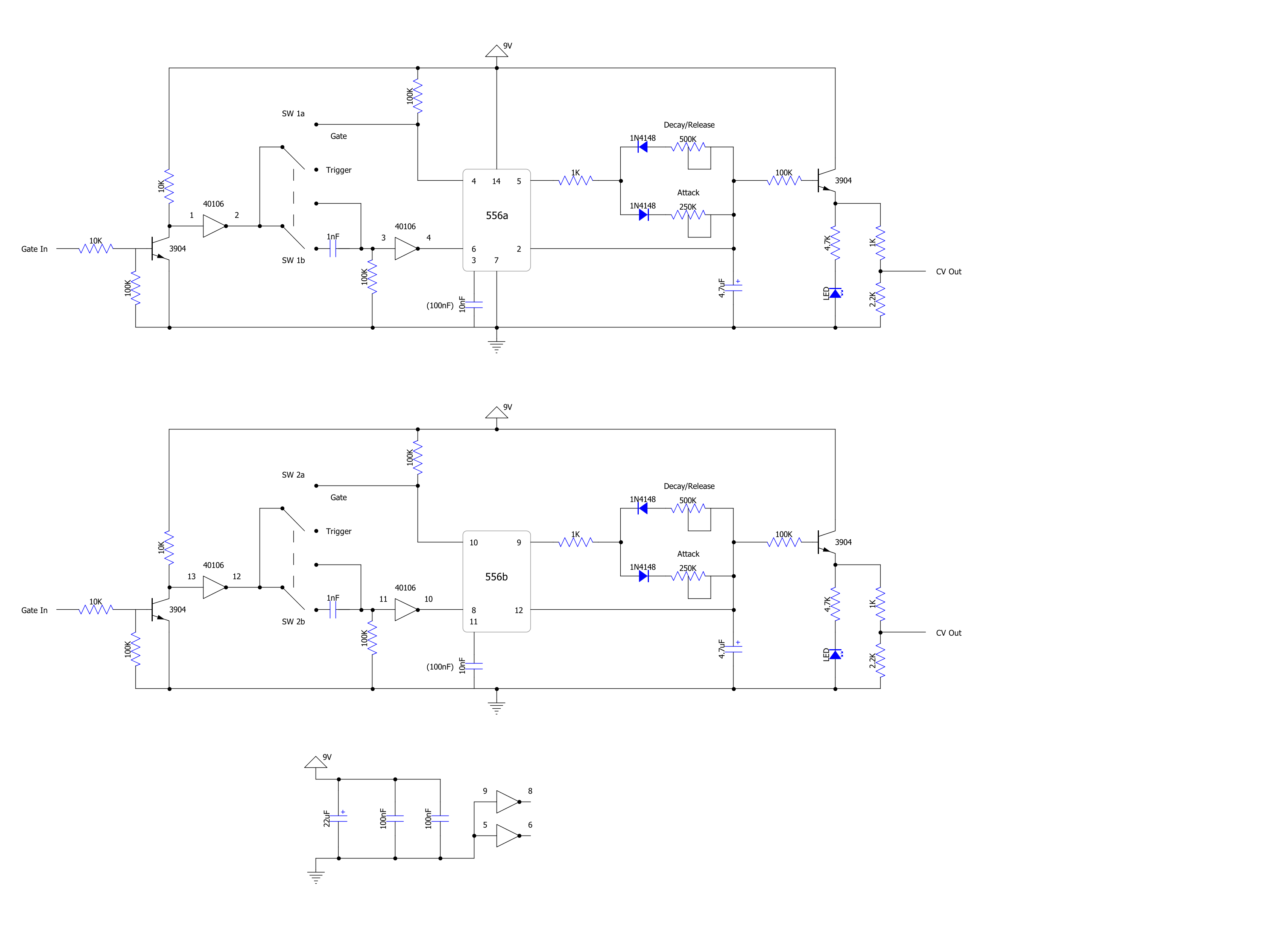

Hi all,
I have one of PHOBoS's 555-based AD/AR on breadboard, but 2 things are happening with it that I don't 100% understand:
- The attack knob influences the maximum voltage the envelope generator can put out, and;
- I expected the threshold to be around 2/3rds of the supply voltage (9V in my case), but when the attack knob is fully fast, the output consistently hits 8.54V.
The range of output on the attack knob varies between a bit over 6V on the slow end and makes it's way up fairly linearly to that 8.54V on the fast end. Is this normal behavior for this type of circuit? Assuming it won't hurt anything, the high output isn't a big deal, as I'm using a voltage divider on the output anyway... the overall output thing is a bit weird, though certainly not world ending (it's a feature? Very Happy )
I'll just note that while testing, I'm using a CMOS 556 with the unused side having its reset pin tied to ground.
Here's PHOBoS's circuit re-drawn. The only thing I didn't have on hand was a 10n capacitor for the CV control, but I've tried values above and below it, as well as tying it directly to ground and it hasn't effected anything. I've been taking the measurements mentioned above at the leg of the 100k resistor attached to the timing capacitor and attack & release pots.

PostPosted: Sun Oct 06, 2019 5:33 am    Post subject: Re: 555 AD/AR issues Reply with quote  Mark this post and the followings unread
I haven't used it with a 556 but that shouldn't make any difference. Also this version works the same with either the regular
or CMOS version so that shouldn't cause any problems either.
This sounds like the impedance of the output transistor is influencing it. If you think of it as a resistor it will form a voltage divider
with the attack pot. So the higher the value of the attack pot (slower attack) the lower the ouput voltage will be, which is the behaviour
you describe. Since you have it on breadboard you could test this by leaving out the transistor stage and measure the voltage over the
capacitor to see if the voltage still changes depending on the attack pot setting. Because the value of this pot is fairly high it is possible
that the meter might cause a very slight variation in the voltage but it shouldnt be much.
Does this happen in both AD and AR mode ? In AR mode this is expected behaviour but in AD mode it should indeed be 2/3 of the supply voltage.
This image (from the most excellent, highly recommened 555 tutorials) showing the 555 internals is very useful in understanding why.
ignore the external components as the 555 is not used in astable mode for the envelope generator
Assume that at the start the timing capacitor (the one connected to the treshold input) is dicharged. When the 555 receives a voltage lower
than 1/3Vcc (set by the lower comparator) on the trigger input the internal Flip Flop wil be SET. As a result the output goes high and it charges
the capacitor. In AD mode the trigger input only receives a short pulse so once the capacitor is charged up to the treshold level of 2/3Vcc (set by
the upper comparator) the internal Flip Flop is RESET which causes the output to go low and discharge the capacitor. (Attack, Decay)
In AR mode it's a bit different. If the voltage over the capacitor reaches 2/3Vcc but the trigger input is still <1/3Vcc the internal Flip Flop stays
SET. Since the ouput of the NE555 is almost Vcc the capacitor gets charged further up to this voltage (minus a voltage drop because of the diode).
Only when the trigger input goes above 1/3Vcc will the Flip Flop be RESET again and the capacitor dicharged. Note that in AR mode the Flip Flop
will also be RESET (through the reset pin) when the input goes low even if the voltage hasn't reached 2/3Vcc yet. (Attack, Release)
I had noticed this behaviour before and made a different version which I used in the Moon Base Xplorer
With a +12V supply the 555 will only charge the capacitor to about 8V (2/3 x Vdd) before it discharges it (in AD mode). But I wanted 10V,
which I could have done with the opamps, instead I just raised the treshold level by adding a pullup resistor to the CV input (pin 5). To make
sure the voltage doesn't rise above 10V (in AR mode) I added a zenerdiode.
The levels (treshold/limit) are very close together, I've build 2 of these and while 1 worked with a 47K pullup resistor the other one still didn't
work with a 51K resistor. (solved it by adding a 1M pulldownn resistor aswell). So it would probably be wise to use a trimpot instead.
note that these resistor values are for the CMOS version, for the regular version they will have to be much lower.
btw, the LEDs seem to be drawn reversed in your schematic.

PostPosted: Sun Oct 06, 2019 6:18 am    Post subject: Reply with quote  Mark this post and the followings unread
I'll report back in once I can sit down at the breadboard, but I think you've probably nailed it.
I don't have an oscilloscope, so I've been using a standard multimeter to measure the output. Since it's not fast enough to catch the peak in AD mode, I've only been measuring in AR mode... I guess that explains the high output! I did try using a zener as you did in your Moon Base Explorer, but it dropped the voltage significantly below the target. Perhaps, though, that was a side effect of what you described with the transistor.
As for the attack controlling the output, I did in fact measure without the transistor in, but I think I had something funky going on with that particular row on the breadboard (ie it was being shorted to the row next to it with the voltage divider)... I have it moved to the other side of the breadboard now anyway, so I'll double check it once I get home.
Thanks for posting that info about the 555... it completely makes sense now.
I was thinking of dropping the output transistors in favor of a voltage follower as in the circuit your just posted, thinking I could use the leftover parts of a lm324 to either make invertors as you did, or as a comparator on the output to use for re-triggering. Assuming dropping the transistor fixes the problem, I guess that's the way to go.
A quick question... it's safe to assume that the zener has to be at or above the threshold voltage, otherwise the AD mode wouldn't function correctly, right?
(and yes, I drew my LEDS backwards... sorry! Very Happy Very Happy )

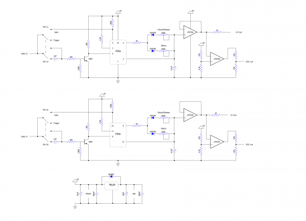

I've updated the schematic with the input section from your Moon Base Explorer and LM324's buffering the outputs. I tacked on the other 2 op amps as comparators which go high at the end of the cycle, although I'm not sure if I've done that properly and haven't yet breadboarded that part.

Posts: 1319
PostPosted: Fri Oct 18, 2019 12:54 pm    Post subject: Reply with quote  Mark this post and the followings unread
I would place the input of the comparator directly over the 4.7uF caps so there is no interference caused by the following circuit plus the input offset currents of the two opamps may cancel out eachother.

PostPosted: Fri Nov 08, 2019 6:53 am    Post subject: Reply with quote  Mark this post and the followings unread
Hi Grumble, thanks for your input! Sorry it took so long to post a reply... I couldn't work on my stuff for a bit, so I couldn't get back here with anything to report.
I decided to toss everything onto vero, hooking up that last comparator as you said (off the timing cap + attack/release knobs). Everything works wonderfully, EXCEPT (had to be something!):
When I plug the end of cycle (comparator) output back into the input in trigger mode, I can re-trigger the 556 and use it as an LFO... up until I turn the release knob more than halfway, when it suddenly decides it doesn't want to trigger anymore. I've checked:
- The comparator does actually go high when the cycle ends. (measures 4.7V)
- Hooking the comparator after the voltage follower doesn't change anything.
- Hooking the output of the comparator to other modules generally works as long as the release is not turned to high... when it is, things start acting funky, ie. the first division on my divider doesn't want to light up, first output of my 4015 doesn't light up, etc., while clocking off the comparator.
Do you guys have any idea what could be causing this? Lack of current off the voltage divider? Dirty output (I don't have a scope)?
