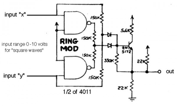

Does the 4011 chip in the ring mod schem need to be of the unbuffered type?
I tried it with a buffered chip, (only one I have atm), but didn't notice much of difference in sound, although it was a bit louder.
I inputed two 4069 VCO's and only noticed a slight difference in sound, nothing like the ring I should be getting.
Also my understanding of ring mods is you need to use 2 different inputs, like 2 VCO"S or other OSC's, you can't use the
same VCO into both inputs, is this correct?
Schem I'm using:
 Filesize:  24.56 KB
 Viewed:  20607 Time(s)

The schematic you show with the four 4011 gates is really XOR. I am not sure what effect the diodes on inputs would have.
For pseudo-ringmod, I like to use the 4030 or 4070 or 4077 chips (XOR and XNOR)--that only requires one gate. Then, you can combine more XOR gates together in whatever configurations you can think of.
Another approach is four diodes in a bridge-rectifier square.
Replace the 4011 with a 4093 (Schmitt-input NAND gates) for yet another variation.
If you are feeding in the 4069 triangle oscillator, it might not come out according to the textbook XOR binary/boolean function. However, in Lunetta land, anything goes--just report here any interesting surprises!

i'm pretty positive the schem you posted is the circuit i put in my lunetta. you get the more classic ringmod sound when you feed hi frequency square waves in to the input, and then modulate one or both inputs. the diodes are there so no current is feeding back into the oscillators. i believe i used a buffered 4011 hence the little o. don't know if it makes any difference.
personally I never really understood why everyone keeps using the 4011 ringmod, it's just a complex way of making a XOR. You can get a 4070 for the same money and have 4 of them.
no this is not correct. A ringmodulator fed with the same signal on both inputs is a frequency doubler.¨Not sure if this applies to the 4011 "pseudo" ringmod.
As you wrote, this is a pseudo ringmod. If you look at the binary truth table for an XOR it does a binary multiplication of sorts, but it receives only two states and outputs only two states. A true audio ring modulator is an analog multiplier chip. So while the two are related by the multiply operation, the similarity ends there. Also, the theory behind frequency doubling with a ring mod comes from the trig identity surrounding sin(x)^2 and sin(2x). This means that the frequency doubling is purest when the inputs are both the same sine. Waveforms that differ from sine have less and less frequency doubled output. As such, we cannot expect the 4011 version to do all of the things that are described for an analog ringmod. The 4011 or XOR type is useful, just very different. Also, within the frame of analog multipliers there are 3 kinds - single quadrant, two quadrant and four quadrant. Only the four quadrant type is a true analog ring modulator.
It should also be noted that the term "ring" comes from the original circuit which was used in radio electronics to mix RF signals. It was composed of a transformer connected ring of diodes. The term has nothing to do with a ringing sound. This type of ring modulator has been used by some in synth electronics, the main complaint being that you need special diodes and a large input signal. The effect is also different from a four quadrant multiplier.
I have build some classic ringmodulators mostly for Shortwave radios and I was experimenting with "real" ringmods for audio. One input an Yamaha organ and the other a sinewave from a audio signal generator made nice bell sounds.

Analog ringmods are often used to make bell-like sounds because of the harmonics they produce.
This is also true of FM used for bells.
However, in both of those cases, there is no ringing as there is in a real metal bell.
With a metal bell, you strike it and then it rings out from resonance. It needs only the impact energy to ring. An FM or ringmod created bell circuit won't do that, it requires the input remain and then an EG and VCA are used to cause the fade out.
The "ring" sound that you don't hear from the XOR version is because it isn't producing the harmonics that make the real ringmod sound bell-like.
It is unfortunate that the term "ring" is applied because it is quite confusing since it has two meanings in this context which is why I gave a bit of it's semantic history.
