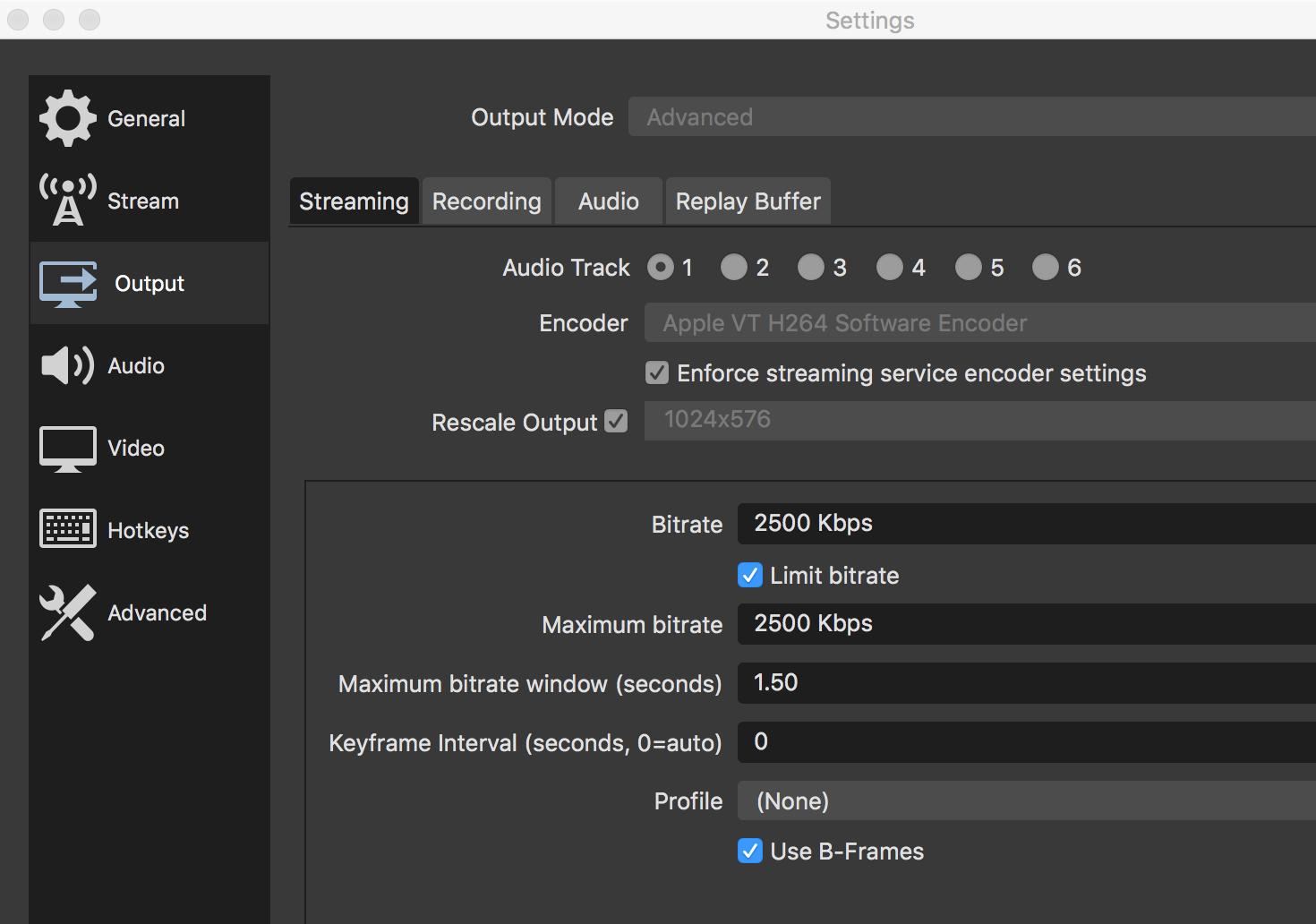

PostPosted: Fri May 22, 2020 7:51 am    Post subject: Video encoding (Mac) Reply with quote  Mark this post and the followings unread
I've had good luck with the generic x264 encoder and the Apple Software encoder (pictured below).
I have not had much luck on the EM server with the Apple Hardware encoder, even though that is what I typically use for all other platforms. During my initial exposure to all this, the hardware encoder was recommended.
In any case, I seem to have a working method.

PostPosted: Fri May 22, 2020 8:15 am    Post subject: Reply with quote  Mark this post and the followings unread
I'm likewise using the generic x264 encoder on Linux, with stable results.
Hardware encoding does not seem to be an option available to me -- my choices are x264 or ffmpeg.
