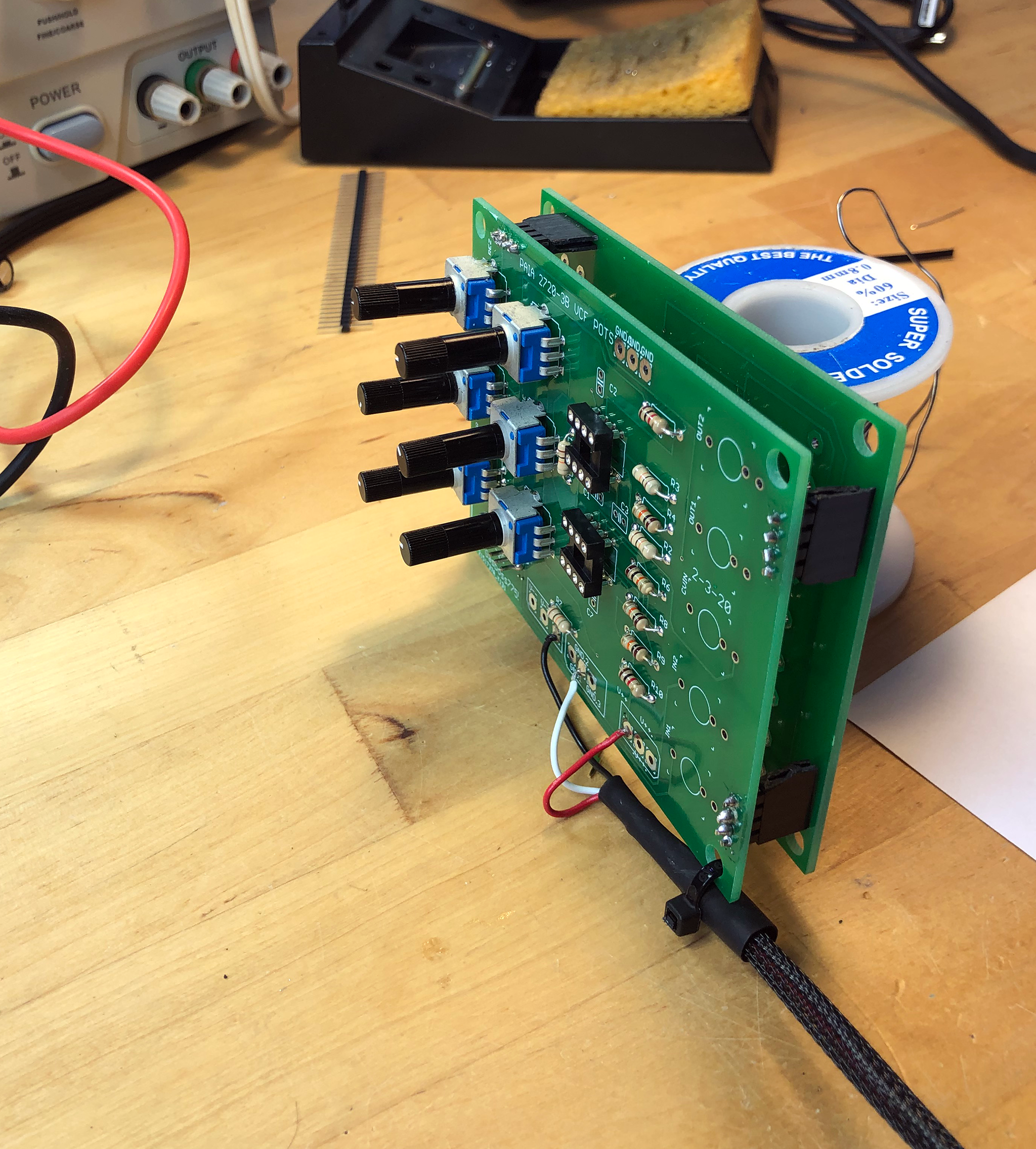

Gang:
I have built the filter using custom PCBs. I used "tall trimmers" and "skiff" construction, and it's all working.
For this v2 I am using a 2nd board to set CV bias, which IMO really helps control the filter's sweep.
Problem: on both versions of this I am having the same issue, what I call "audio bleed". Some of the initial unfiltered signal, very audible, is turning up at output.
I have enclosed a sound clip. You can hear the "ring" of the bleed pretty clearly after the filter has closed.
Anyone know how to stop this? I have checked my work a few times, can't find a mistake. My analog design skills aren't good enough to know where this bleed is coming from, but some of the unfiltered signal is obviously making it from input to output.
I can't remember if the initial paia filter had this issue, but perhaps it did.
(You can circumvent this by gating the filter output, using a 2nd filter in series, LP works or just adjusting VCA envelope to close before the filter. But overall I'd like to solve this somehow.)
BTW: I changed R9 to 27K; input audio resistance to 3M for one input and 1.5M for the other. R12 was change to 68K. I am using +/- 15V. the size of LED doesn't for me make that much of a difference. Besides that, it's an exact copy of GASBOSS's linear current design, with an additional couple of op amps downstream from CV in to set the CV bias relative to ground.
One way or the other, I am going to work on this more and then will post more details on blog incoluding a lot more sound clips.
Thanks in advance for any help....
Here is the unit, yes, no ICs, these were removed for testing a few things. The build uses 3x TL072
 Filesize:  5.7 MB
 Viewed:  410 Time(s)
paia2720-audio-bleed.mp3
What can I do to make this ringing "bleed" sound go away?
 Filename:  paia2720-audio-bleed.mp3
 Filesize:  269.43 KB
 Downloaded:  541 Time(s)

@cslammy:
Nice to see such a professional looking implementation of this circuit, probably better than the PiAI original!
It's been awhile since I worked on this but I seem to recall that it wasn't possible to completely shut off the signal with this filter as the cut off range couldn't go that low. You could experiment with different capacitors in the branch of the circuit connected to the controlling LED but you would probably sacrifice some of the higher end of the cut off span.
Gordon.

gasboss775 wrote:
@cslammy:
CL: For what it's worth I have compared the modified 2720 here to other synth bandpass filters including some from the current big-bucks, load-up-your- credit-card-the-bank-will-love-you modular mfgrs.
Bandpass filters, even the really fancy ones, seem to not always close all the way, this one appears to be no exception.
I need to finish a front panel for this and make a few other tweaks, but your cap values etc. seem to be spot on....Cap and resistor wise I can't improve on the sound from the values you have now. Nice work!

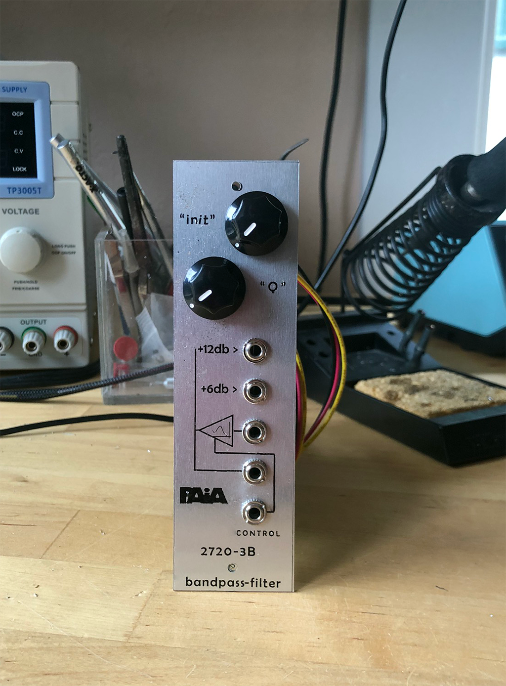

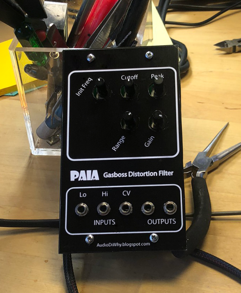

PostPosted: Mon Jun 15, 2020 6:29 am    Post subject: Filters done Reply with quote  Mark this post and the followings unread
OK--done w/ this I think, I've finished my build of Gasboss's 2720 mods, also I went back to orig paia schematics and built one of those that works on +/-15V.
blog post about gasboss' design and orig PAIA filter repop: https://audiodiwhy.blogspot.com/2020/06/paia-2720-3b-filters.html
Website: https://www.charlielamm.com/gear/vcf/forums.html#2720
Sound clip: https://soundcloud.com/cslamm/2720bandpass-final
