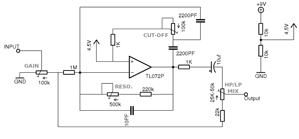

kaputtpanzer
Joined: Nov 02, 2009
Posts: 139
Location: Cologne
Audio files: 15
PostPosted: Mon May 21, 2012 7:22 am    Post subject: Reply with quote  Mark this post and the followings unread
I made a good sounding filter for use with cmos and 9V batteries. It's based on the wsg/dronelab filter and it has a hp/lp mix pot.
I think it is possible to replace the 4,5V connection, at the non-inverting pin, by a CV input.
 Filesize:  41 KB
 Viewed:  2622 Time(s)
9v_filter.mp3
The input signals for the filter are 4 squarewave oscs feed into 2 XOR gates.

garcho
Joined: Sep 28, 2011
Posts: 41
Location: Richmond, VA
PostPosted: Wed Jun 06, 2012 10:01 am    Post subject: Reply with quote  Mark this post and the followings unread
Thanks Kaputtpanzer, I'm going to breadboard this soon!

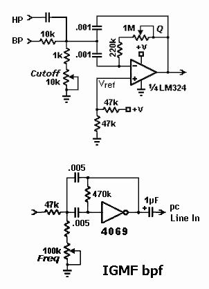

richardc64
Joined: Jun 01, 2006
Posts: 679
Audio files: 26
PostPosted: Fri Jun 08, 2012 2:35 pm    Post subject: Reply with quote  Mark this post and the followings unread
Here's one I like a lot.
The 4069 version could have a Q Resonance pot and HP/BP inputs like the 324 version. Play with the cap values.
 Filesize:  5.94 KB
 Viewed:  35080 Time(s)
JingleJoe
Joined: Nov 10, 2011
Posts: 878
Location: Lancashire, England
PostPosted: Sat Jun 09, 2012 5:24 am    Post subject: Reply with quote  Mark this post and the followings unread
I assume all those cap values are in microfarads? So that's 1nF caps used in with that op amp?
textual
Joined: Dec 05, 2009
Posts: 78
Location: New York City
PostPosted: Sat Jun 09, 2012 8:59 am    Post subject: Reply with quote  Mark this post and the followings unread
pretty sure those are 1n, Joe

richardc64
Posts: 679
Audio files: 26
PostPosted: Sat Jun 09, 2012 10:52 am    Post subject: Reply with quote  Mark this post and the followings unread
Jeeze. I had no idea decimal point cap values had become arcane.
.1uF=100nF
.01uF=10nF
.001uF=1nF
Here's some short samples of the 324 filter with white noise as input. Caps were 560pF and feedback R was fixed 680K.

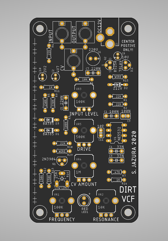

PostPosted: Sat Oct 24, 2020 10:04 am    Post subject: Reply with quote  Mark this post and the followings unread
I will bring this topic back from the dead because I built a nice little vcf, which sounds very dirty and gritty. It is not crazy resonant, but just resonant enough. I started messing around with this circuit when I breadboarded the moduletta vcf last year.
Dirt VCLPF is a very simple inverting twin t filter with a drive/gain stage. You can Ignore the lower part, it is just my power supply. Just connect VCC with 9V or 12V and it will run fine. Maybe put some filter caps between VCC and GND, because this filter is very sensitive to shitty wallwarts which will introduce some noise to the output signal.
R16 is a 20/50K trimmer to limit the lowest cut off frequency

garcho
Posts: 41
PostPosted: Sat Oct 24, 2020 11:15 am    Post subject: Reply with quote  Mark this post and the followings unread
Bravo, looks like an easy build, one for the breadboard list, you can never have enough filters Smile

kaputtpanzer
Posts: 139
Location: Cologne
Audio files: 15
PostPosted: Sat Oct 24, 2020 1:24 pm    Post subject: Reply with quote  Mark this post and the followings unread
Hey Garcho,
it is an easy build indeed, if you skip the drive stage it gets even easier.
Speaking off ics... I just found out that the SSI2144, which is the clone of the legendary SSM2044, can run off 9V (-4/+4V minimum voltage).
I have also a multimode VCF (LP/HP/BP/NOTCH) in the queue and I will share the schematics the next months. It is a weird combination of an Oberheim SEM VCF and a WASP VCF.
This is a render from my VCLPF PCB.
