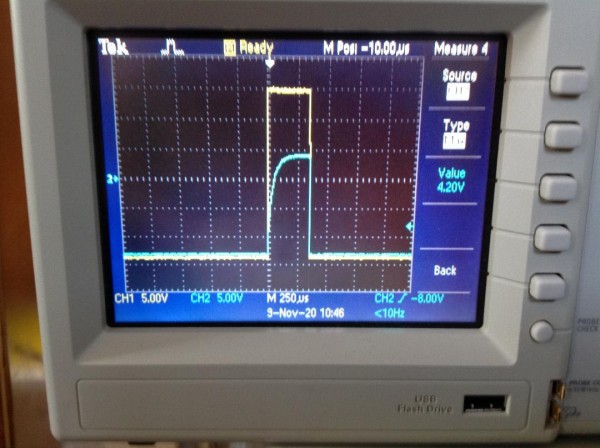

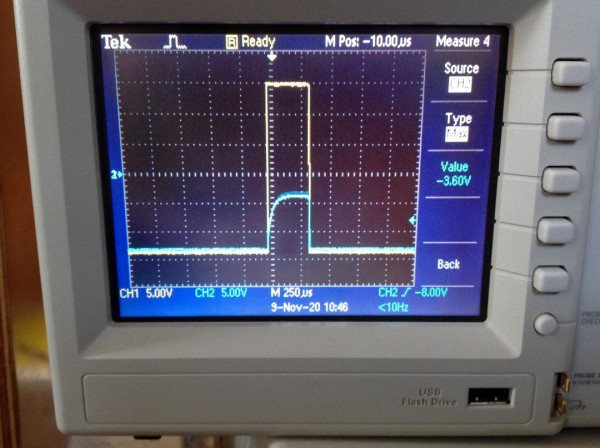

So I measured the gate signal. Two photos attached. The yellow trace is U2-pin 14 (the gate signal produced by the internal clock...it sits at -15V until a rising edge comes along on U2-pin12, and then pin14 goes to +15v for about 350us). The blue trace is the node at R14, D3, and the FET gate. It sits at -15v also, but the voltage when gate is high varies!
The FET gate signal (blue) changes in amplitude when "high". It ranges from about +4v to -4V. It tracks the S&H input voltage fairly closely. In my test, the S&H input is a slow triangle signal (shown in the previously attached photo where the S&H isn't tracking well on the falling slope). The FET gate signal peaks fairly closely to the triangle wave voltage during the "high" gate signal.
Is this what the FET gate signal is supposed to look like? Is the diode D3 doing its job correctly? I am not skilled enough at circuit analysis to know if the signal at the FET gate terminal is correct in my circuit.

Yes, when U2d.pin14 goes high that signal is blocked by the diode, allowing for R14 to let the gat go to the S&H input voltage, which makes the FET conduct.
350 µs seems like plenty enough time for the FET to go into conductance mode, as the flattening of the blue line shows (the 2M2 will have to cgharge the FET input capacitance and also the input capacitance of your probe, so without a probe it will be faster even).
The scope traces also show U2d.pin14 to work ok.
Sooo .. next question is .. what happens at U2a.pin1 ? hmm .. the blue signal actually tellsus that, it seems to be fine too.
Leaves only that FET to be suspect IMO.
Let me look at the data sheet for the J201, had look at the BF one only, ok ... looks like that one should just work too.
