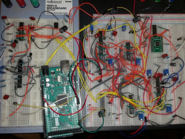

Hi, I am currently designing a double VCO XR-2206 based synth.
It works pretty well.
Instead of controlling the osc. frequency by CV,
i decided to use discrete R levels for pins 7 and 8, implemented by
X9C102, X9C103 and X9C014 digital pots and a trimmer pot, for each subosc.
I would go to the route of using a digital pot everywhere for control, trimmer pots aside.
The switching times on full range of the X9Cxxx pots is on the order of less than 100ns per step
so it does not seem audible when switched as fast as possible by the Arduino.
The other advantage is saving the pots configuration in case of power failure (each pot as a non-volatile memory, but with a duty life of only 100 000 cycles per bit of memory (each pot has 7bits)
Other than that an Arduino would require controlling DACs to output many CV, which would be more costly, I think.
The absolute tolerance of these digital pots is advertised to 7V DC, and a few mA (4 mA I think)
in terms of current, the ltspice simulations do not show any large currents flowing.
this setup is duplicated for the second XR-2206 chip.
The digital pots are controlled by a MCP23017 demultiplexer, itself controlled by an arduino mega.
Then I implemented hardsync.
In the current setup both XR-2206 chips are self-keyed to obtain a triangle/saw output.
The master VCO sync (0V to Vdd square wave) signals follow the high going SAW/TRI output of the first subvco (with a level of Vdd) and the low going SAW/TRI output of the second subvco (with a level of GND since I use a single rail psu)
in order to retrigger the slave VCO, I need to supply an inverted sync signal orginating from the slave VCO to the keying output.
Supplying this inverted signal is done through a SPDT switch (ADG333A) controlled by the master VCO sync signal, either supplying the non inverted slave sync signal or the inverted slave sync signal (passed through a schmitt trigger inverter (CD40106B))
As of today, the master VCO is not retriggered by noteon MIDI signal, As well, there is no audio routing and switch between self-sync, external sync (sub-osc select), hard sync for both VCO chips. Only hardsync of self-synced master vco to self-synced slave vco on the prototype breadboard.
Although the EDA project is more advanced on the EasyEDA page.
For the results, the sound is analog sounding, and the SNR on the breadboard is 24dB, so it is quite noisy but this is due to not really careful construction.

Attachments to the project
Breadboard project with Dual VCO, 555 envelope and LM13700 VCA
 Filesize:  2.87 MB
 Viewed:  556 Time(s)

A quick update.
Now that MIDI is working, I put the synth to test in order to check that the digital pots were working ok.
The potential problem with them is that they do not give feedback on the values they are set in digitally. and I provide a wiper change value, not a wiper position value. State has to be maintained by the Arduino.
However, they can be setup to remember their state at power off.
So it was critical that they do not miss a change of values or the whole thing would get out of control fast.
For now, I ran a midi pattern loop for 1 hour and it did not flinch.
Another note on the XR-2206, The datasheet indicates that the frequency of oscillation is 1/RC, From my tests, it does not seem to provide good results. so I had to sample all notes from C3 to C7 and run a curve fitting in python to get a polynomial equation for each sub oscillator. It works better.
That would make the XR-2206 worthy for a general note based synth and not only for fx.

I managed to improve the auto tuning based on the cd4046 pll chip.
Since the phase shift comparator 1 output basically measures the beat frequency between the oscillator and the reference pwm frequency, but, outputs a triangle waveform, I just fed the output into a schmitt trigger opamp circuit, and used Arduino freqmeasure library to get the frequency and then used the digital potentiometer tuning algorithm to find the lowest beat frequency.
Now I am getting a precision under 2 cents, limited only by the resolution of the 1k digipot.
the cd4046 phase comparator I output is a bit noisy, so I passed it through a low pass filter with a cut-off just above the max beat frequency expected between the tuning of one note to the next at the higher end of the tuning range that is, f(C7) - f(B6)

The two XR-2206 IC version of the synth is now controlled by an Arduino Due.
computes faster, and has plenty of SRAM that was going low on the Arduino Mega 2560.
Also, added a Winbond Flash 32 mbits module to store data. The Due also has two 12 bit DACs that may prove handy.
I was thinking of using a realtime OS like FreeRTOS but the quanta of time is quite long. I primarily intended to use it for updating the DAC values while doing other tasks but I may have to write a custom scheduler, or use a dedicated MCU for DAC management.
Also used a JFET (J112) driven by an op-amp differentiator (using one of the SYM pins of the XR-2206 as input voltage and the other the AD enveloppe voltage generated by the 555 AD enveloppe) to provide sine to triangle waveshapping on one of the XR-2206 chips.
But I have Not enough space anymore to expand the project without it being unmaintanable.
Now I guess is time to write it all down and finally prepare a PCB.
What you can hear is the result of the two OSC mixed, one is one octave above the first, and I used midi controls through the sample to alter the mix between the two oscillators. Wave shapping on OSC1 (lower octave) is driven by the VCA AD Enveloppe.
The characteristic glide you can hear comes probably from the capacitors on the DAC lines
The pulse width is set at 0.25 for boths OSCs
Also the DAC to provide fine tune is a 4in1 MCP4728 module, previously a MCP4725.
