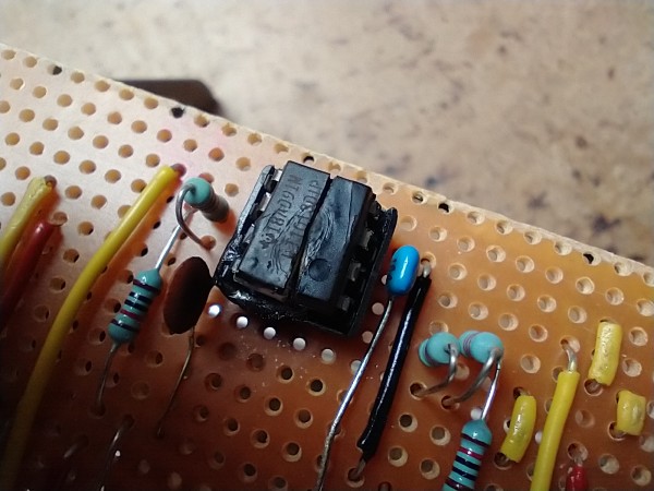

When you smell burning, turn it all off and keep looking until you find the source:
 Filesize:  827.41 KB
 Viewed:  204 Time(s)

I know that smell, did it smoke too ?
These days I often do a quick test where I use my fingers to check if anything gets warm after powering up. Also measure for shorts before powering up.

Oh yes, smoke. It was actually a module already in my synth, a simple fixed voltage source providing +1V, +2V, +5V, and -1,-2, -5. Hence the use of the LT1013. Not sure what happened, it worked fine for years, suspect I shorted the output (though the opamp is meant to withstand a short indefinitely).
Bit disconcerting to smell burning from the cabinet, open it up, and see smoke!) Fortunately no other modules were damaged. The power supply was pretty hot though.
