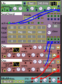

I don't quite have the idea of the outputs yet, it seems like the first chord affects multiple outputs while the second chord has no effect. Does the module actually step through the chords? I haven't figured that part out yet.
I've attached a screenshot of what I have so far.

I should step when connecting a clock to the gate input. The active inputs are there to be able to make steps (in)active.
Edit: undo that ... it works differently ... will come back with an example after figuring out what it actually does Shocked

Ok, this seems to be like I intended it to be used ...
Edit: Updated the help text for the module too, this wil be in the next release, and for now can only be seen @ https://bluehell.nl/wren/modules.html#1216

It seems like the four outputs send the same signal? Are they there to work with the chain inputs in the top right of the module?
edit: Just saw the help text...I think that explains it. Thanks again!
