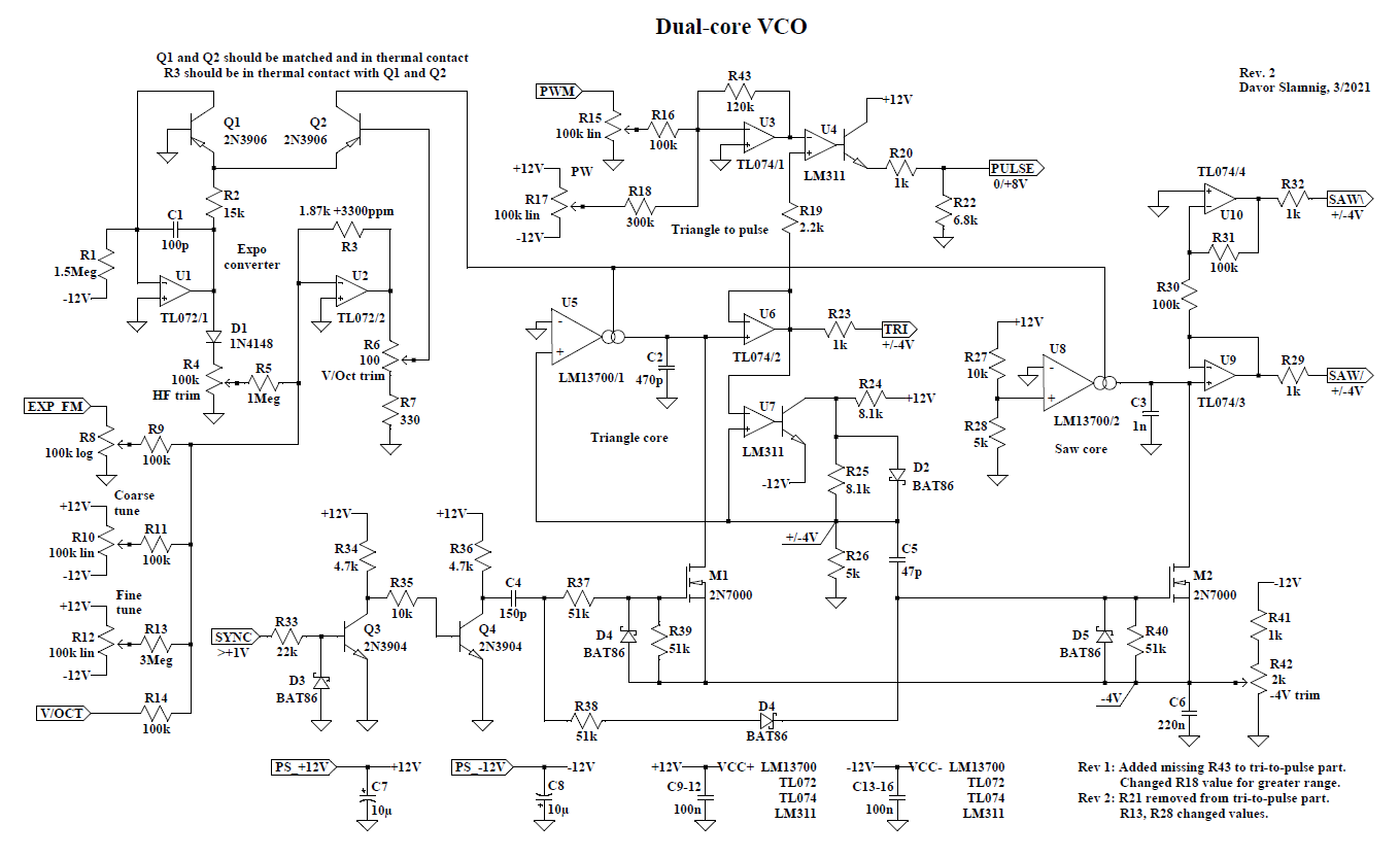

This is my first VCO design, I thought I'd share it with the group hoping for comments, suggestions, advice. It's still on the breadboard, there's still time to change it for the better.
I've started out with the Triangular/Square-Wave VCO example in the LM13700 datasheet (https://www.ti.com/lit/ds/symlink/lm13700.pdf), thinking about making a simple LFO. But the project kept creeping all over my breadboard, turning into a full-fledged VCO, dual-core at that. Now I'm running out of connector wires which is a sure sign of maximum circuit complexity - time to wrap it up.
I've tried to keep things as simple as possible, cutting as many corners as I could while maintaining good waveforms. In the end it's not as simple as I'd like it to be, but I did manage to keep it down to 2 OTAs, 2 comparators, 6 opamps, 2 FETs and 4 BJTs. For that you get triangle, variable pulse and rising and falling ramps (because I'll be using it as a LFO, too, and there's no way to get deep space proximity alert alarms right without both). Also there's hard sync on all waveforms. The frequency range is about 0.1Hz to 25kHz, good enough for my old ears.
Triangle core
The triangle core is classic, with the LM311 comparator as the polarity switcher. I didn't want the slew rate of an opamp here, and I especially didn't want to fiddle with a discrete BJT Schmitt-trigger. LM311 is pretty mediocre as comparators go, but it has an open emitter output which proved to be very useful.
Saw core
Tri core up and running, I tried out a couple of tri-to-saw conversion methods and was not satisfied with results. There's always a connection glitch in the middle, and the slope of the jump from one to the other polarity is so-so. So I added a saw core which is slaved to the tri core. It's just a cap charged by an OTA and discharged by a FET on every tri cycle.
Since the discharge has a more-or-less constant duration, there is some drop in saw peak-to-peak voltage at high frequencies, >10kHz. The same thing causes "normal" saw cores to go flat at high freq. But since the master core is triangle, this VCO has very good tracking - with some saw amplitude loss as a tradeoff.
Triangle-to-pulse
The tri-to-pulse circuit also uses the LM311 which despite mediocrity does better switching than an open-loop opamp. The pulses are 0V to +8V, IMO better for LFO triggering and sync than zero-centered pulses. The open emitter output allows it to go down to absolute zero, would not be possible with collector output.
Sync
It took me a long time to get the sync part right. For some convoluted reasons I'll not go into here it's not enough to sync only the tri core - the saw also has to get some. But the result is great fat hard saw sync. The synced pulse also sounds great, but it can be hard on the triangle. Tri would benefit from some type of soft sync, but as I said I ran out of wires.
Expo converter
The expo converter is lifted from Tom Henry's VCO-555 (https://electro-music.com/forum/topic-54623.html), with some minor resistor value mods to account for the +/-12V supply and the fact that it was feeding two OTAs in parallel, so I needed more juice. Also, I'm using a 1.87k +3300ppm tempco resistor instead of 2k +3500 in VCO-555. This is a great circuit that worked perfectly right off the bat, all due credit and respect goes to the author.
Please take a peek at the schematic and give me your thoughts.
Rev 1: Added missing R43 to tri-to-pulse part.
Changed R18 value for greater range.
Rev 2: R21 removed from tri-to-pulse part.
R13, R28 changed values.
Schematic updated.

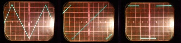

PostPosted: Thu Feb 04, 2021 4:49 pm    Post subject: Waveforms Reply with quote  Mark this post and the followings unread

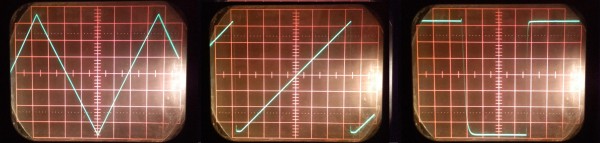

Here are 1kHz waveforms on my ancient Hameg, taken from the breadboard version. Due to the sprawling nature of development there are loads of stray capacitances and contact resistances - I expect things to get sharper when I solder it together. I'll post some audio then.

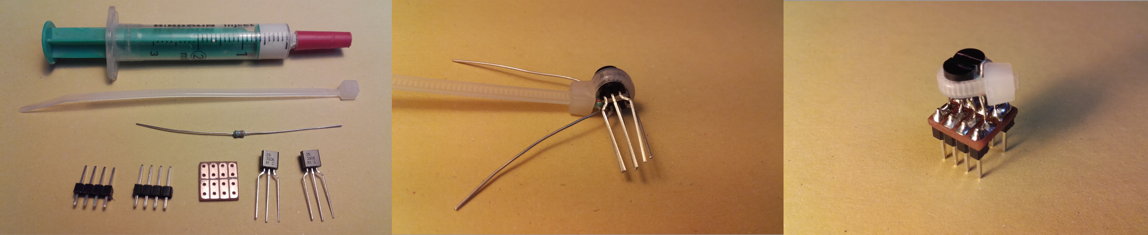

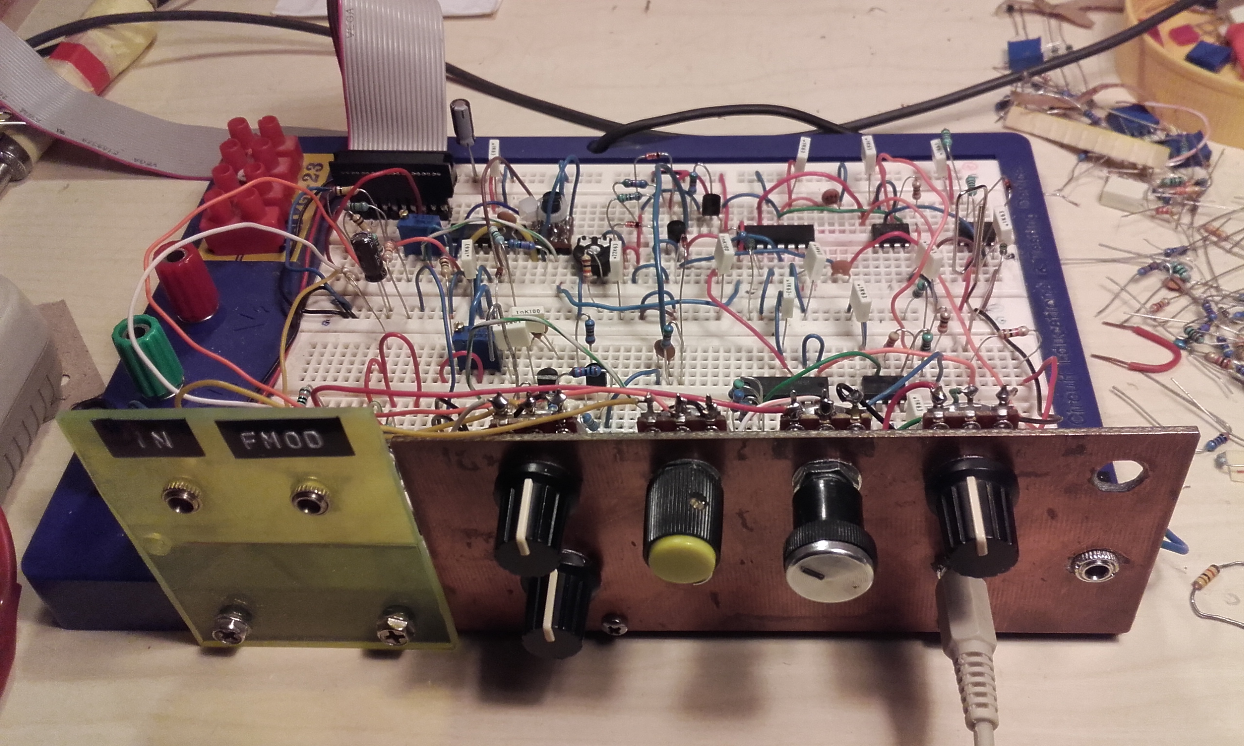

PostPosted: Fri Feb 05, 2021 2:27 pm    Post subject: Expo module Reply with quote  Mark this post and the followings unread
Making the expo module
1. Parts
2. Thermal paste BJT sandwich with tempco on the side
3. The finished product

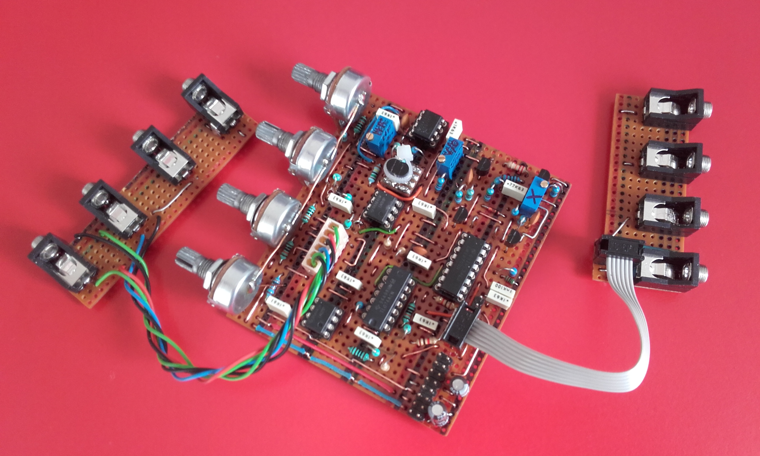

PostPosted: Wed Feb 24, 2021 2:48 pm    Post subject: Soldered Reply with quote  Mark this post and the followings unread
All soldered and still works! As I hoped, the waveforms are much better defined, especially high frequency. I'm getting some CV noise, seems to be coming from the tri cap, the expo module and the input jacks. I expect this to subside somewhat after I mount it on the panel (to be cut and drilled soon), but I'll probably have to put some grounded shielding around sensitive parts.

PostPosted: Wed Feb 24, 2021 3:22 pm    Post subject: Reply with quote  Mark this post and the followings unread
solipsistic ... oh dear ... we can't have that ... hi Slama Cool
Looks like you are building a nice VCO there .. and re. things getting sharper .. the scope pics don't look bad from here?

PostPosted: Fri Feb 26, 2021 8:33 am    Post subject: Reply with quote  Mark this post and the followings unread
always good to see people designing!
big respect for to board-work!
iam a bit confused about the powerlanes, is it point or stripboard?
any chance to see the solderside?
one question: why it is good to have the open emitter on the LM311? I generally dont like them, i always wish those comparators could be more like "normal" opamps - just faster
cheers,gg

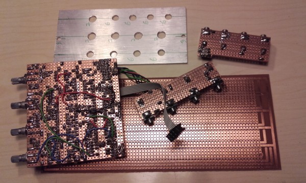

PostPosted: Fri Feb 26, 2021 11:41 am    Post subject: Reply with quote  Mark this post and the followings unread
It's neither, it's a "joint hole" board. I bought a cheap stash of these on ebay, the layout is similar to a breadboard. I'm making one-off prototypes, no plans of going into mass production Wink I spend a night or two figuring out the topological problems, another night double-checking, and 2-3 nights for actual soldering... There's no rushing this, but I'm in no hurry. Backside photo attached - not so nice as the component side, but works ok. Also note the panel in the making.
Regarding comparators, I'm a total newbie, this was the first time I've used them. But the force seems to be with me on this project Wink
In the tri-to-pulse part I'm using the emitter output so the waveform can go down to zero volts. If I'd used the collector output there'd be a positive offset, few tens of millivolts. In the tri core I devised a trick to get +4/-4V output out of the comparator. Note the 5k and two 8.1k resistors, one bridged with a diode, and the emitter connected to -12V, not ground... I don't know if it's original, but IMHO it's neat.

Thanks. The soldered version seems to track fine over at least 6 octaves (enough for my musical expression requirements), thanks to a good tempco, matched transistors and thermal paste. It's comparable to my 3340 VCO, will test some more.
The frequency range is 0.1Hz to 38kHz. The waveforms hold up pretty well at higher frequencies, especially triangle. Pulse is a bit disappointing geometrically, the down slope gets bent, but sounds nice and fat Wink I think I may have botched something in the tri-to-pulse part...
I also measured power consumption, it draws 26mA/+12V and 25mA/-12V. Pretty green as VCOs go.

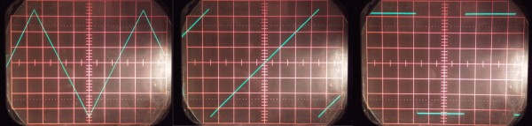

PostPosted: Tue Mar 02, 2021 12:54 pm    Post subject: Reply with quote  Mark this post and the followings unread
4kHz and 10kHz waveforms. Saw is starting to show the cap discharge time, pulse down-slope starts to bend, but triangle stays true.

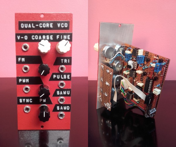

PostPosted: Sat Mar 06, 2021 7:12 am    Post subject: Reply with quote  Mark this post and the followings unread
The Red Menace!
Ok, it's done.
