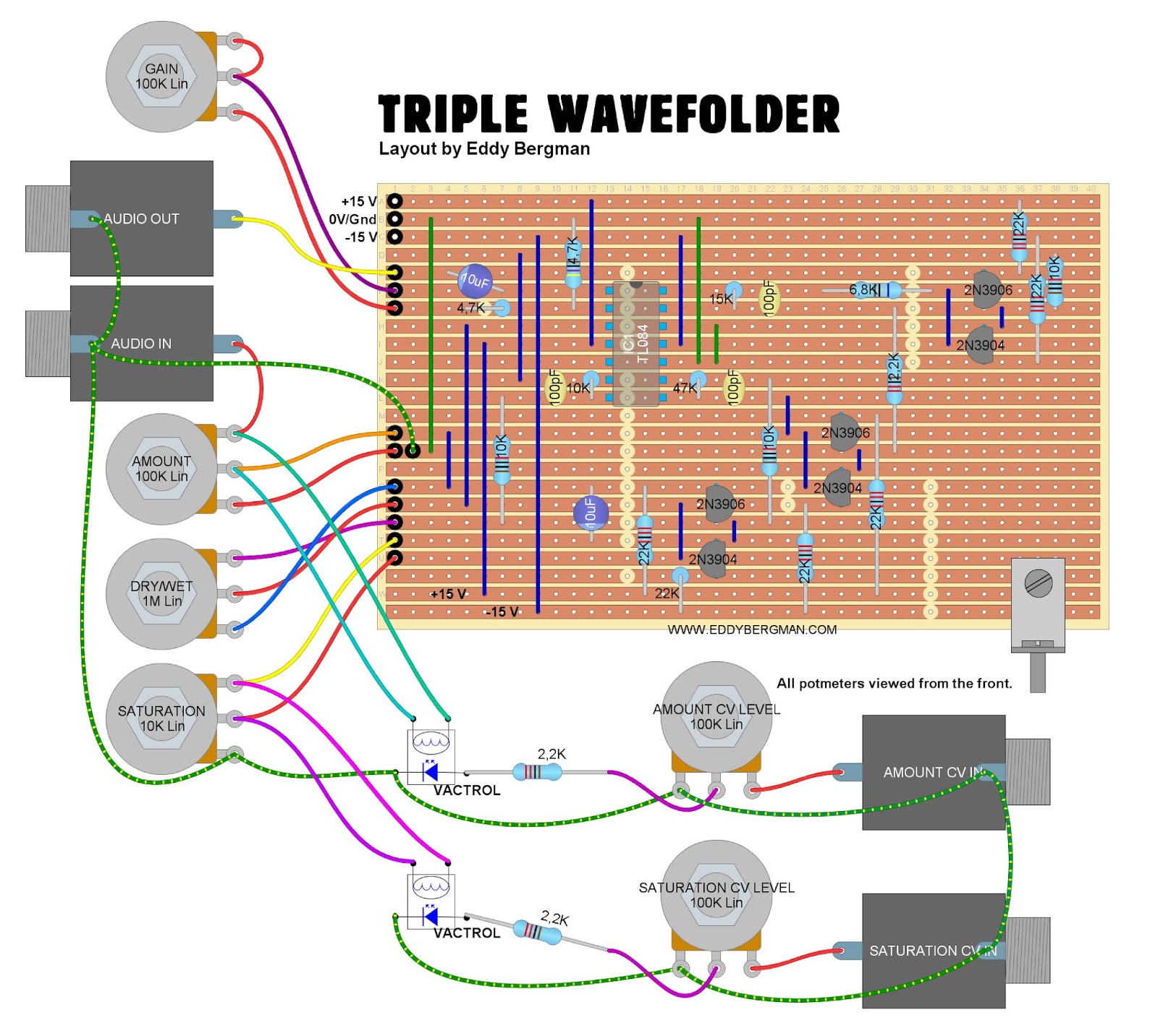

Hi there, I've built a distortion module but now I would like to add a vactrol in order to add a cv control to the drive pot.
I was thinking to use the simple solution that Eddy Bergmann used in the attached stripboard layout.
However I've read somewhere that vactols are not working well if connected to pots that have a big resistance. Being my drive pot an A1M I was wondering if this solution can be applied in my case. What do you think?
If not could you please suggest me another easy to build option?

the problem you migth run intro with a vactrol is the response. With no light the LDR might be in the Mohm range
but even with just a little light it can quickly go into the Kohm range. You could still try it maybe you like the result.

I will do. Thanks a lot!
