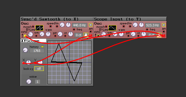

Curious if there's currently a way to get a "traditional" left-to-right oscilloscope in Wren? I see that there's an XY oscilloscope, which is handy for stereo images, but I'd like to have a way to view waveforms in a more traditional manner to see what is happening to the sound over time.
Is there currently a way to do this? If not, I think I'd make that a feature request Smile

The thing sucks a bit .. but what you can try is to connect a saw wave to the X in and the signal to the Y in ... then maybe reset the saw when the signal is near some value ...
Another way is is to use the graphs thing ... F5 to go to the debug screen, make sure that debug settings "Use graphs" is on, then F4 to go to the graphs screen ..then stop audio if it was running (F9) and hit "debug run" in the graphs screen .. but that really is just for debugging things as it is amazingly slow wh lots of points get accumulated ... anyways, that is what I use for debugging signals.

Just an update confirming that this works for now as a way to use the XY oscilloscope as a more traditional one - you'll have to tweak the history amount depending on your input though, and you'll still get weird black lines connecting different parts of the waveform, but it'll do in a pinch.

Yeah it is pretty messy, but indeed can see some things with abit of fiddling.
