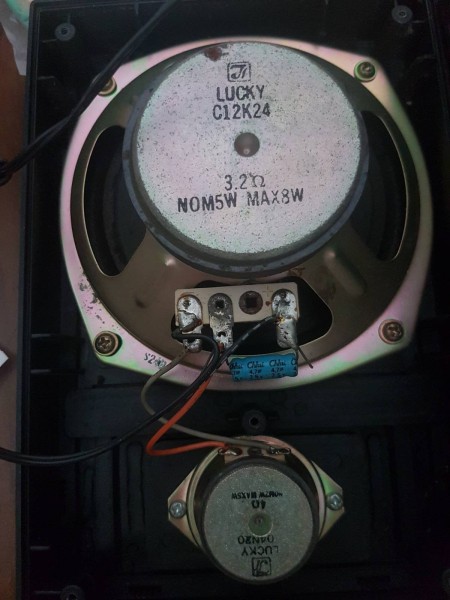

So while cleaning out the basement i found this speaker, without corresponding amp. It’s a nice size, and i thought to turn it into some kind of portable amp, kind of guitar-style amp, although i don’t have a guitar. But i would definitely like to include a preamp circuit strong enough to amplify contact mics and the like. Anyway, the preamp circuit i think i will not have too much trouble, for now there are a couple of fields where i have not much experience, so i will need some help:

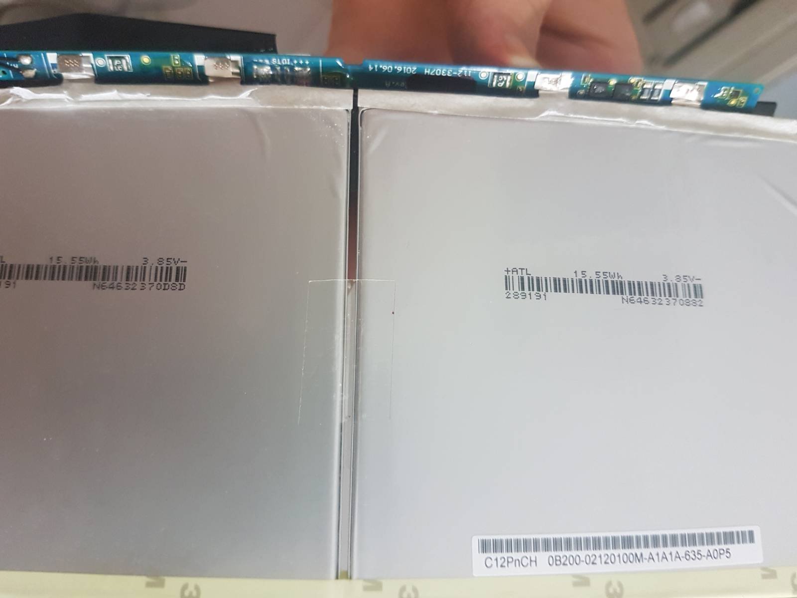

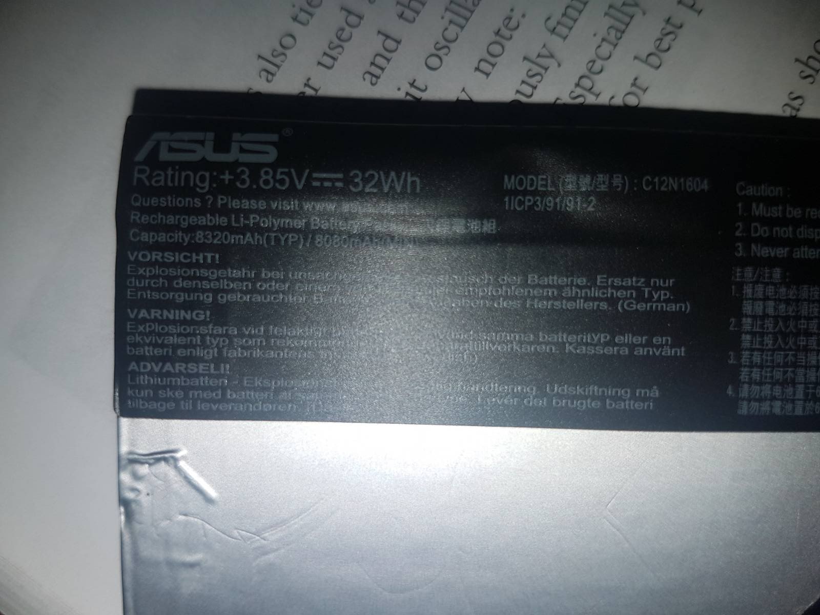

Batteries: So i have this broken tablet, which batteries are still fine though. So i planned to use those for the amp. They are two packs and rated for 3,85v and 32Wh (each block 15.55Wh) and 8320mAh, however, fully charged i measured 4,35V, which seems normal for Lithium Batteries from what i read. With the battery pack there is a little circuit board with a few super small components, but it is very hard to make out what it is. I figure it is some protection circuit, but i don’t think i could connect a usb cable directly to there, since in the tablet it is also not like this. The usb socket for charging it is on the mainboard. Anyway from this little circuit board there are leading 8 cables to the mainboard. 3 red ones, three black ones, a green and a blue one. The red and black ones are all connected with each other, they are just the positive and the negative rail. Why they have three cables i am not sure. The blue and green i am not sure, i suppose they are for charging the batteries? But when i measured them while charging, they were giving some kind of low unstable voltages.

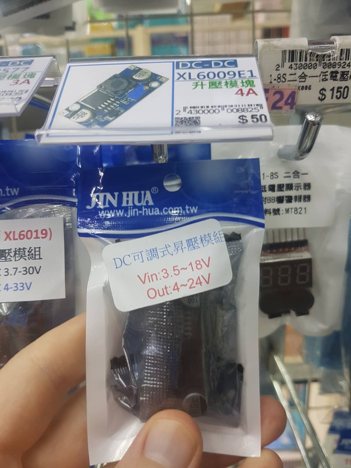

Stepping up voltage: Another problem i will have to solve is how to step up the voltage. Since the laptop batteries only deliver 4,35V at the very max, that’s not suitable to power a 5-8W Amp. Probably i will need something like 12V. Again i found a cheap module that can step the voltage from anywhere between 3,5 and 18v up to 4 to 24v. is this what they call a buck converter? It is based around a chip XL6009E1. I heard before that buck converter are noisy or something, Would it be suitable to drive an amplifier circuit from it?

So for the Watt, in the speaker box there are two speakers, which have different Watt limits. The big one is nominal 5W, max 8W. The small one is nominal 2 W, max 5W. So does that mean i can only run maximum 5 W through them, before the small one burns? Or are they kind of just taking what they need? How to solve this, that the two speakers have so different requirements? They are obviously ment to be driven by the same amp, like you can see they are in series, only seperated by a capacitor, which does the frequency filtering i suppose.
Then for the Impedance, when i check the datasheet for the LA4422, the examples all have a 4 Ohm speaker. But the two speakers together, have an Impedance of 4+3,2=7.2 Ohm . Is that acceptable? Or is there a way to exchange some parts in the amp circuit in order to make it more suitable for higher impedance speakers?

the speaker i found, with only a cap in between... not the most sophisticated frequency crossover i suppose?
They are actually in parallel, at least I am pretty sure that the center connection on the larger speaker isn't actually connected to the speaker itself, it's just
an extra solderpoint for adding things. So the - goes to both speakers, the + goes directly to the large speaker and also through the capacitor to the small speaker.
This capacitor acts as a high pass filter. This also means that on average it will be getting a lot less of the signal than the larger one. I say on average because
it depends on what you put into it. If it's just some ordinary (human) music then most of the signal will be taken up by the lower frequencies and you'll probably
have some distortion in the low range before you'll damage the small speaker. However, if you would put a signal into it with mostly high frequencies (say from a synth)
then it is possible to damage it.
Since they are in parallel the impedance is of course smaller, but the problem is that it is impedance and not resistance. ie it varies with frequency.
Because of the capacitor the average impedance will probably still be around 3 ohms but it's hard to tell without a datasheet for both speakers.
It does mention a 2 ohm load in the datasheet for the LA4422, so you should be fine as long as it doesn't get too hot, but it does have thermal protection.

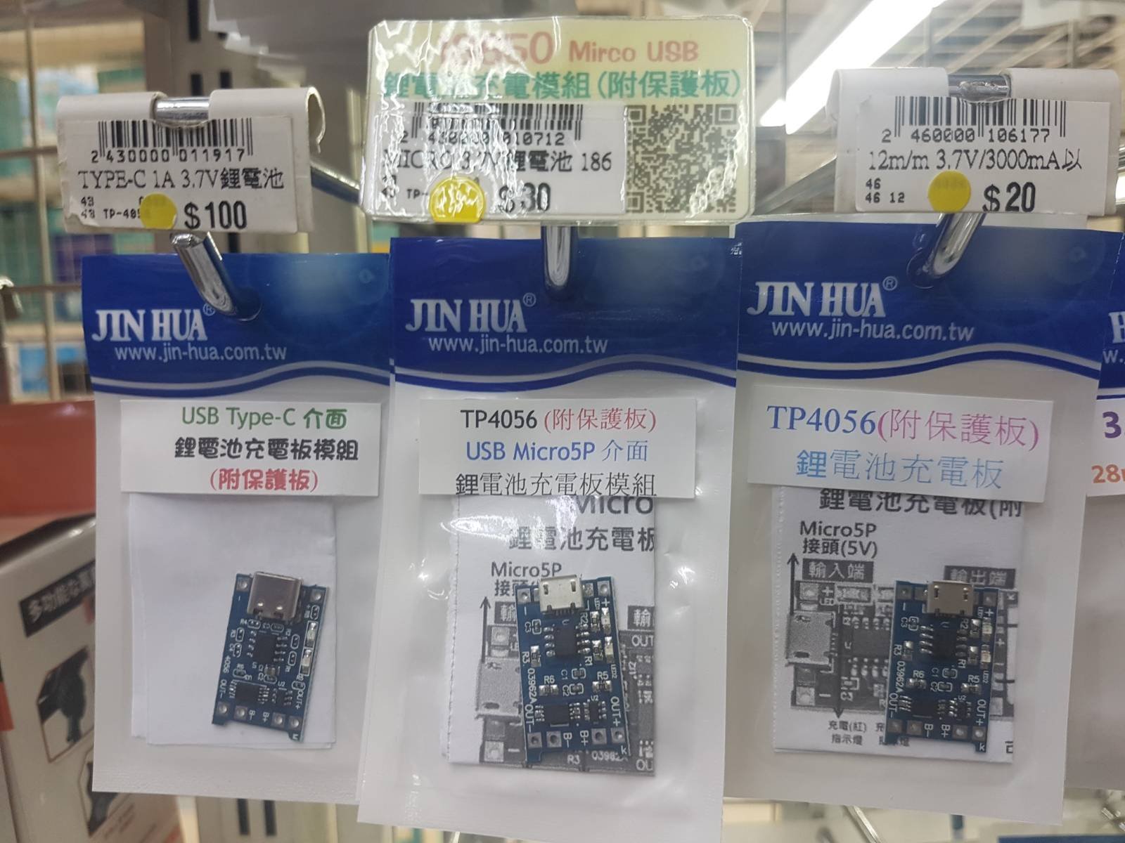

I am still a bit unsure about the charging circuit and the step up module. Anyone, has some thoughts about it?
I tried to upload photos of the two modules, but somehow it just doesn't work. Is there some limit per user per day or something?

I don't have any experience with using Li-Ion batteries so can't really comment on the use but be careful!
With 8Ah there's quite a lot of power packed into those when charged and you do indeed need some proper protective circuitry.
Not only for charging but also discharging in case of a short. Also something to protect it against any physical damage.
This video might be of interest: https://www.youtube.com/watch?v=LIWUYSDWjfk
edit: there is a difference between Li-Ion and LiPO (which is also a Li-Ion) but you do the research.
Hello,
no this is a boost converter. A buck converter is a step down converter. Both are called DC/DC or DCX to DC converters and more noisy than a linear power supply.
Since you want a portable amp I would suggest looking for a Class D amplifier because they are more efficient.
