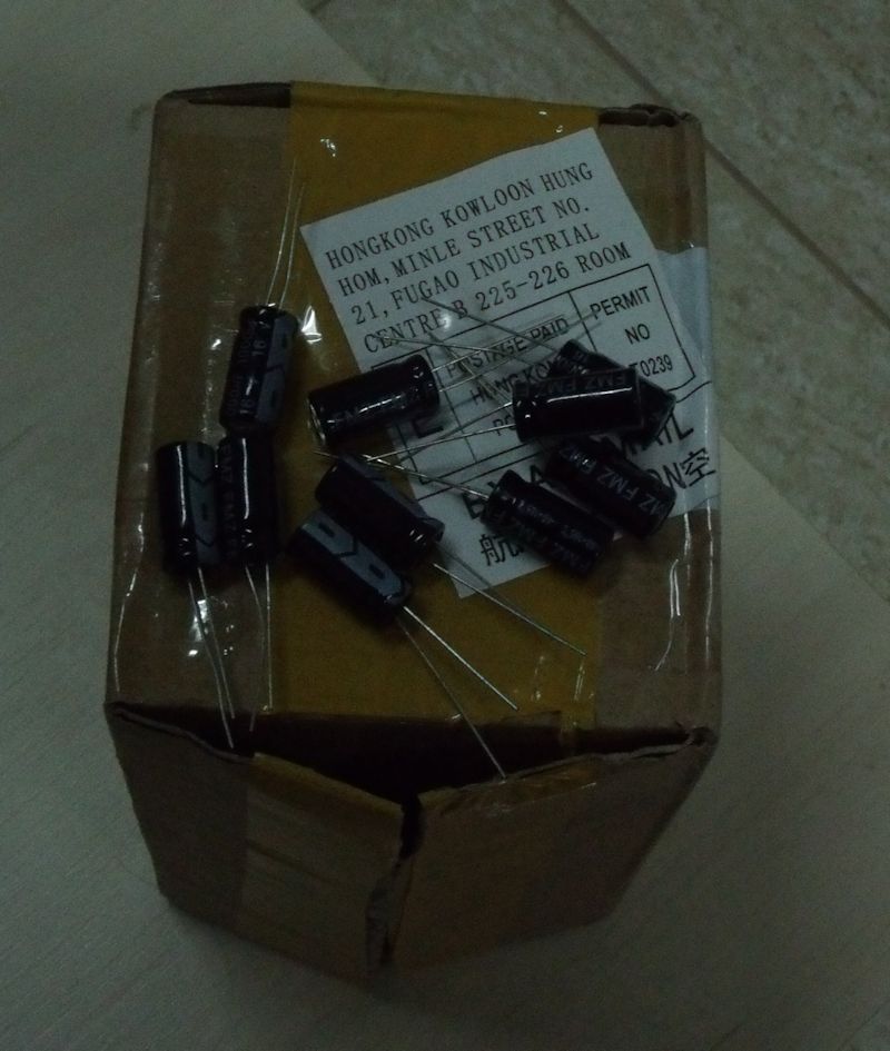

For those planning to build or repair a minimoog or vintage Roland, the uA726HC integrated circuit is needed.
This part was manufactured by Fairchild and discontinued in the early 80's.
There has been around a recently reissue by an unknown manufacturer from Korea, very close to the original and carrying the "F" logo. The original had golden legs, the clone has silver legs.
The new IC is available from certain sellers on eBay and AliExpress.
To my surprise, the clone not only works, but works very well, as I could test some of them in a custom built minimoog VCO. There is another guy out there who made some tests and published it on his site.
So, this is not about if the clones are fakes or not (and they're not), but how to put your hands on them. It's not that simple as it may seem.
I got mine from hkutsource for 13 USD each, but he's no longer selling it.
An eBay seller from UK, little_diode, sold them in the past for 90 USD. There were no picture in the listing, but he sent me one and it was the Korean clone, not the original.
Polida, an eBay seller from China, sells it for 90 USD.
Glenn Nichols (webmaster@icelectdata1.com) from ICEC sells the original golden-legged 1979 uA726 for about 50 USD each.
Seems that he has many left. Rush and buy all if you can.
Aliexpress has the lowest prices, maybe as low as 5 USD per piece. However it's not a good idea to trust all those sellers. I recently bought 10 pieces for 62 USD from an AliExpress seller called global Super Electronic market, via this auction. When I opened the box, there were some capacitors instead.
So here's my advice: think twice before spending a lot of money on these ICs. Buy one first, and be sure the seller will actually ship a uA726 and not some junk. Then order more. Shipping from China/HK is usually cheap.
You can post here your own experience/advice about the matter.
You can also post here your approaches to substitute this part in a VCO.
Hope this article is helpful.

PostPosted: Thu Jul 30, 2015 10:41 am    Post subject: Reply with quote  Mark this post and the followings unread
O course the question that comes to mind is... why the picture of some caps?
edit: oh I see - another more careful reading would have answered my question

PostPosted: Thu Jul 30, 2015 10:53 am    Post subject: Reply with quote  Mark this post and the followings unread
This is only to show that "global Super Electronic market" sent junk instead of uA726, and to be careful about dishonest sellers.

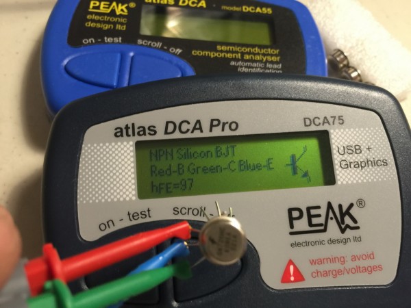

PostPosted: Sun Apr 10, 2016 9:13 pm    Post subject: Reply with quote  Mark this post and the followings unread

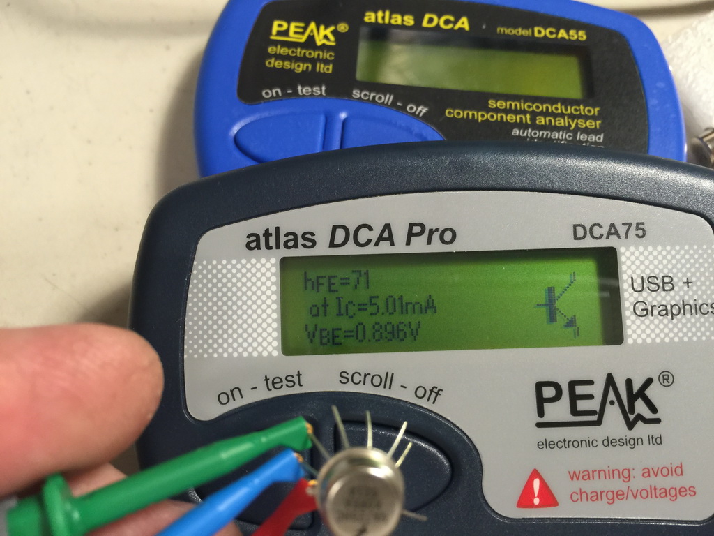

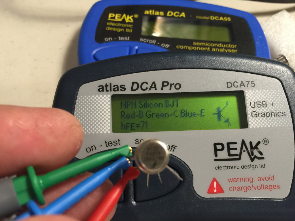

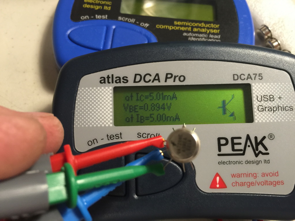

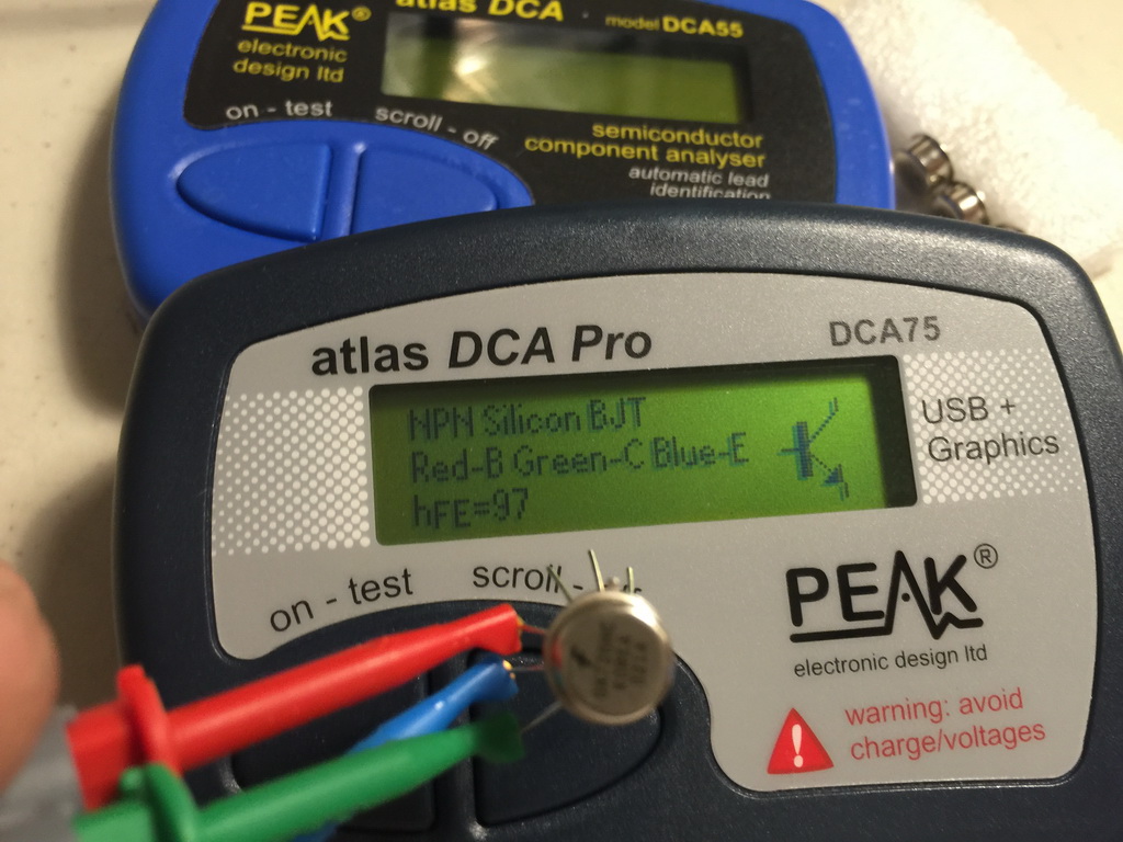

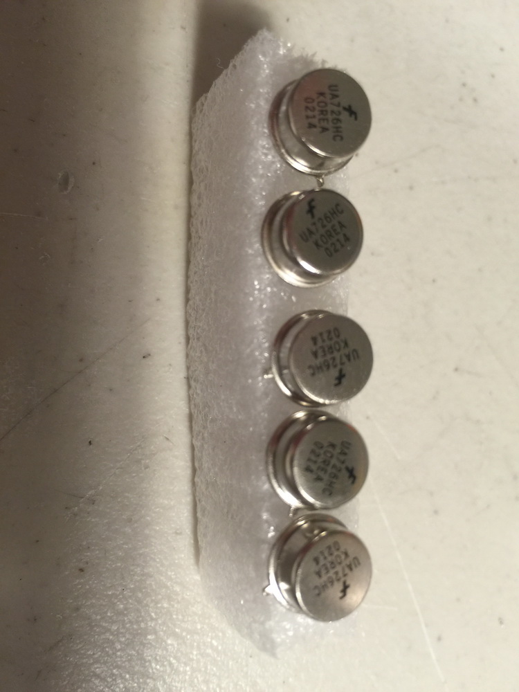

That's very aggravating. I received my order from UTSource and they test fine. See photos below. Vbe 0.894 and 0.896 although I wasn't being very careful how I handled the device while I was testing it.

PostPosted: Mon Apr 11, 2016 1:52 am    Post subject: Reply with quote  Mark this post and the followings unread
Using UA726 is sketchy business, there are other matched transistor pairs available, which aren't faked.
Unless you really really really need them, don't use UA726.
David, how do you like the DCA75? I have a DCA55 (as do you Very Happy ), but the added accuracy is very welcome.
Have you used it as a curvetracer on the PC already?

PostPosted: Mon Apr 11, 2016 7:41 am    Post subject: Reply with quote  Mark this post and the followings unread
I like it a lot. Yes I have used the PC interface and have analyzed some parts, mostly for fun. The PC interface is very easy to use and very interesting as you can overlay two parts and can see very clearly if they behave in the same way.
I also have an old Heathkit IT-1121 for nostalgia and a Saelig/Syscomp CTR-101 if I need more accuracy or need to test at higher power.
http://www.radiomuseum.org/r/heath_curve_tracer_it_1121_it11.html
http://www.syscompdesign.com/CTR-101_ep_60-1.html

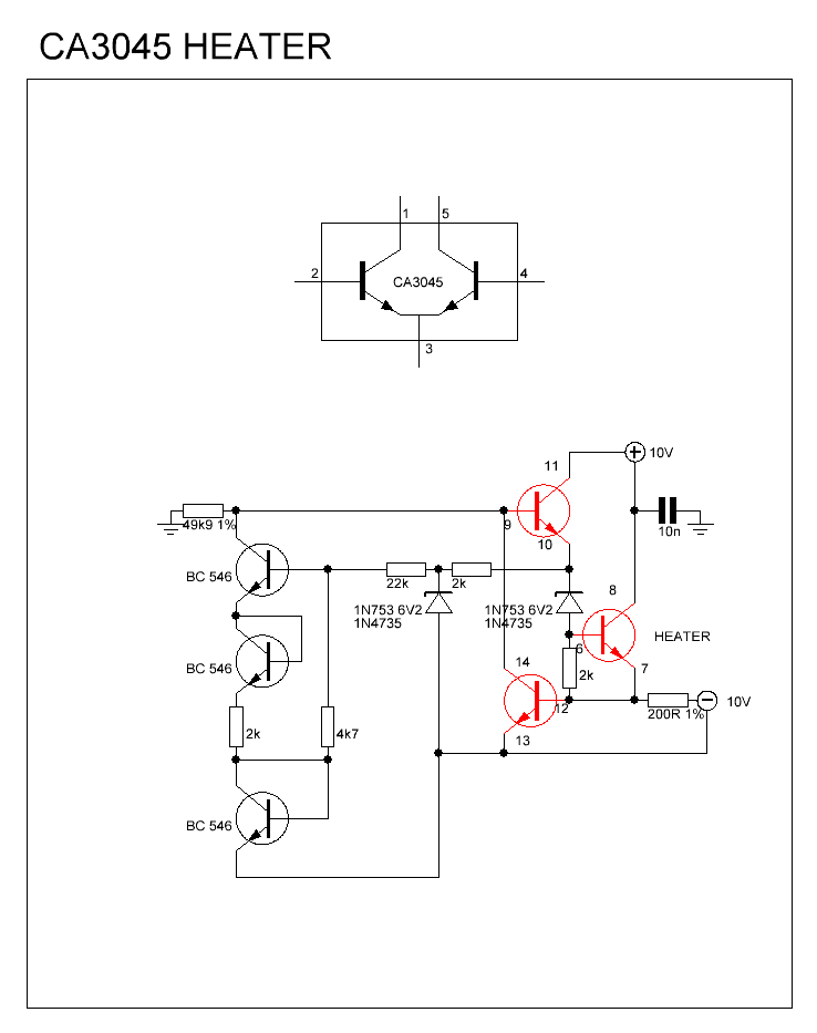

analogmonster wrote:
Use a heated 3046 solution instead.
That's true. I would never bother using a uA726 again. I developed the circuit below from the original datasheet, made some mods and it works very well. It does not require a trimpot to adjust the temperature, but uses precision resistors instead. For better results, I used a CA3045F3 because the ceramic package might improve stability even more.

Nice development. And did you design a proper PCB ?

Thanks, but no, I did not design a PCB yet beacause I don't repair or make minimoog clones. I build my own synthesizers from scratch, so this circuit is incorporated (or integrated) in the VCO board. But I can design a PCB that fits directly onto a 10-pin socket and post it here if someone is interested.

Here you go, a direct replacement PCB for the uA726. This PCB is plug'n'play, no adjustment is required. Calibrate your VCO as usual (or as per manual). Open the file with Sprint Layout 6.0.
The 49k9 resistor and the 10n capacitor were omitted, because they are part of the VCO board. The resistor is for temperature control and must be kept at 49k9 ± 1% for the minimoog. It may vary for other models. The current between the resistor and the rest of the circuit must be kept at 40 uA (microamperes) ± 1% for all applications requiring 1V/octave.
The 200R resistor is the current limiter for the heating transistor and must be kept at 200R ± 1% for all applications. All other resistors are ± 5%.
The funny thing about it is that the solution for the 726 problem was already there all the time, but for some reason nobody had noticed it. This trick can also be used on the Jupiter 8, VCS3, ARP Odyssey, ARP 2600, etc. For the ARP VCO, a CA3096 is used.

- the 10-pins location where it says "726" should remain empty right ? I should simply insert 10 pins in each hole that will be soldered in the 10 holes of the original PCB below where the original UA726 was right ?
- not sure what you mean by "49k9 resistor and 10n capacitor were omitted, because they are part of the VCO board". Which VCO board you mean ? this PCB of yours is a total/fully autonomous/fully compatible replacement for a UA726 to be used in any UA726-synth as it is right ?
Yes, that's right. You can either solder it onto the VCO board or use a 10-pin socket. Remove the original/damaged uA726 first.
The resistor and capacitor are not part of the uA726 chip. The designer must place them on the VCO board. This is valid for all boards which originally use a uA726. What synthesizer are you trying to repair/build. Is it your own design?
