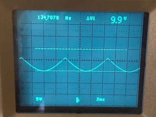

Here's the triangle

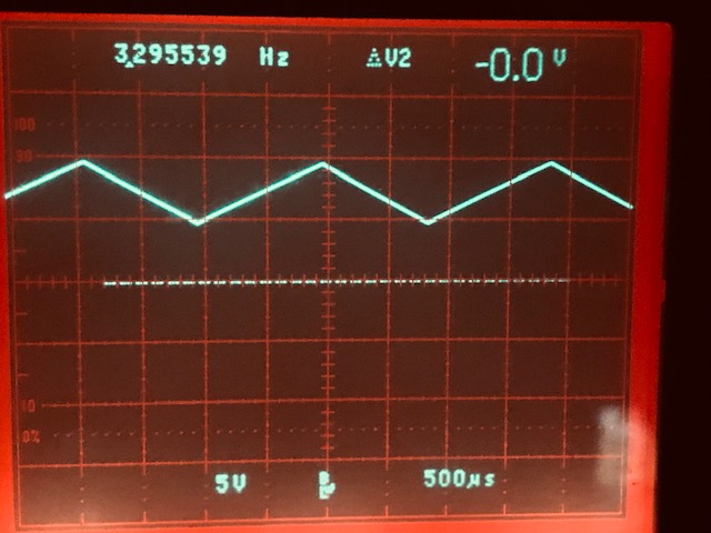

Here's the sawtooth. It's totally unaffected. I think this is because the shape of the sawtooth is created totally by the 555 and is not derived from the triangle like the other waveforms.

PostPosted: Fri May 27, 2022 3:38 pm    Post subject: Reply with quote  Mark this post and the followings unread
The saw being normal is kind of odd, because, actually it is created by the triangle as well. I'm sure Thomas is using a common form of Tri->Saw conversion and maybe the details of that are why it's still swinging fully +5 to -5.
The timing cap for the 555 is C4. And as you can see following the signal flow, that C4 is then buffered and used to make the triangle out.
It would be useful to see what the signal looks like at pin 8 of IC3. If *that* looks normal, then the problem is somewhere around IC3d which scales and offsets the triangle.
If that *doesn't* look normal, then the problem is going to be something causing the 555 to trip early on the downward half of the cycle. Again if you look at the datasheet for the 555 it explains what the comparison is between pins 6 & 7 & 2 that causes it to reverse.
If the pin 3 output doesn't swing fully between 15V and ground, that might also explain this. But my bet is that something about what's going on with the circuit is causing the low traversal to just trip early.
One thing to triple check -- you are using a TLC555 correct? Other models of 555 do not necessarily work reliably.

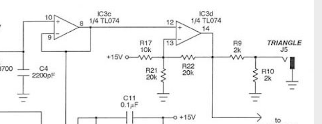

I don't think we're looking at the same schematic.
Mine has a 10K/4.7K at pin 3 IC2. So 4.7K/10K= 0.47 X 15V = 7.05V. These are also the values on the schematic on page one of this topic.
I am careful to clean pads and insure good connections.
Again my schematic (and the one on page one of this topic) shows 10K/1.5K as a voltage divider for pin 4. 1.5K/10K =0.15 x 15V = 2.25V
I too was concerned that these values at pin 3 and 4 of IC2 exceed the differential input limit. But it did work perfectly for two weeks as it is.
Has the schematic been changed? Remember it did work for 2 weeks with those resistors in there. I'm not saying there's no problem there but I think the problem is too low an output from the LM13700. As I see it there's no actual voltage gain from that point to the output. There is an inverting op amp with a gain of 2 but after being buffered it goes to a 2K/2K voltage divider at the output. I'm I getting this wrong?
This is the third LM13700 I've installed since the problem arose and they all perform exactly the same.
I certainly am not pleased that it developed this fault but on the bright side, I am getting to understand more and more about how it works.

PostPosted: Fri May 27, 2022 10:29 pm    Post subject: Reply with quote  Mark this post and the followings unread
gimble88 wrote:
Again, I really appreciate your input.
But the picture you have extracted below has 4.7K and 1.5K at pin 3, no 10K anywhere to be seen there. Which matches my copy of the schematic.
You're also calculating voltage dividers incorrectly.
It's not R1 / R2 * voltage. It's R1 / (R1+R2) * voltage. Where R1 is the resistor referenced to ground, anyway.
For pin 4 that's 1.5K / 11.5K * 15V = 1.9V Which is what your meter is actually reading there.
On pin 3, it should be 1.5K / (1.5K + 4.7K) * 15V = 3.6V Nowhere near 7V.

The trick here is that the reason a voltage divider works is that it's a ratio.
V=IR
If you assume the input of the op amp or LM13700 has infinite impedance, all the current runs from 15V to ground through *both* resistors. So the total current is 15V / sum. The voltage across just the 1.5K is that current * 1.5K (IR). So 1.5K * 15V / (1.5K + 10K).
The Ratio is the resistor you're measuring across to the entire resistance, not the upper resistance.
The only time this would behave differently is when you're using an op amp where you're forcing that middle point to be ground (summing/inverting op amp config, using the virtual ground), but that's not what we have here.

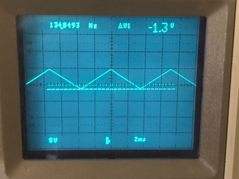

Here's a pic of the output at pin 5 IC2. DC coupled. I'm not too worried about the offset as I see the compensation for that at IC3D, I think. But 5.xV PP seems too low to me. (Ignore the slight slew in the waveform, that's an artifact of the probing. I was monitoring the triangle output at the same time and it also slewed that little bit when I probed pin5 but the magnitude didn't change.)

PostPosted: Sat May 28, 2022 10:04 am    Post subject: Reply with quote  Mark this post and the followings unread
gimble88 wrote:
I still think my output at pin 5 IC2 is too low. Since there is essentially a gain of one from pin 5 IC2 to the triangle output, it would seem that the output of at pin 5 should be closer to 10V PP.
I swear I'm not trying to pick on you Very Happy
This is a non-inverting op amp configuration. The gain will be (1 + R22/R21) = 2. The +15V is an offset to get it back to being centered on zero. Since it's going into the - input of the op amp it'll be negative, and ... well I'm not sure how it's divided in half cos I get really vague when op amps start combining different types of configurations Very Happy But I'm confident it is divided in half to reverse that 7.5V offset.
It should be the case that if you use Ohm's law & Kirchoff's law, with the understanding 1) the op amp will try to force pins 12 & 13 to be the same and 2) assuming an ideal op amp where there is no current in either of those inputs, you'll be able to work it out. I got my COVID booster #2 yesterday so I'm still too far out of it to do the work myself Wink
Have you measured the triangle output since fixing the other problems?

When I said there was "essentially no gain" between pin 5 of IC2a and the triangle output, I was being approximate. The gain of IC3d isn't really 2 because, as you note, the 10K resistor is at AC ground where it's connected to +15V so that confuses the normal non-inverting gain formula. I measure the gain at more like ~2.5. When the signal passes through the 2k/2k voltage divider at pin 14, it's down to a gain of 1.25 from the value at pin 5 IC2.
I totally agree that R10 connected to +15V is raising the DC reference on the inverting input of IC3d. Since the op amp will try to make the inverting and non-inverting inputs look the same (oversimplification, but it works) this should get rid of the offset at the output.
Since my problem is not in the DC offset but in the magnitude of the negative half the triangle cycle I'm pretty sure all that stuff around IC3d is correct.
The question of why the saw wave is ok, I believe I have an answer to. IC 4a and 4b seem to take my intact upper triangle cycle and it's inverse and mix them together. It would seem that the negative half of the triangle wave is not involved in the conversion. When I look at IC 4a I see some things in common with an attenuverter. It's not one, but I see how that op amp is sending it's inverted output (that *would* have had a gain of -2) to the inverting input and mixing it with a copy of the non-inverted input signal to end up with a sawtooth. I know I'm not being clear... but it's a very cool circuit.
Which leaves the question: why have I lost almost all of the negative half cycle coming out of pin 5 of IC2a?
I didn't fix any "other" problems because there weren't any. All the parts values are correct with the schematic and haven't changed since the oscillator was working perfectly originally. I checked several, sometimes having to remove them from the circuit to measure. No, I didn't put the same ones back in. I put in new ones that I measured before installing.
OK, I had been of the impression from what you said earlier that correcting the other mistakes had resolved this. Obviously I misunderstood Smile.
So when you said "10K and 4.7K" at pin 3 of the OTA, you misspoke, rather than describing an incorrect value? Because those resistors are 4.7K and 1.5K in the schematic.
So... I did a simulation.
https://tinyurl.com/2q8kqp2j
The Source is a triangle, 5Vpp at 7.5V offset.
The rest of the circuit is IC3d, including the 15V through 10K, and the two 20K resistors.
The output at pin 14 is 20Vpp centered on gnd. Then through the 2K / 2K voltage divider (not drawn), we get a 10Vpp triangle output.
So I would say that 5Vpp at 7.5V offset is entirely correct for pin 8 of IC3. Whatever else is going on must be elsewhere in the circuit.
PostPosted: Sat May 28, 2022 2:52 pm    Post subject: Reply with quote  Mark this post and the followings unread
Going to stop re-re-editing that one.
Clearly my math was wrong too Very Happy
I was thinking 5Vpp * gain of 2 = 10Vpp and I was forgetting the 2K / 2K divider.
in fact somehow the 10K to 15V gets us to a gain of 4, and also cancels the 7.5V offset. Once again I think this needs higher level circuit analysis than I'm capable of at the moment, which is why I simulated it.
gimble88
Joined: May 21, 2022
Posts: 18
Location: Oregon
PostPosted: Sat May 28, 2022 4:13 pm    Post subject: Reply with quote  Mark this post and the followings unread
Yep, I did a good deal of mispoking around the time I gave those resistor values. Rolling Eyes
Wow, I love the simulation. I think we're on the same page now. Still confused but at a much higher level of understanding Laughing
If you look at R17 and R20 as both being connected to AC ground then indeed it looks like it should have a gain of 4. If I did have a gain of 4 there my output for the triangle would be 10V PP, and I think I'd be golden. The simulation supports this. It has an output of 20V PP if I'm reading it right.
What I measure at pin 14 is 13V PP. This is a gain of about 2.6. Hmm. I think this may in fact be where the problem is. 5V PP with 7.5V offset at pin 5 IC2 looks like the correct values now that you did that simulation.
I'm gonna dig into the parts around IC 3d and see if I can see why the gain is lower than the sim predicts.

You might try disconnecting that jack from the panel and see if it's better.
Maybe the output jack is normalled to ground or something?
