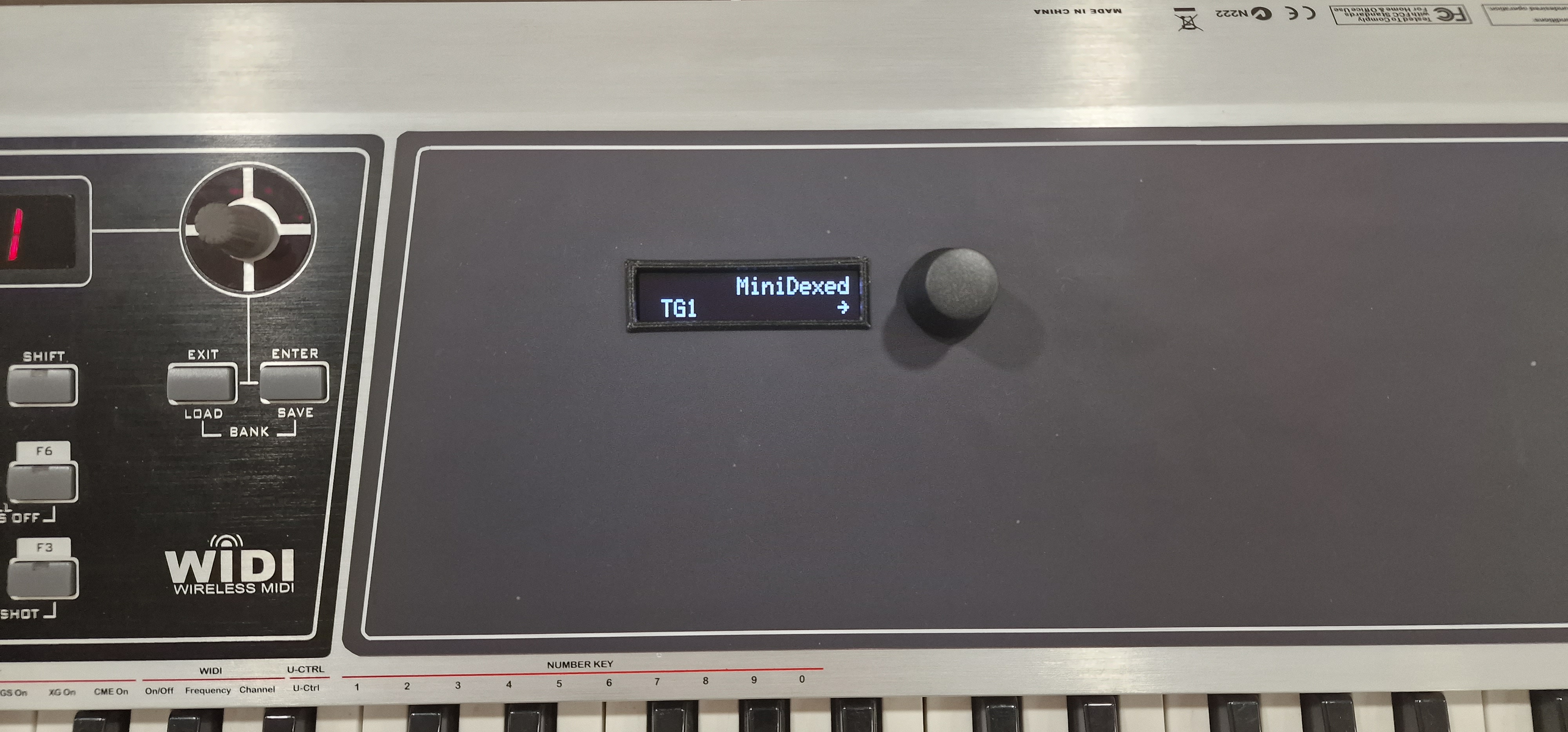

I originally built a rack version of this project when I first saw it, but since the war started I haven't been able to dedicate much time to it.
However, another DX type project I was playing with had too many issues so I repurposed the internal hardware into an XVA1 synth. This left me with an empty CME UF70 chassis and a spare Pi-400 to play with. So I added a DAC and some MIDI hard ware to create a sort of DX5 clone, 76 keys, 8 layers (not 2) and the bonus of effects.
Details can be found here....
https://github.com/probonopd/MiniDexed
