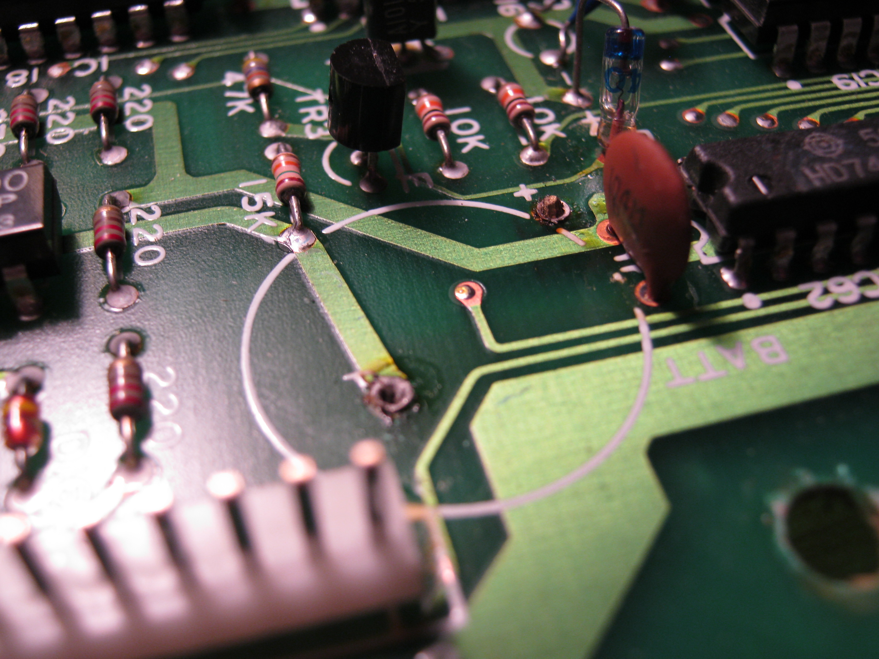

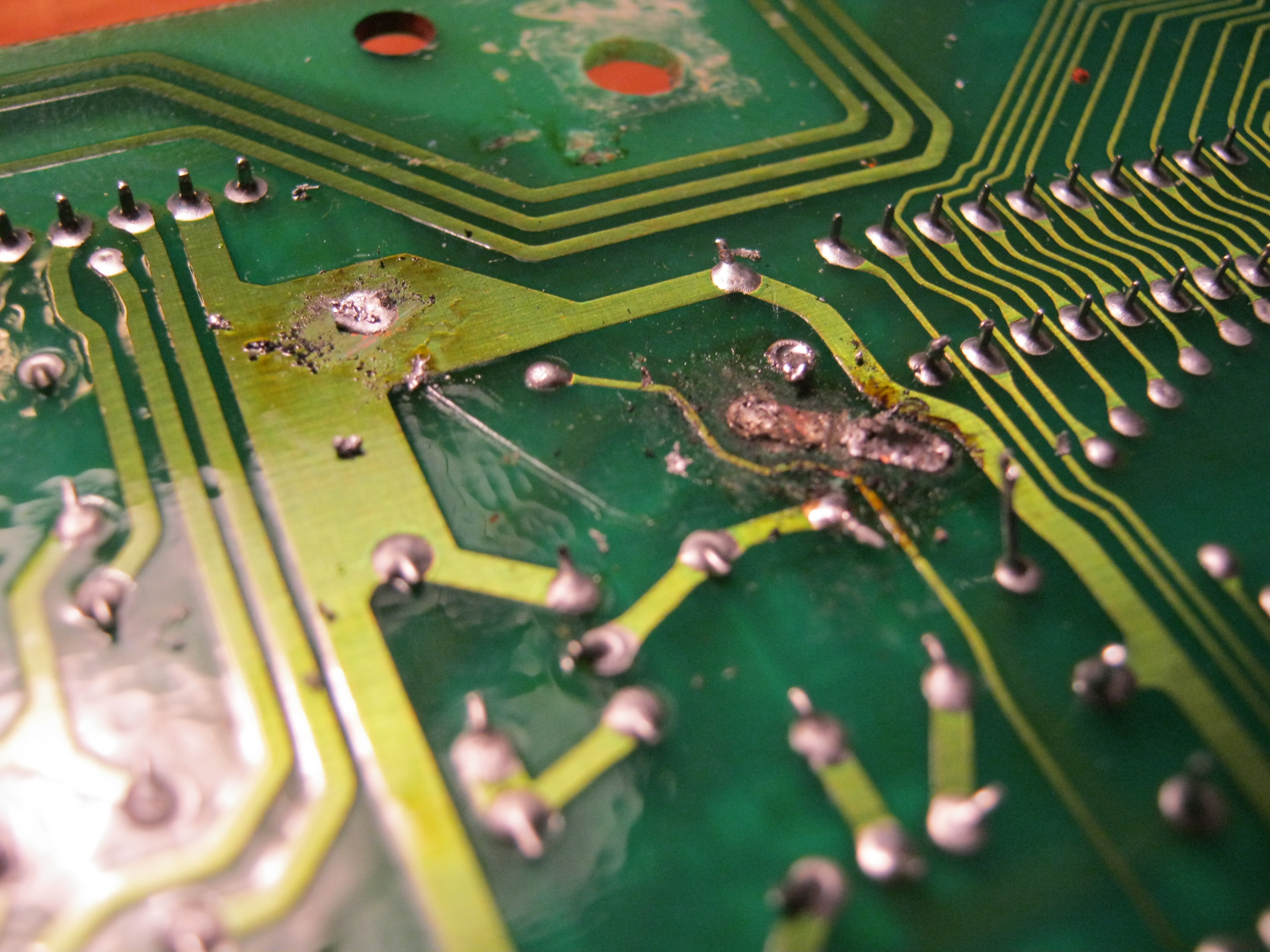

I'm at it again...removed the battery and cleaned up the area on the backside of the board where the battery goes. I'm attaching some photos of the front and back. You can clearly see where the holder goes and the + and - contacts on the front. My question is in regards to the area on the back where the + goes it's a strip on the right(Looks a bit like a landing strip) is the + supposed to be touching this or is it just for solder and the + tip is in the solder?

You need to clean up the backside of the PCB. Use 1t least 90% alcohol and an Xacto to scrape off all that gunk.
Also looking at the top component side battery minus terminal, you need to make sure you have continuity between the top pad and the bottom PCB pad. It looks like you may have destroyed the via or feed through of the Pad. This via connects the top pad to the bottom pad.
Gothboy

Cleaned the back of the board, went out and got new rosin core solder. Went at it again and did a re-solder. Still has the same problem so it's off to HiTech I'm afraid. It's apparently just beyond me at this point. Sad Rolling Eyes
