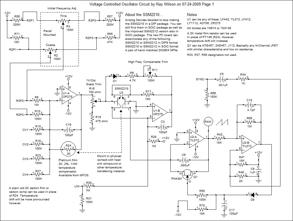

Hi everyone,
I created this nice VCO but I can't do the calibration, by applying 0 Volts to the CV the frequency drops to a maximum of 180 Hz.
What can I change to go down to 100Hz as per the instructions?
the 5nf C6 capacitor?
Thank you!!!
Carlo
Yes - could change that.
Some thoughts that came up here when looking at it for a bit ... :
It is a tad strange that it deviates a factor of two almost on the low frequency .. so i wonder .. is the CV convertor working correctly ..
Anyway, there would be no harm to try 10nF and that should make the oscillator twice as slow.
This may not mean however that the scaling (V/Oct) can be set properly (when there is an issue with the CV conversion).
I'd check there first to see if all component values are correct (around U1 and U3 ...) .. or maybe it is the high frequency trim (R11), that is set to an extreme (but the calibration instructions should mention that ...)?
Good luck Smile

Oops, I'm old.. I had reversed pin 2 of Fine and Coarse!! now the frequency is ok. hopefully we can calibrate.
Thank you
Carlo
