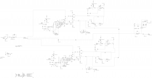

HELP pt2399 summing DRY/WET
waronheaven
Joined: Dec 26, 2021
Posts: 3
Location: rome
PostPosted: Thu May 09, 2024 6:02 am    Post subject: HELP pt2399 summing DRY/WET Reply with quote  Mark this post and the followings unread
hello forum, i a working on this design which is basically 2 pt2399 in parallel mixed at the end with a gain stage, i have. dry/wet pot but is summing the dry signal with the wet so at the end i always have a wet signal ending in having 1 repetition, i was thinking to move the pot and have one side of the pot the dry and one side the wet, my question is do i need to buffer the signals before going into the DRYWET pot or i can sum it later as it is now?
