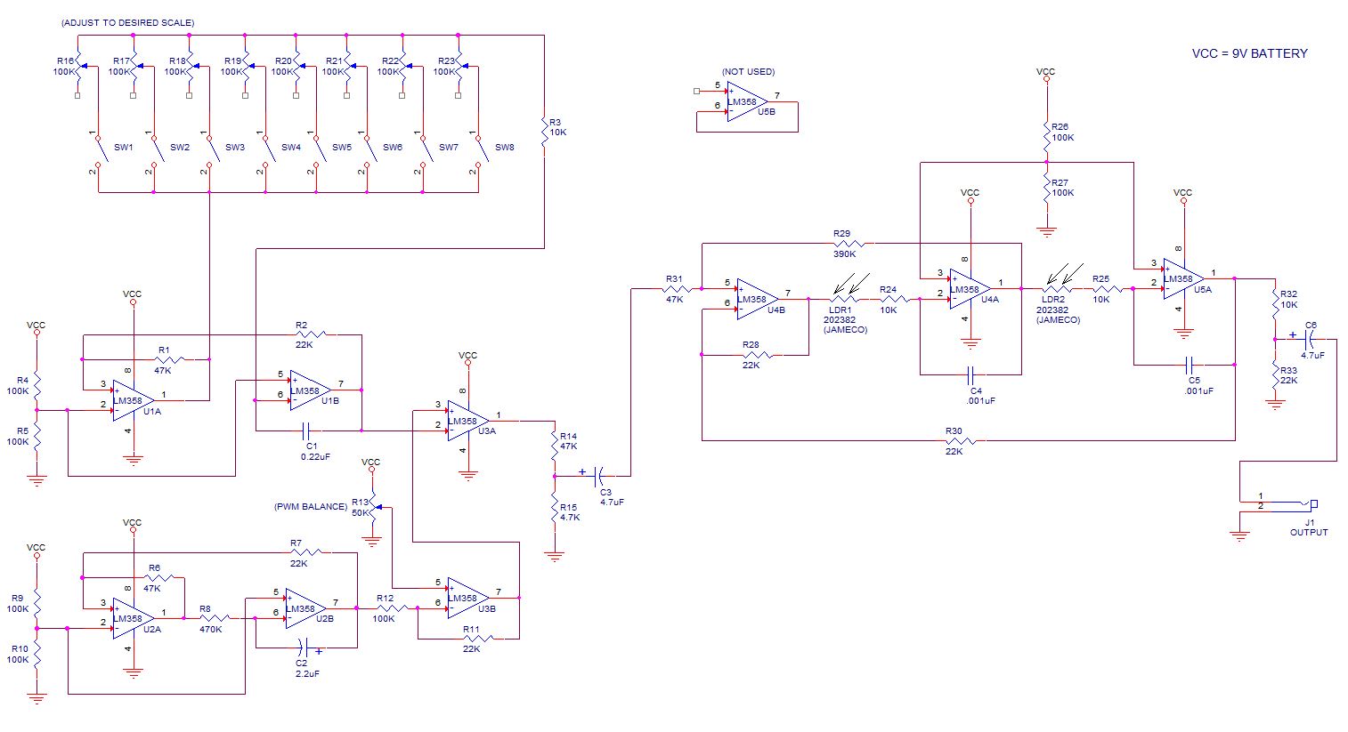

I’m looking to build a simple breadboard vco using LM358 that I can play with my midi to cv module I’ve made (also on breadboard)
I’ve been really inspired checking out Pete Mcbennetts examples on his YouTube channel but to be honest I’m a total beginner and am still trying to learn how to apply a schematic to breadboard
https://youtu.be/E1Onzz76c6s?feature=shared
I’ve been literally screen capping the close ups to help but isn’t really ideal and am not learning by doing it this way as you end up just ‘painting by numbers’
So am hoping anyone can help me with a simple LM358 vco that can be playable it doesn’t need to be super accurate just to get me going and am looking to power with a single 9v battery

Meant to provide this Schematic from Pete Mcbennetts LDR synth I'm trying slowly to apply to a breadboard but am not getting anywhere
[img]https://drive.google.com/file/d/1cuWsH4qIj5TrRzfKUfOZjeRPMD83aeQf/view[/img]

Hello Moogman1978,
I'll try to help you with this.
Firstly do you understand how the breadboard connections are arranged ?
Do you have a multimeter for measuring voltages ?
For transferring a circuit diagram (schematic) to a breadboard layout I'd use some layout sheets (or even graph-paper) to work from.
Also build and test it in sections : there are three main ones - the main oscillator, the filter and the drone oscillator.
If it doesn't work as expected, that's when you need to measure voltages around the LM358's to make sure the correct bias and output voltages are present although some meters don't usually respond to signal voltages very well.
It's also easy to get wires in the wrong place on breadboards... I've done it myself many times !
If connections around an op-amp aren't correct, they tend to have their outputs hard against the positive or negative supply rail.
So, get the main oscillator working first and for test purposes, I'd just have a single resistor (e.g.47k) and switch connected between U1 pins 1 & 6.
Let us know how you get on.

That's good that you're getting a meter - measuring voltages around a circuit will tell you what's going on and let you see if things are connected properly.
I decided that I would input the circuit into some circuit simulator software I use to get a better understanding of it, as this always helps to diagnose any potential problems.
The main oscillator has a triangle-wave core built around U1.
U1A is configured as a Schmitt-trigger having a square-wave output and it's non-inverting input is connected to the output of U1B via the 'master-tune' potentiometer.
The output of U1A goes via the resistive chain plus switches to give a current which controls the charge/discharge of C1 by U1B in a classic 'integrator' circuit.
I see from the diagram that if none of SW1-SW10 are pressed, pin 6 of U1B is 'open-circuit' from a DC point of view, i.e. unbiased and the output on pin 7 would therefore tend to float up to the positive supply rail.
This is not how it appears to behave in the YouTube video , it seems to run at the lowest note (highest resistance) with higher notes being played when the switches are pressed implying less resistance in the circuit. ; I'm wondering if there's a resistor missing from the diagram or it's incorrectly drawn...
Later : this is maybe how it's supposed to work to enable note On/Off...
Apart from this, the amplitude of the triangle-wave from U1B output will vary with the frequency but this doesn't matter as it then goes to U2A which acts as a comparator to generate a square/rectangular output.
PWM of the signal is achieved by a low-frequency triangle-wave generated by U2 in a similar fashion to U1. This operates at a fixed frequency of about 0.5Hz according to my circuit simulator.
Another thing I noticed is that C2 (2.2uF) is shown as a polarised capacitor (usually electrolytic). In that part of the circuit the LFO signal is centred around 4.5V and the capacitor has +/- 1.0V across it. This would suggest that a non-polarised capacitor should be used here, although 2.2uF non-polarised capacitors are available they can be physically quite large/expensive....
Getting back to fault finding, once you get your meter you can measure the voltages around the circuit and report back and we can take it from there.
Andy
NB - I've updated my circuit description to correct some inaccuracies.

Hi, I think I should have read your initial post more carefully..... the circuit above is NOT a Voltage Controlled Oscillator !
Its frequency is controlled by a capacitor plus varying amounts of resistance.
There is no easy way to control it with external control voltages : even if you did manage to shove the CV somewhere into the circuit to modify the oscillation frequency it would be unlikely to be useful in a musical way.... others may have different opinions about this.
To play notes on your MIDI keyboard using your MIDI to CV converter would require a different circuit for the oscillator section - one that is designed to be controlled by external voltages, i.e. a VCO.
Probably need other sections as well (eg VCA) which makes things a bit more complicated unfortunately...
This circuit 'is what it is' and I would describe it as stand-alone - the designer certainly did a good job with his demonstration in the video.
For some different circuits to consider, I'll leave it for others to make recommendations but it could be worthwhile having a look here :-
