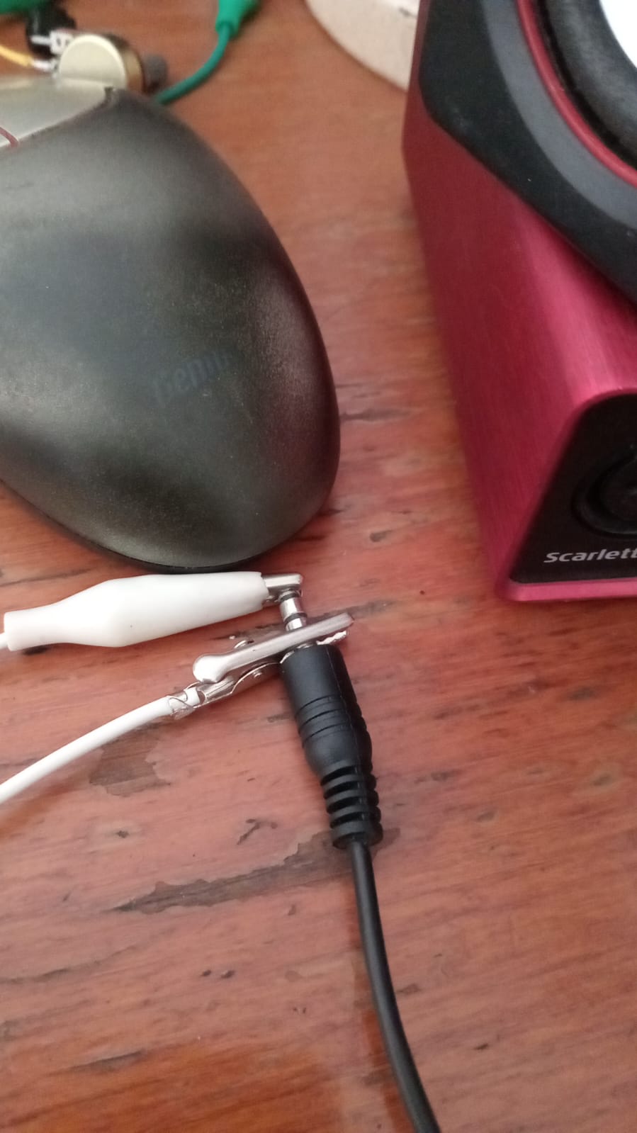

PostPosted: Sat Oct 12, 2024 2:57 pm    Post subject: Reply with quote  Mark this post and the followings unread
great, this is my project XD
 Filesize:  95.68 KB
 Viewed:  97 Time(s)
 Filesize:  163.7 KB
 Viewed:  100 Time(s)
Posts: 24500
PostPosted: Mon Oct 14, 2024 5:28 pm    Post subject: Reply with quote  Mark this post and the followings unread
Right, so when you ran trough the wires hundreds of times, and that is all ok, then maaaybe .. someting actually is broken Shocked

Posts: 5881
PostPosted: Thu Oct 17, 2024 12:08 pm    Post subject: Reply with quote  Mark this post and the followings unread
On the photo it looks like the first 2 gates have their outputs connected to ground instead of their inputs,. but that could just be a matter of perspective.
does the chip get warm ?
Also it looks like you are taking the output signal from the input of the inverter (the side with the capacitor). This can sometimes work but could also
prevent it from oscillating.
have you tried putting it on a different spot on the breadboard ?
sometimes the connection isn't good enough, taking the chip out and putting it back in could fix it.
