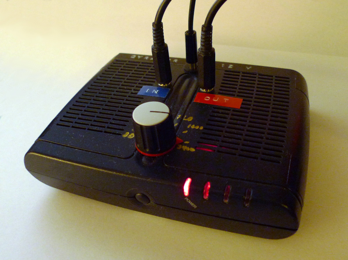

Here is an image of my unit; I used the box of an old router or something. Also a couple of sound examples with white noise. There is considerable switching noise, but that just adds to the character, I think. (I also updated the schematics; the new version is exactly the same, just removed som elements outside the page.)
Helge
