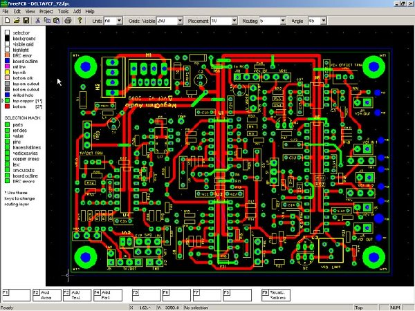

It has a been months since I planned to do the Delta VCF run. I was delayed (let's leave it at that!).
Here's the update.
I placed an order for ten. This is the prototype run. If it checks out OK then I'll order more. I'm estimating that there are 20 or so people who have been wanting/waiting for this pcb. I'll probably order 50 to start with unless more people express their interest.
Here is the run down followed by some attachments:
PCB is 3.5" X 5"
2 oz. copper
Lead free HASL
The traces and pads are large to withstand multiple reworkings. Silk screen has text for pots indicating pin 1 (typically connected to ground in the standard input attenuator configuration) and other useful hookup info such as name and pin function for some. Jacks and trimmers are also named.
2 pin MTA.100 header for CV normalling schemes
Double footprints for filter core caps (use 5mm Wima or the clear foil polystyrene), single turn trimmer (Bourns or Vishay (Vishay is half the price)), and power supply header (4pin MTA156 or 6pin MTA100). There is also an extra 4pin MTA156 header at a different angle for frac rack builders.
I still have to clean up the schematics and write up a builders guide. Should be done with this by the time I get the prototype batch (approx. 2 weeks).
First pic is a screen shot of the pcb (I use FreePCB which is GREAT!!).

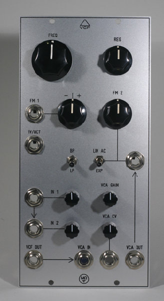

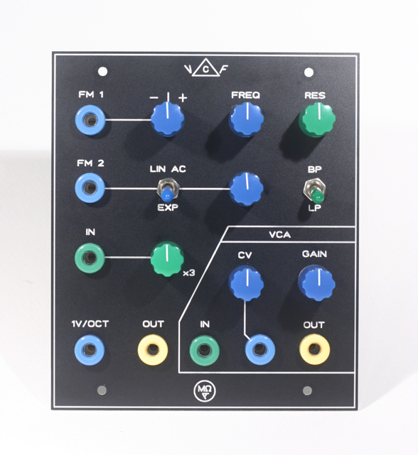

other pics are my Fracanana version (fracanana.com will be up and going shortly), and the silver face 1/4" version (dotcom/Moog size) shows normalized signal flow (follow the arrows).

WOW! The frac version looks great! I thought I was going to be the first to have color matched jacks/knobs, but you beat me to it. We even have the same color scheme: blue cv in, green audio in and yellow audio out.

PS that Fracanana looks really very cool...

The frac layout looks cool... but any chance you'll also offer 1/8" frac version as well? i for one would be more likely to purchase...
