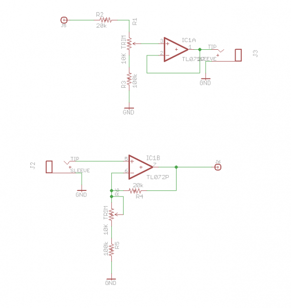

So this is what you're looking for then?
Be warned: this is off the top of my head, it is not tested, breadboarded, nor ever done before as I have no Buchla modules. But it's the circuitry to do what I suggested. If you were to get really really precise components, you could forego the trimmers, but in my opinion they're a safer way to get what you're after at whatever precision you can measure with your meter.
Edit: The outputs probably ought to have 1K resistors on them as well (between the op amp and the jack) for output protection. More important for non op-amp circuits, but still ought to be there generally.
AWESOME!
This is exactly what I was looking for (even more, thank to your schematic).
I will breadboard and test: I wanted to understand what it needs for this kind of conversion (the logic) and with your help I am now able to do so.
It's the best way to start. I underxtand what you mean about the trimmers too. Cool.
Thank you very much elmegil.
PostPosted: Wed Feb 06, 2013 6:02 am    Post subject: Reply with quote  Mark this post and the followings unread
As I look at it again, I can see an instance where the second circuit (1V -> 1.2V) could fail to work--if your 100k resistor is actually *higher* than 100k and the 20k is actually lower than 20k. You could use an 82K and a 20k or 25k trimmer to deal with that.

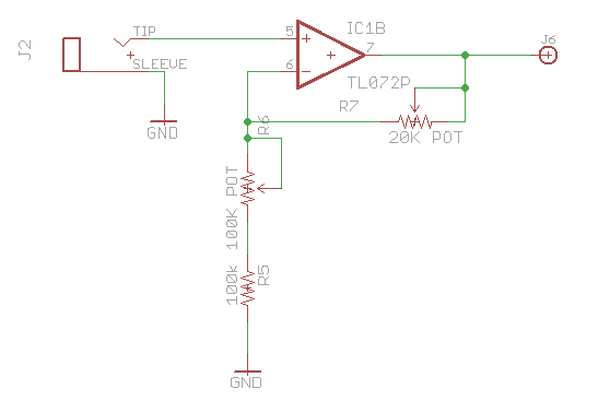

PostPosted: Mon Mar 25, 2013 1:52 pm    Post subject: Reply with quote  Mark this post and the followings unread
I tested on breadboard your schematic. 1v to 1.2v.
I send 1v to the input and power on. When I set the 20k trimmer (because I am using a trimmer for 20k too) to 1.2v on the output, the input signal rises up to 2.18v.
I am sure I am doing something wrong. Here is what I did:
I replaced 20k with a 20k trimmer (cause it did not work either with normal 20k resistor).
Signal from TL072 pin 6 goes to Lug 1, Lug 2 goes to TL072 pin 7, Lug 3 goes to GND.
For the rest I did like on your schematic. Except that the 10k trimmer did not change anything. I remarked I bought a 100k trimmer instead of 10k, but as it did not change anything I disconnected from R6 on.
It was connected like this (R6 connections):
TL072 pin 6 to Lug 1.
Lug 1 and Lug 2 connected.
Lug 3 to R5 (100k resistor).

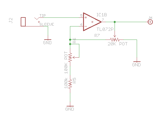

PostPosted: Mon Mar 25, 2013 2:21 pm    Post subject: Reply with quote  Mark this post and the followings unread
It may be that there needs to be a resistor on the input. On an op amp, the + and - inputs are virtually tied together, so they will always show the same voltage.
Perhaps someone else with more experience could comment....I can see why this would be but I'm not familiar enough to say what the right way to deal with it might be.
Edit: I'm home now and re-reading, there are some definite problems with what you describe.
The third lug of the 20k pot should not go to ground Very Happy
Just to be sure, it sounds like what you've done is what I have in picture #1. For what you were trying to do, it should actually be like picture #2. I don't know that those pots that way would buy much though.
I honestly don't think that having the input change voltage is right. Are you sure you have a good TL072? Can you try a different one? Or even just use a TL071, though it has a different pinout (pin 2 is negative input, pin 3 is positive input, and pin 6 is output).

PostPosted: Mon Mar 25, 2013 10:20 pm    Post subject: Reply with quote  Mark this post and the followings unread
About my tests which didn't work:
I was testing the second schematic for 1v to 1.2v (with a 3.5" at the input and a banana at the output).
What I also did which is not mentionned was connecting TL072 pin4 to minus an pin8 to plus of power supply (15v).
I also tried with disconnecting trimmer from ground, but the 2 lugs were never connected during all my tests, so I will try now what you mentionned.
I will also test with new TL072 or TL071.

PostPosted: Mon Mar 25, 2013 11:19 pm    Post subject: Reply with quote  Mark this post and the followings unread
I don't think I'd expect different results then.
The two lugs connected is just a convention. Ultimately it's the same circuit as using one side and the wiper and leaving the other side disconnected.

PostPosted: Wed Mar 27, 2013 3:15 pm    Post subject: Reply with quote  Mark this post and the followings unread
Now the circuit is doing what it should. Nice!
With both trimmer set to their max, the outgoing voltage is 1.198v with an incoming of 1.0v.
I tested also with 91k resistor instead of the 100k and got 1.20v (and over if wished), so all is OK.
