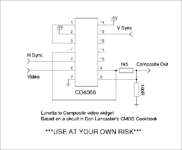

I don't know if it's any use but the CMOS Cookbook has a circuit snippet for generating a composite video signal using a CD4066. It's supposed to be hooked up to something that generates the proper sync signals, but you might get something out of it just hooking up random signals.
If I get chance I'll try it out and see if I can get anything useful out of it.

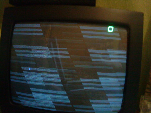

Success Very Happy
Hooked up the circuit from the CMOS Cookbook and it works. The original circuit is supposed to take a 60Hz V sync signal and a 15,750Hz H Sync signal together with a serial stream of 1s and 0s into the video input and produce a monochrome composite output. The H and V sync input had RC one shots on the inputs to generate the correct length pulses, but I couldn't get it to work with these on so I ditched them.
Happily just feeding a bunch of clock signals into the 3 inputs produces an output that my TV will display Smile
The picture's monochrome, but it's a start. I didn't have time to get any video so a photo will have to do for now.
Obviously, if you build this, you do so at your own risk and I take no responsibility for any damage you do to your TV, your Lunetta or most importantly yourself.

Exclamation thank you so much slackers, that looks great! Really great that you found the time and did the effort to get this one working thumb up
Im gonna get myself a 4066 and give it try.

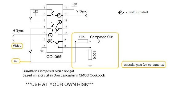

I already had some idea the V and H sync not to be essential as video outputs of circuitbent stuff don't have that either. Apparently, as long as you have "some" Lows available, they'll somehow be interpreted as sync signals.
Considering V sync , H sync and Video can be random Lunetta signals, I wonder what is the absolute minimum amount of circuitry necessary.
V sync and H sync let through a 5V High when both are High. Else Low.
The Video signal bypasses the 1k5 resistor. So the composite video output is one of three options: Low, when In is Low, and two levels depending on the state of the Video signal.
As the level determines the brightness more level options could maybe lead to more varied visuals. Maybe instead of the 1k5 resistor use a smaller one (47 ohm?) and a potmeter, 1k or 5k.
And as we'd be varying voltage anyway, maybe an R/2R or passive resistor mixer could take in more Lunetta signals to provide more level options.

electri-fire thanks for redrawing the schematic, makes it easier for other people to see how it works.
Your simplified version should work, the V and H switches are just making an AND gate so any stream of pulses should work just as well. Replacing the 1k5 with different values does change the brightness level, like you suggested. As far as I can tell anything that produces voltages in the correct range with the occasional 0 volts to act as a sync should work.
Adding colour will be trickier I think.

Another succes, got mine working today.
I followed the slacker schematic and with my modern tv it wouldn't recognize the signal but I could see the image changing. After switching to an older set it worked perfectly the first time, bands of monochrome goodness passing over the screen. Using some very high frequency clocks I almost got the image stationary and it worked very intuitive a little like tuning a drone.
Because I had no 1k5 and 100r I used 2 2k trimpots, at first dialed in on the same resistance wich gave nice black and white. But by increasing the resistance I got more definition and it would follow the music better and with lower resistance it started going into red and some different greys.
I shot a video where im feeding it a signals from a melodygen going through a YAVCO(probably a xor in there too). I started with the high resistance setting and somewhere halfway switched to lower resistance with some red showing through. The rainbow prism effect is due to my crappy camera and it has a lot more fine detail in real life but it shows what can be done.
Thank you guys for the inspiration and the schematic, Ive had a blast playing with this new toy all afternoon.
If I find the time Im going to try to dial down the exact frequency for the sync inputs.

Great video, I love how in the Lunetta world things can go from ideas to reality so quickly.
Looks like you've been able to get a much brighter image than I have, I'll have to experiment with resistor values.
What kind of system are you using? Im using PAL wich maybe very different from NTSC.
I think the 100R is too low and just there as a safety measure, with my 2k trimmer I can turn it all the way up and it gets really bright and perfect monochrome black and white.
I did some experiments today to get the V sync right. I made a 60hz 555 timer and fed the output through a inverter to make a very narrow pulse. I can see the timing is almost correct because I can use a trimpot to steady the line on the screen. But I think it requires a very precise pulse length to lock on and without an oscilloscope it's nearly impossible. All I get is a white line wich pulsates to the audio and slowly wobbles up and down on the screen. Does the cmos cookbook have a suggestion for a circuit to generate those pulses?
Im really curious how you get on with colour, would be nice to have a change from the b&w.
