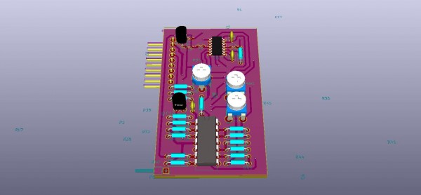

PostPosted: Sun Feb 12, 2017 3:49 pm    Post subject: expo source Reply with quote  Mark this post and the followings unread
Hello people,
If anyone is interested I'm preparing a layout for a 3046 heater type expo current source PCB.
The design is based on the system100 vco. Adaptation from ua726 to 3046 is based on frequency central's implementation as well as the doepfer vco.
The intent is to make it easier to breadboard/prototype future VCO designs.
See attachment for schematic and 3d drawing of my PCB layout.
This is a work in progress! I need to fill out all the values still.
Comments welcome!

try again with the schemo upload
heated3046expo_source_schemo.pdf
 Filename:  heated3046expo_source_schemo.pdf
 Filesize:  77.94 KB
 Downloaded:  497 Time(s)

PostPosted: Sun Feb 12, 2017 4:00 pm    Post subject: Reply with quote  Mark this post and the followings unread
Would this be a uA726 replacement?
(I have a defect VCO using that chip and suspect the chip to be gone, although I did not actually check that)
mrand
Joined: Mar 30, 2014
Posts: 56
Location: Yukon and London Ontario
PostPosted: Sun Feb 12, 2017 4:08 pm    Post subject: Reply with quote  Mark this post and the followings unread
not quite because mine includes the cv input mixer/summer as well as all the heating circuitry.
There are lots of other people doing ua726 replacement PCBs though.
here for eg: http://ua726.co.uk/2016/12/18/ua726-replacer-quick-test/
