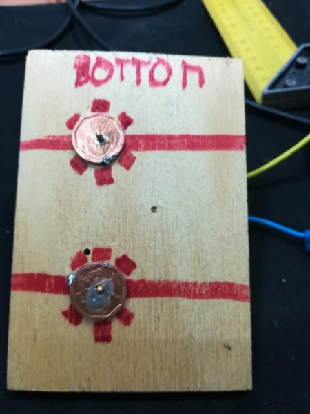

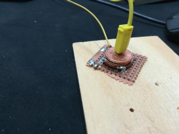

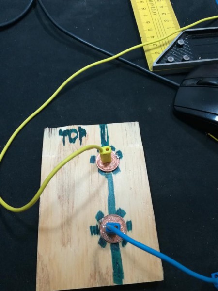

PostPosted: Thu Dec 20, 2018 3:26 am    Post subject: Reply with quote  Mark this post and the followings unread
/* two cents start */
the basic idea was to solder some coins on top of each other to get a socket (pic1)
for the matrix you now could imagine a two-sided PCB where you have solderpoints for the coins on each side, one side vertical, other side horizontal connected
if you then plug a banana plug, you have a connection, right?
i would expect that some offset disances here and there are needed
maybe the use of two PCB on top of each other to give it more strength?
/* two cents end*/
